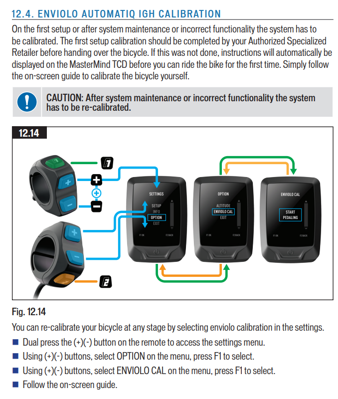

I also received a suggestion from Specialized Support that I should recalibrate the Enviolo with no instructions as how to do so. I was told that it was an option in the Mastermind control, and cannot find it. I don’t believe that Specialized support knows how to support this bike.

I also received a suggestion from Specialized Support that I should recalibrate the Enviolo with no instructions as how to do so. I was told that it was an option in the Mastermind control, and cannot find it. I don’t believe that support knows how to support this bike.
See the 2022 Vado User Manual, page 22.
There are as many as 53 occurrences of the word "Enviolo" in the manual. I'm sure everything has been explained there. (I wonder why User Manuals are written if nobody reads them...)
I have read the entire manual. There is no indication of calibration after the initial calibration when the bike is first turned on. Please indicate where instructions for recalibrating the bike are in the manual. I am not an expert on the mechanics of bikes, but I do read manuals.
Page 46. And I am not an owner of Vado 5.0 IGH.
This is a different manual than what came with the bike, but looks like Calibration is on page 46 of 51

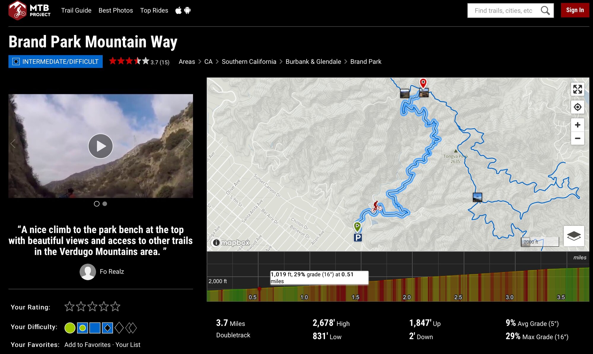

Indeed, it is-- and 7mph sounds about right. Just for the hell of it, I took a route today that had a short segment of 15% on pavement and a much longer segment of 12-14.5% on pavement.
On a 46 pound bike with a 40 nm 250 Watt motor, bike + rider = 200 pounds, the motor did not seem to struggle at all. But it was very steep. Not like, I'm gonna die steep, but steep like I'm definitely stopping and hitting the water bottle (for the longer section, anyway.) Got home with compression long-sleeve undershirt, flannel shirt, and jacket lining drenched with sweat.
for a quick confirmation of a route, the rideWithGPS route planner shows a nice cross section of the terrain and you can see % slope along the ride.
Great tool, thanks so much for that! I will be using this a LOT.
However, I was confused at first, because this is giving me WAY lower grade readings than MTB project.
But I'm so glad you posted this, because it helped me finally figure out why different tools appear to give such different estimates of grade-- and this might explain why Jo could be seeing numbers close to 30% for this hill if he/she/they used an online tool to check. If the tool calculates based on 100 or 200 foot segments, you could get values that were twice as high. MTB project breaks trails down into teeny, tiny segments, so you can get some really high readings depending on where your cursor is placed on the map.
For example, Brand Park Motorway is the intermediate/advanced, and-- as a Senior Special Needs Extreme Athlete (😜)-- the hairiest trail I've ever taken. RideWithGPS puts the max grade at about 14%-- but MTB project lists the max grade as 29% because it's looking at shorter segments-- 1/100th of a mile. So for about 52 feet, this particular trail does appear to be 29%. You can do a lot of crazy things for 50 feet that you couldn't do for 100, 200, or 500.
yep! grade is definitely a bit complicated. however, for the case of paved roads, they tend not to undulate as wildly in cross section as trails do. i'd take any online reporting of the grades of trails with an even huger grain of salt, unless you have access to the underlying topo data that's being used. i'd bet in many cases it's USGS DEM models from a decade back, which are pretty low "resolution" and certainly not the same as a topographic survey. for reasonably sized paved roads though, pretty good data.

After recalibrating the bike, the hill was a little better. I was able to get up the hill at 7mph and the motor did not waver. However, that equals the power of a regular 2020 Vado 3. I still am hoping for more support from the Vado 5 even if it is an IGH. The rest of my 13 mile ride was definitely better after the recalibration. My new Vado 5 IGH handled the smaller hills like a dream. I do love the bike.
