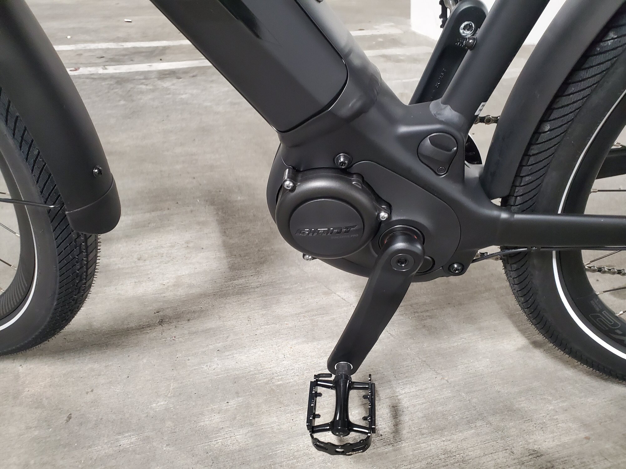

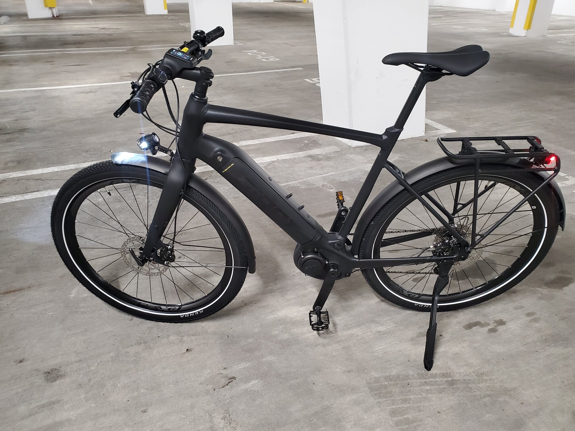

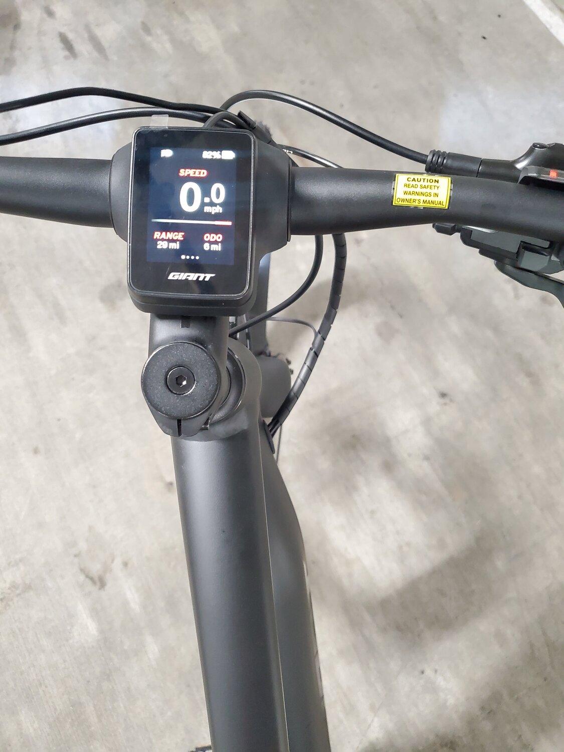

As a point of comparison, I picked up a 2022 Giant Fast Road E+, I think its a 2022, but could be a re-distributed 2021 (https://www.giant-bicycles.com/us/fastroad-eplus-ex-pro-28mph-2022 they took the link down for the '22s) to see how the ride compared to the newer tech in the Vado.. and so far, it just fits my riding style better. The Yamaha motor seems about on par with the Bosch CX in that it has good low-end torque, but also pretty good top-end speed. The bike doesn't pedal as smoothly or as quietly as the IGH, but it's on par with what you get from most standard derailleur ebikes, although theres a loud pitched whine when pedaling from the rear gears when not pedaling.. not sure what it is. ive heard it on other bikes before, just not as loud. A hill that I usually take at 10mph on the Allant +8, dropped to around 7 on the IGH, and is back to around 10-12 on the Giant. Could be due to a number of factors though. I haven't delved into the software much, but from what ive read, most people use a Garmin app to control settings. Oddly, even at about 10+ pounds heavier, the IGH pedals better off of the motor.
So I have to say, after a number of rides this week on the FastRoad E.. this bike is PHENOMENAL.. its probably the best commuter pedal-assist bike I've ridden (havent ridden a Vado SL though), the FastRoad E is the first bike that feels like its a super-powered normal bike.. it just rides sooooo well. There's 6 different power levels (eco, tour, active, sport, power), but the best of them all is auto which accurately measures the cadence you're pedaling at and delivers exactly the level of assist you need with zero delay. It's something I think the IGH could actually approve upon in their "auto" mode. Mileage in auto seems be around 55-60 estimated. The bike also rides really well off motor (off mode vs powered off), I was able to get it to 15ish mph with normal effort and 18-20 with effort.
Its rigid everywhere, so could use a redshift stem and seatpost and probably ergo grips; its an 11-36t, 10speed(42t chainring), so no idea how this will do for climbs, and is probable too bulky to serve as a gravel bike of any sort, but for general commuting its fantastic.

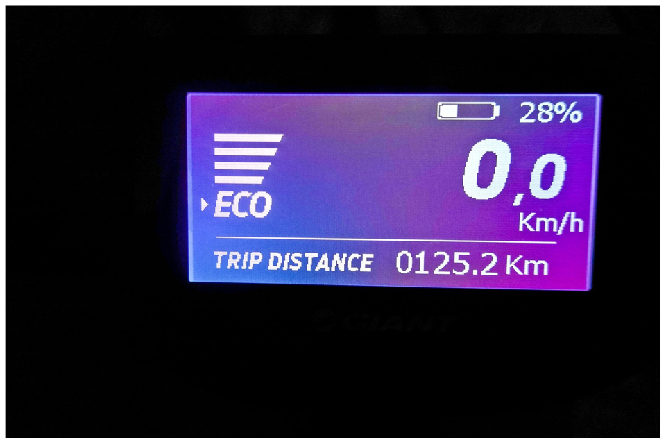

@Gee_Whiz: It is all about how strong you are. Here's a story.
We went together with brother on a 75 mile ride in September 2020 (he rode the Giant). He was using Eco off-road, and often rode in OFF mode on asphalt downwind. The Trance E+ was equipped with the 625 Wh battery, and a spare (500 Wh) was carried in a pannier. At some point of the ride I suggested that brother could swap his battery. And it turned out he had forgotten taking the battery key with him! So he had to take care of himself...
It actually was 120 km but he returned with 28% left! It was because of his tremendous own input in the ride!
