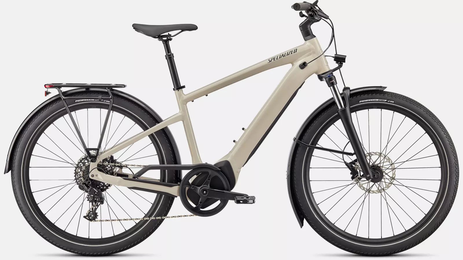

According to my experience, the Vado 4.0 is the best value for money. In any case of the trouble with climbing (as it is the mid performance Specialized/Brose motor: stronger than the one in the 3.0 but weaker than it is in the 5.0), you could always replace the chainring with a 38T one and shorten the chain. IGH is far less efficient on the climbs than the chain system is. If you do not mind some maintenance work, I strongly recommend taking the 4.0. Note: The current Vado 4.0 comes with the 48T chainring. Going to a 38T will make the Vado a real mountain goat on roads!
Regarding the version, you should absolutely look for the model with the Mastermind display that was first introduced in (I think) 2022 Specialized commuter e-bikes.
That is, it should look like this:

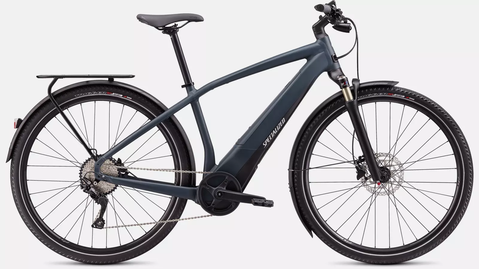

But not like this one:
This one is a little bit obsolete now (the pre Mastermind, or Gen 1). This design is 6 years old now!
I understand the pre-Mastermind Vado is cheaper but why go with something you might have a trouble with getting a spare battery in the future?

Indeed, I was only looking at the newer models (2022/2023) as on the 1st picture. My concern was more related to a potential refresh of those bikes in the coming months, since the current model is already 2 years old.
Then I'll probably go fo the 4.0 now as the price seems fair. The 3.0 with IGH would be too weak for the hills, especially when carrying my son in a childs seat (forgot to mention this...)
