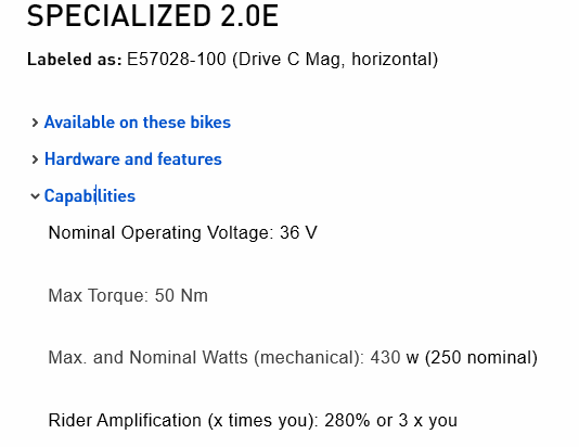

We settled on the Turbo Tero 3.0 and put down a deposit but haven't picked it up yet. It had a smaller motor than I wanted but my daughter has a Scott bike with the same 50 Nm and says it's fine, and the dealer assured me we would have no problem making it up a particular large hill nearby. We did a little test drive and liked it enough to put down a deposit. However, I was really tempted by the Tero X 4.0's full suspension. Everyone assures us we don't need it, but boy does it soak up the bumps nicely. But I didn't want to pay that much more.

I don't remember the multiplier for the Tero 3.0, it might be 4x.
It's rather 2.8x.
