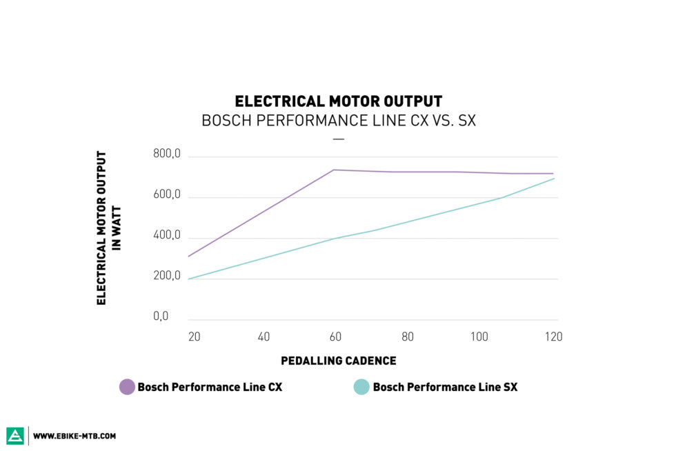

@Stefan Mikes Bosch specifies max output as 600w mechanical. That seems to match what emtb mag found in their motor roundup tests.
(Note this is the CX, which we can assume is basically the same drive unit as the Speed motor Bob has aside from assist maps which is irrelevant here since the tests were conducted at full power)
We also tested the motor in the lab at the renowned Velotech institute, where we found out the following: in Turbo mode, the rider only has to produce between 170 and 200 Watts under their own steam (depending on cadence) for the motor to reach its 600 Watt peak power. However, if you pedal harder, the motor doesn’t produce any more power above this point. Coincidentally, this corresponds roughly to the 340 % maximum pedal assistance stated by Bosch. In purely mathematical terms, when producing 176 watts with your legs, the motor multiplies your effort by 3.4 times, which adds up to a total of 600 watts.
Yeah, I wished they posted the actual data, but you can understand that they probably would never get access to review units again if they published a full table of every motor's actual output.
They did post this where you can see the electrical output was measured at approx 740w(my eyeball guess) which would fit with 600w mechanical.
@Watana Bob the cadence you like to ride at might impact which drive unit suits you better. If you ride down in the 60-70rpm range you wouldn't see much difference between the SX and the SL1.2 in terms of power.
Thanks BlackHand, yes i typically pedal with a cadence of 70. That is an interesting graph that you showed, I dont think that my Performance Line Speed motor has such a steep line to max wattage.
That graph is with the bikes in Turbo mode so they can find where the bikes max out their power. Since you don't use turbo (nor do I) you're not bumping up against the power ceiling like that.
