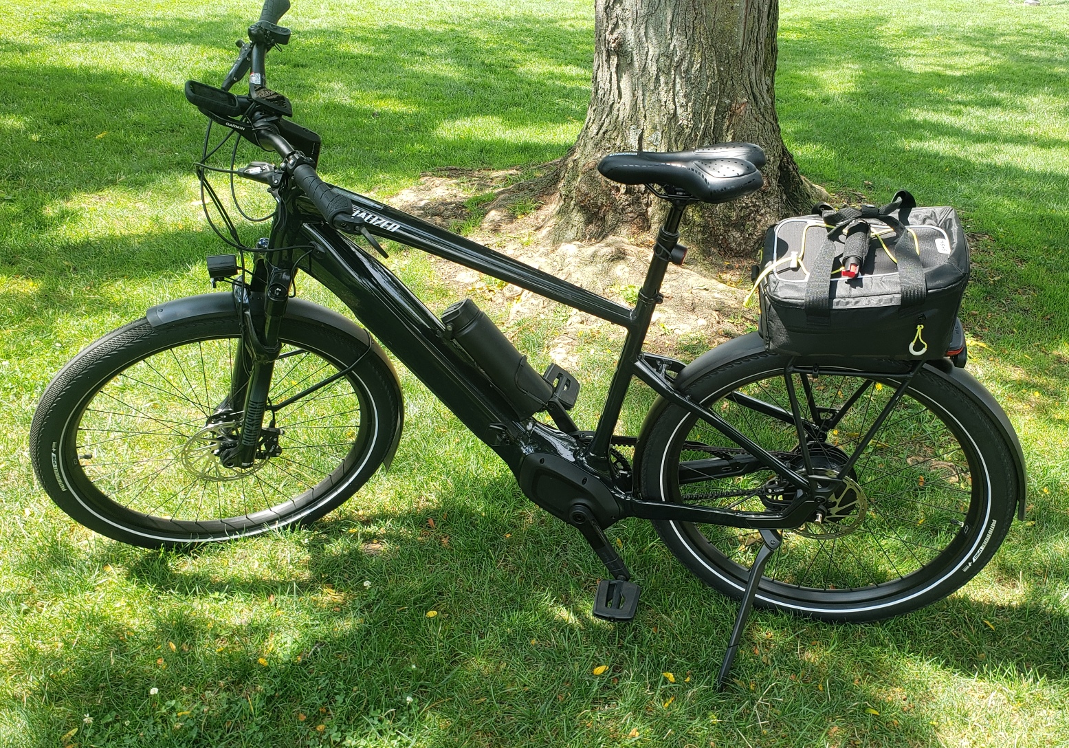

Update on the Vado 5 IGH:
After exchanging a series of emails with Specialized, I've decided to entrust my bike to a different Local Bike Shop (LBS) with a more extensive background in working on the IGH system. Despite numerous attempts at calibration, I've been unable to achieve proper engagement of the Automatiq while pedaling downhill. There's an undeniable sense of something being amiss, and I suspect that the initial shop's lack of experience with the Vado 5 IGH may have contributed to this issue. The gear shifts never quite align as desired, even during uphill climbs.

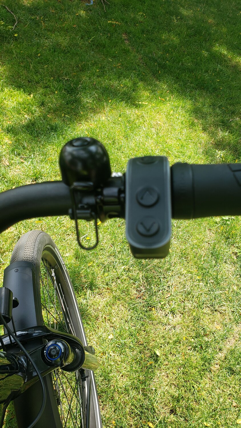

On a brighter note, the Cliq Pro controller has finally made its arrival, and it has proven to be quite impressive. While the process of manually engaging it before each ride can be a bit cumbersome, the ability to switch gears is a welcomed improvement. Today marked my fourth ride, and after the third outing yielded only an average range within ECO mode (35/35), I decided to make an adjustment. Opting for a 25/25 ECO mode setting has proved to be the perfect balance for me. Following a 52-mile ride entirely in Eco mode, I returned home with a notable 49% battery charge remaining—impressively outperforming my previous 2022 Vado 4.
Turning my attention back to the Cliq Pro, most of the shifts were seamless throughout the ride. However, on a few occasions, it felt as though the connection was momentarily disrupted. I intend to delve deeper into this behavior, although overall, the gear changes were notably smooth.
The Vado 5, with its buttery-smooth ride and whisper-quiet belt drivetrain, presents an enticing package. Personally, I find this bike to be particularly well-suited for commuters. The absence of concerns about chain slap on clothing or constant derailleur adjustments due to misalignment is a welcome respite from maintenance issues often faced by those who opt for traditional setups. Gradually, I find myself warming up to the IGH system, and if the new LBS can address the erratic behavior of the Automatiq feature, I'm inclined to keep this bike.
Lastly, my preference veers away from the Pathfinder tires. They possess a certain "mushy" quality and produce an audible noise during cornering. In contrast, I've always favored the Super Moto X's, and I've made arrangements to have them installed later this week.
