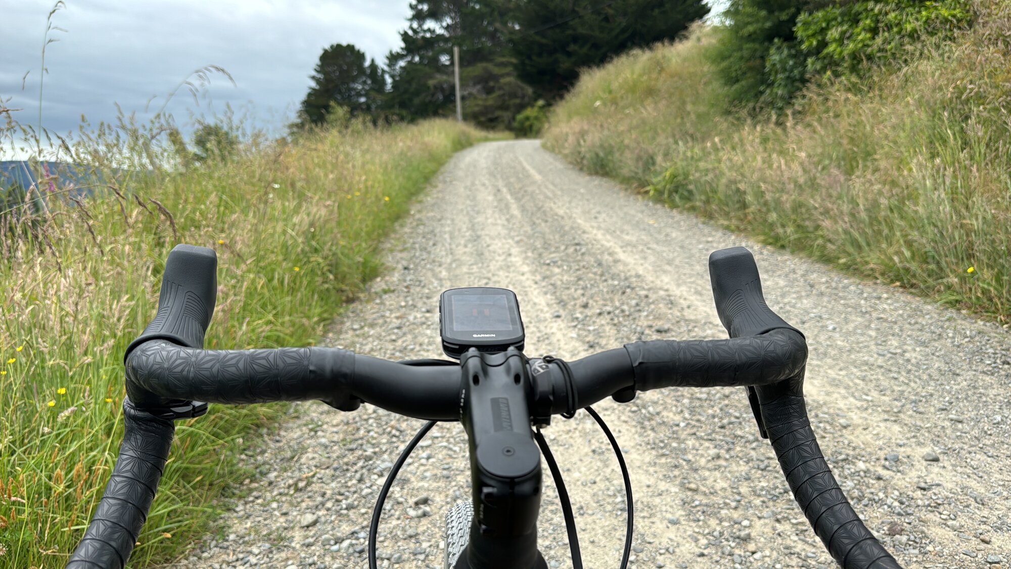

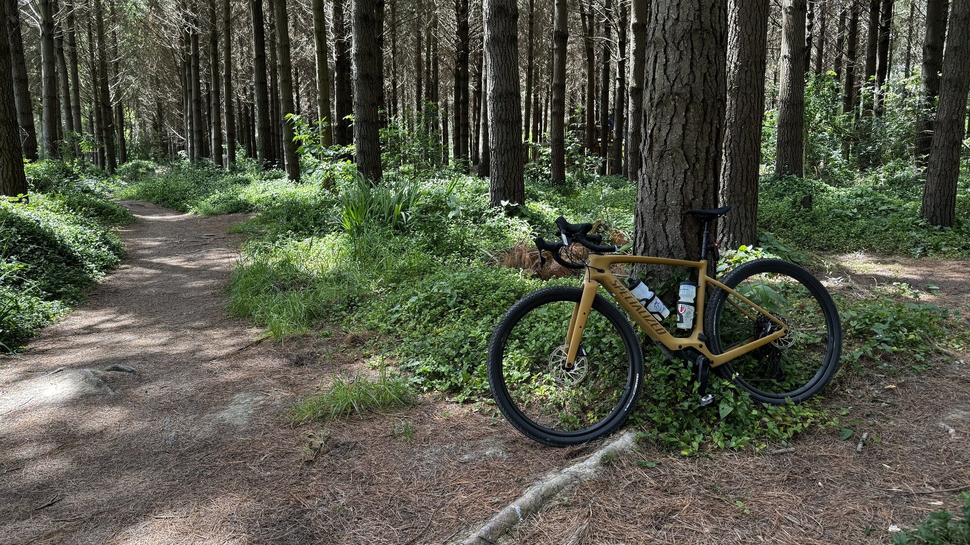

seems like another reason the creo 2 isnt really an endurance road bike. it’s a gravel bike in almost every way. great for those looking for an e gravel bike :)
It has excelled for me this last few weeks for exactly that.

Certainly not the S-Works, Paul! :D
