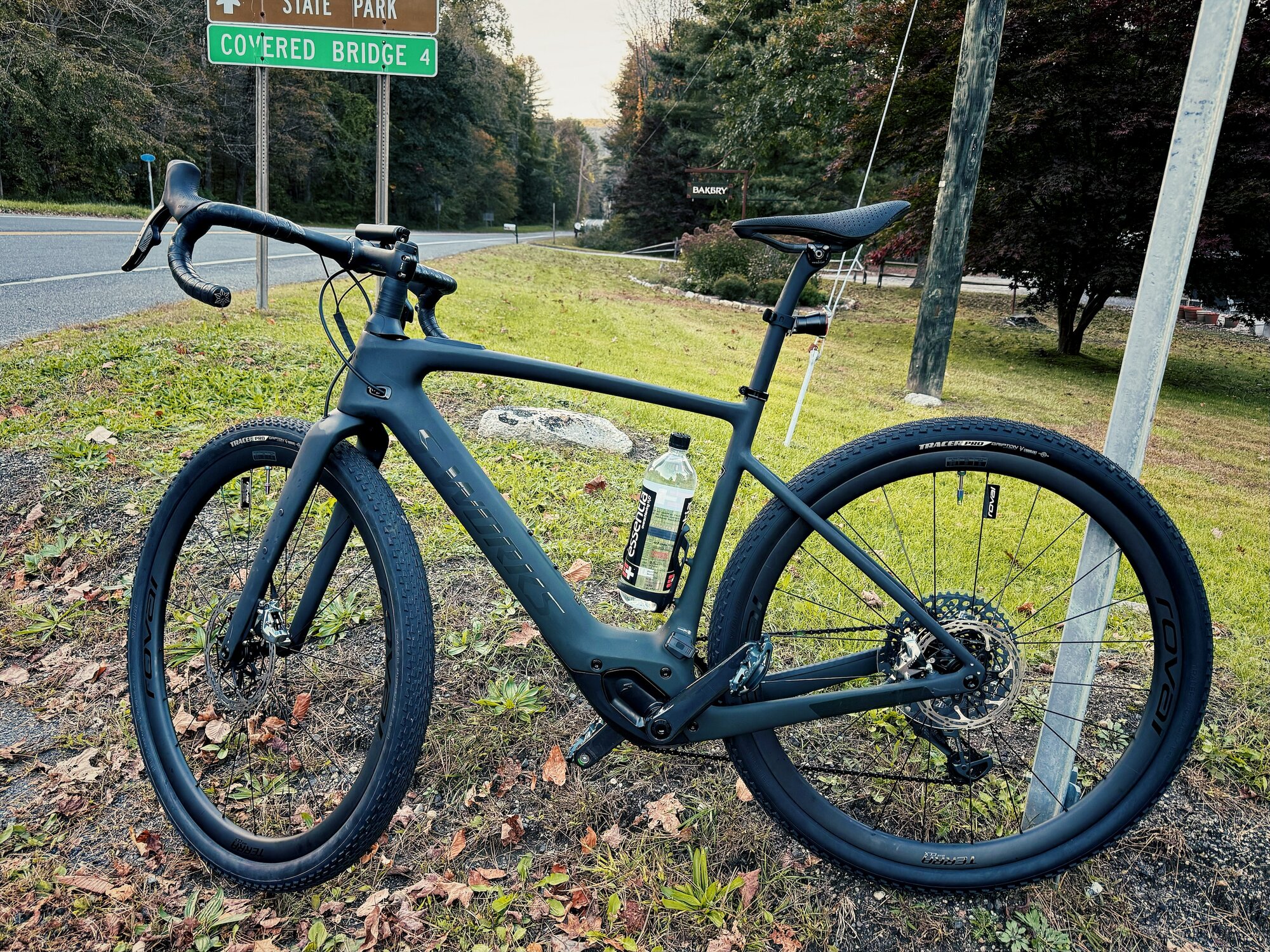

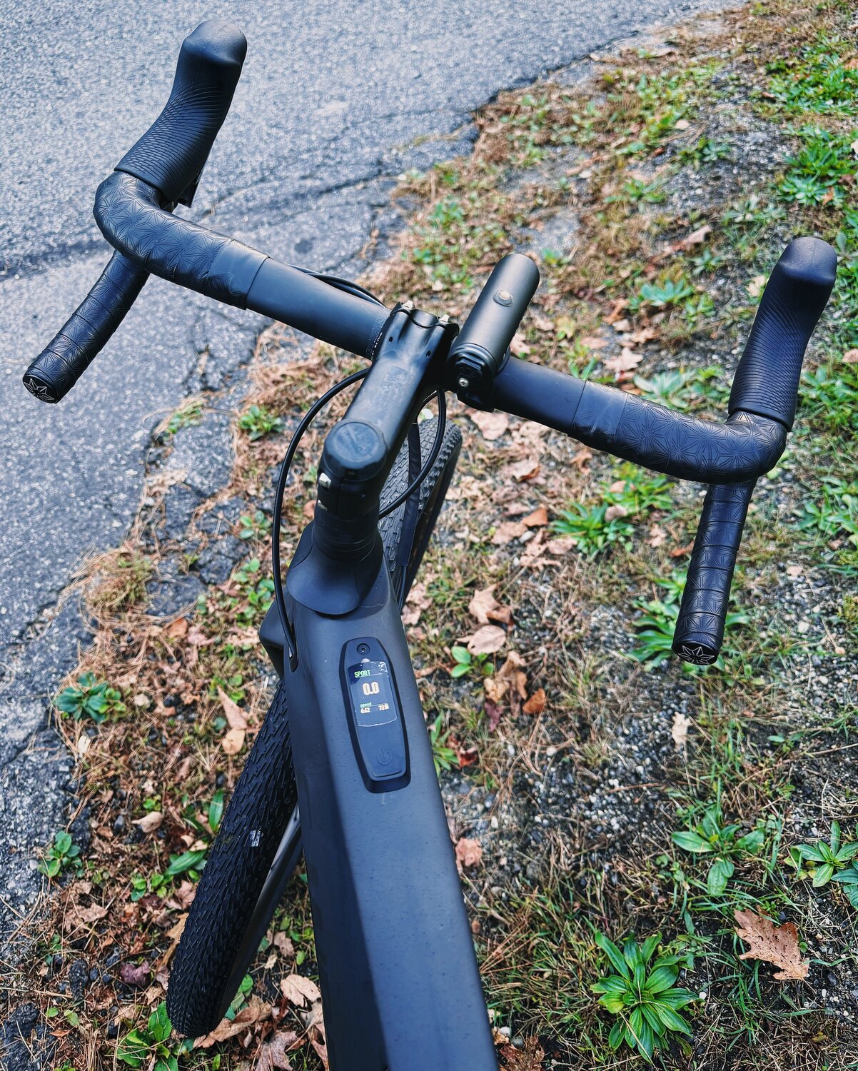

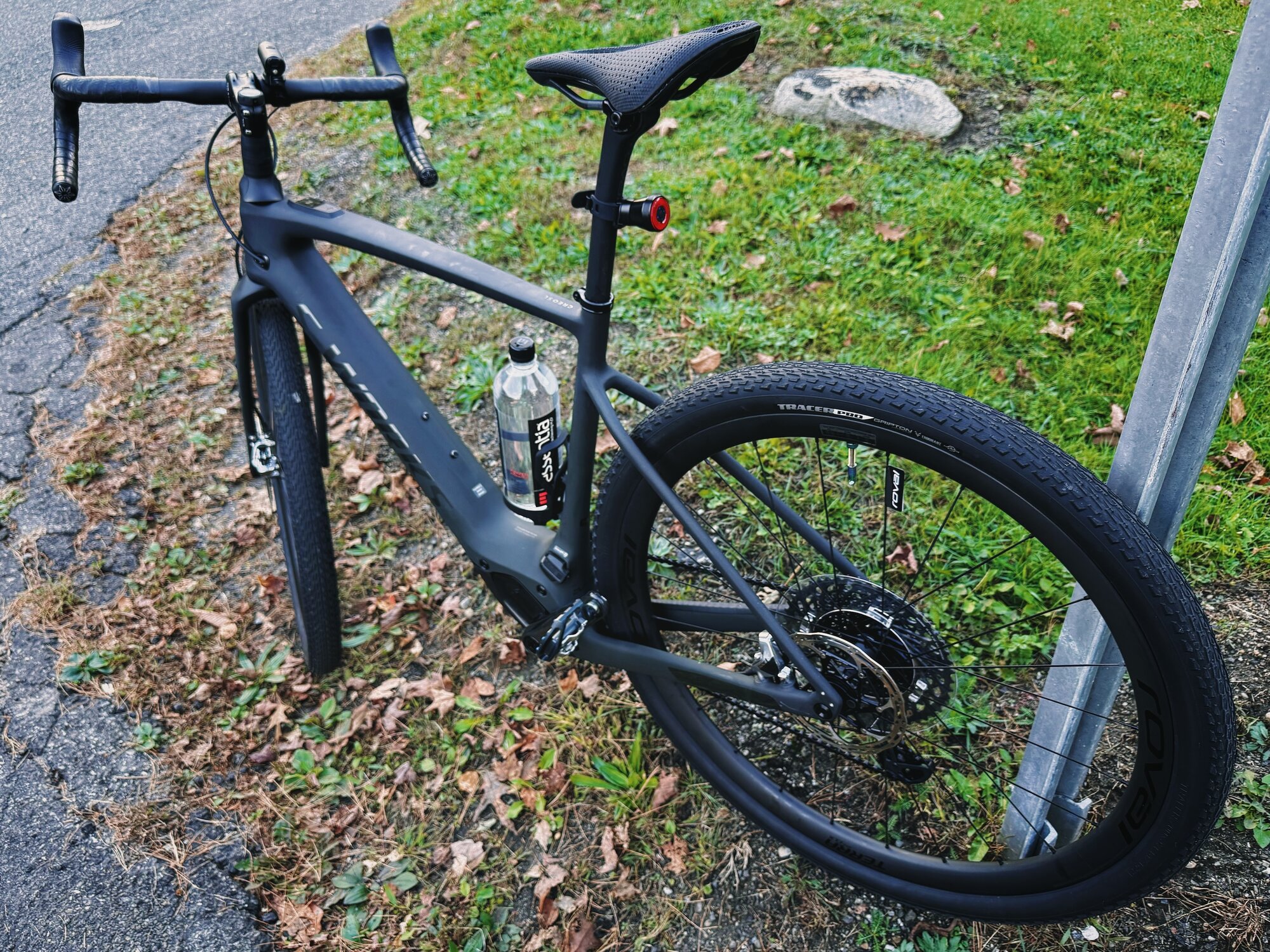

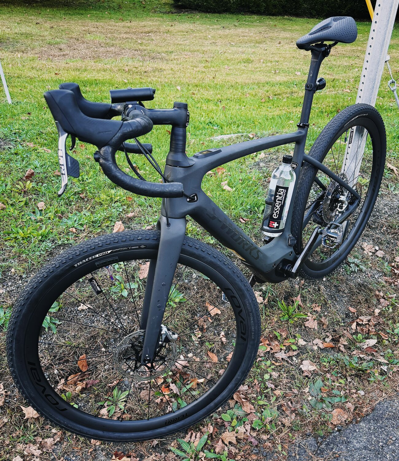

Photos from today’s ride on the creo 2. Can you tell from the look on my face how much I’m loving it?? 🥰🥰🥰
