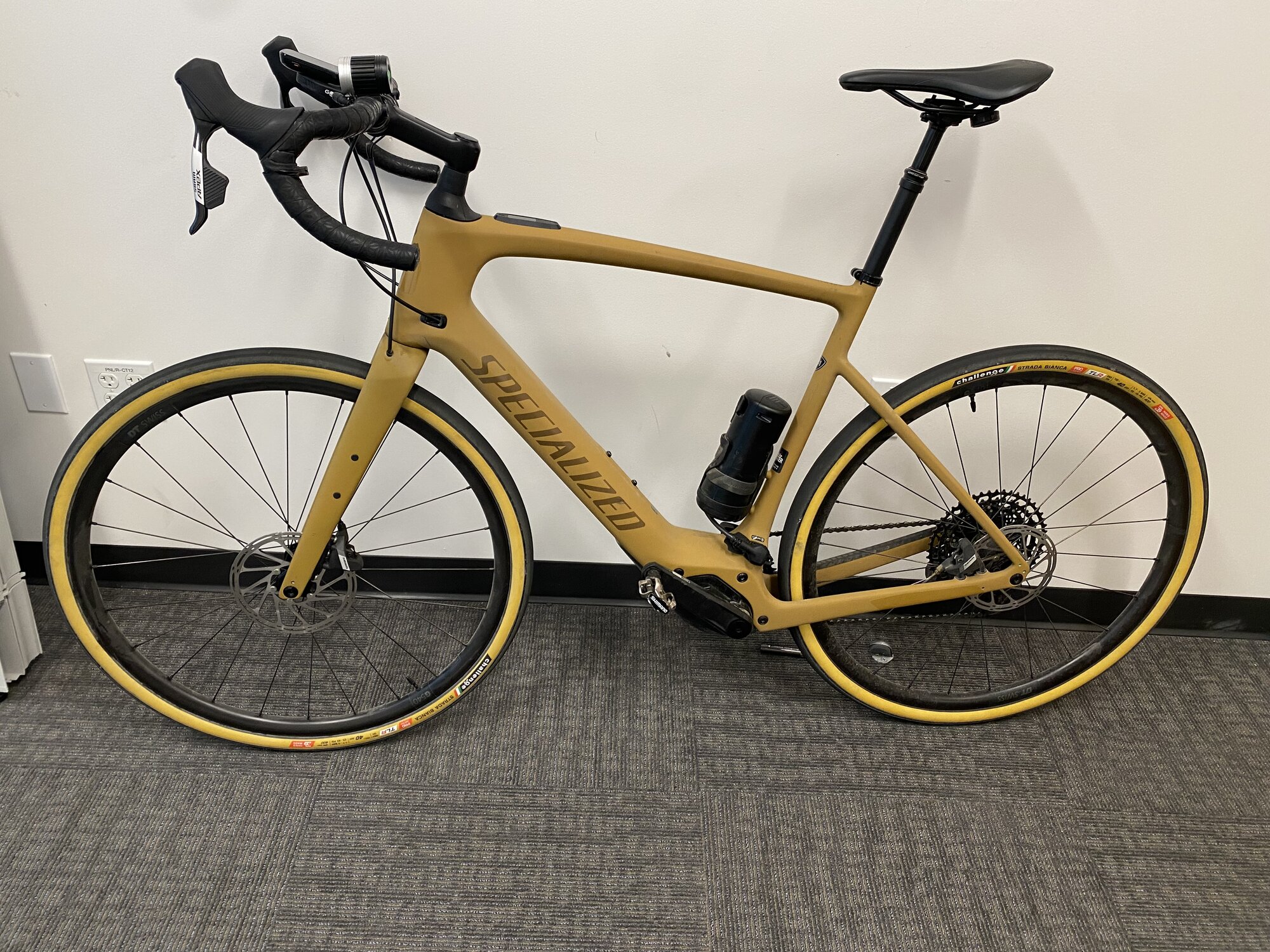

I went with the Mondo T2/T5 35 mm -- I put the stock ones back on when I'm doing gravel specific rides, and then leave these on 90% of the time.
