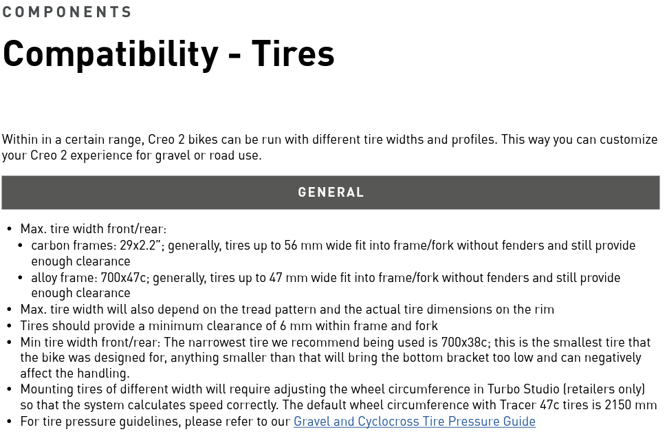

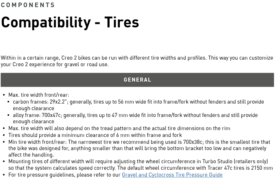

Specialized recommends no less than 700x38 tires, so whether it'd pass a road bike depends on what tire size you'd like to use...
I also find it interesting they reference an alloy framed Creo 2 ...

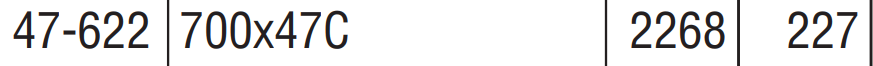

Because the standard charts read:
The same Specialized uses the wheel circumference of 2180 mm for far skinnier 700x38c tyres...

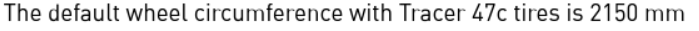

2150 seems to be the default wheel circumference setting in the TCU or motor or wherever it lives.
My 2022 Creo E5 came with 700x28c tires and a 2150mm Wheel Circumference setting. When I switched to 42mm tires I measured circumference and had my LBS change the figure since only dealers can do so.
Specialized is known to make weird default wheel circumference setting in their e-bikes. Don't worry: Giant does the same :)
It is good we can ask the dealer for the change. Anyway, the 2150 mm for Creo 2 is either a very wrong default setting, or it is a typing mistake in the web page because I'd say the 700x47c tyre might have the wheel circumference of 2250 mm.

What's the logic behind the (potential) alloy frame allowing maximum sized tyres that are smaller than for the carbon frame? Smaller frame?
