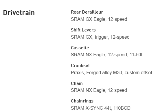

I suspect you would be ok with either the Vado SL or Creo 2 SL. Note that the Vado 4.0 has an 11-42 Cassette while the 5.0 and Creo have a 50 tooth low. There is a short hill nearby that has a couple of 12-14% sections on it. I could handle it on my 4.0 Vado SL with an 11-36 casette as well as my Creo 2 with its 11-50 cassette. With the Creo's 1.2 motor the 50 tooth and/or turbo is overkill.
The spec of the current Vado SL 5.0 EQ that @Jeremy McCreary has took for a long test is actually this one.
