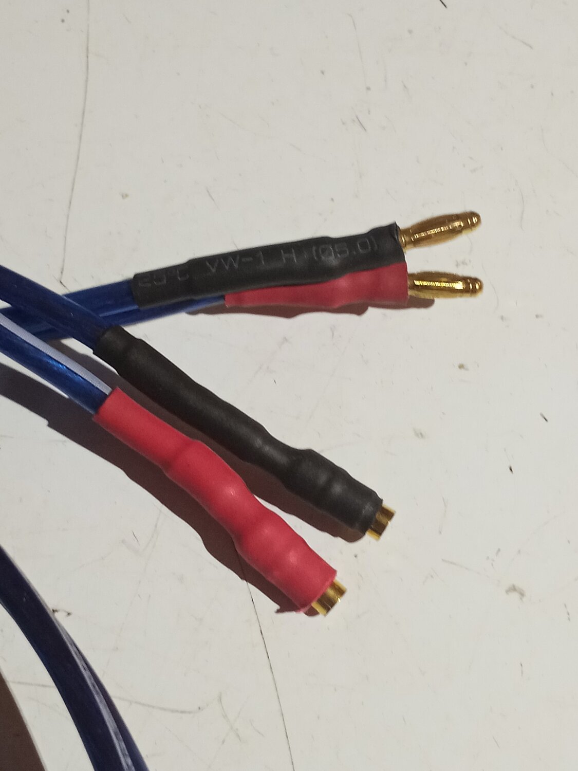

I managed to get this battery connector cable soldered up after some practice,..

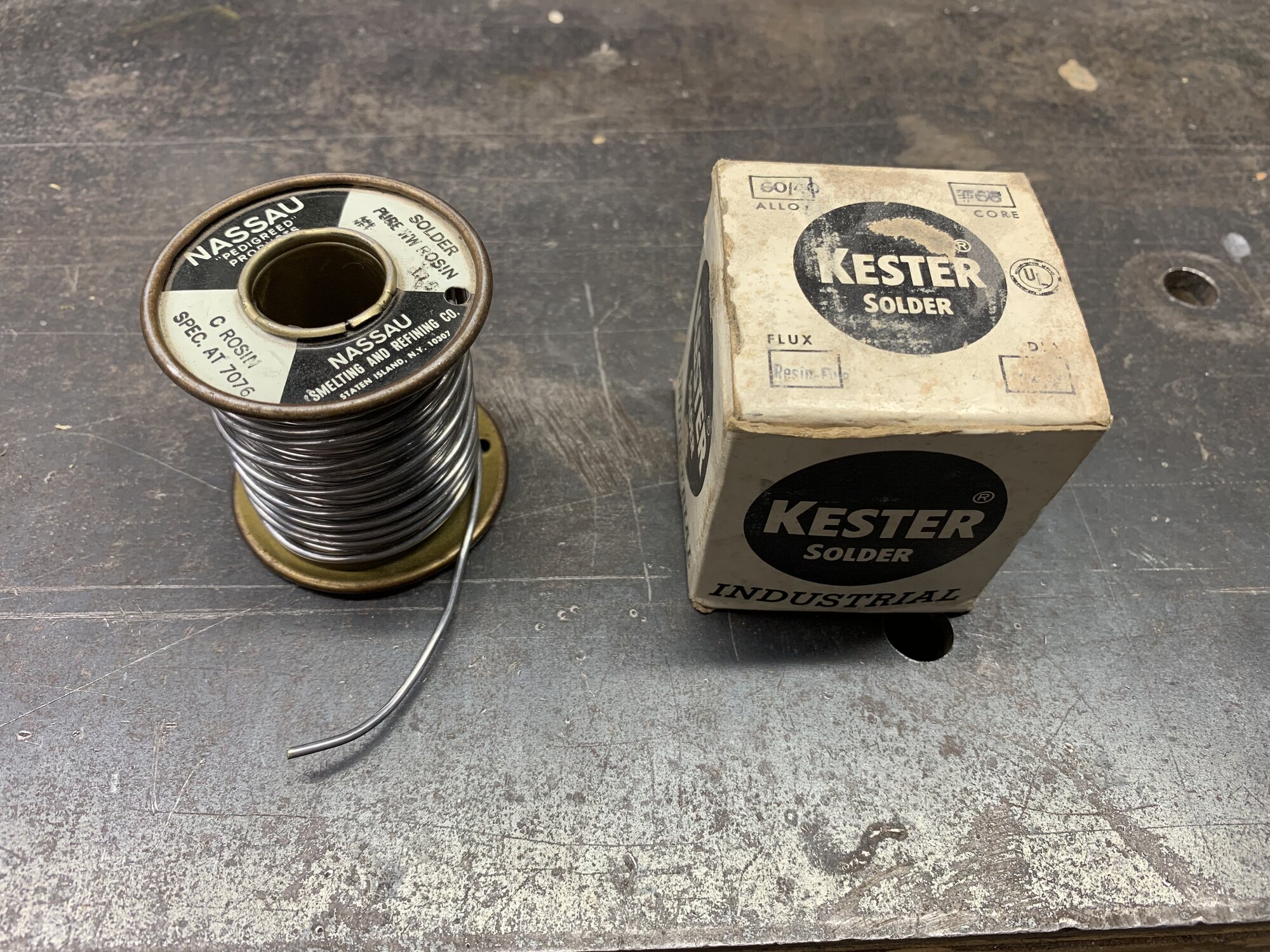

I laid in a large supply years ago before the ban. I sold a lot of it on eBay for a ridiculous price but now I wish I'd held on to it. I'm down to my last 2 spools:
Hopefully, it will last and I won't have to learn to use the lead free stuff. :(

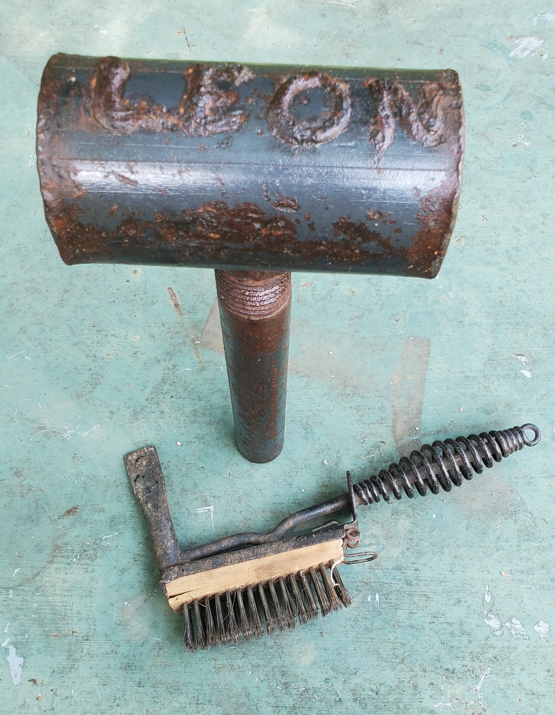

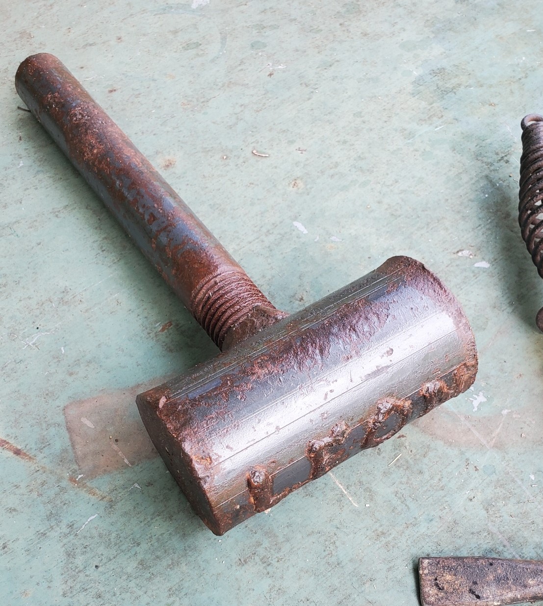

Here is another tool that helps, it is very old, but still works.
