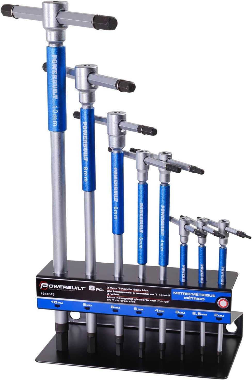

I got this set of spinning t handle wrenches. I wanted the park tool ones but they are almost 150.00 and I dont need them a lot. but there are a few jobs I really need them like tightening and loosening the bottom bracket bolts so I can rotate. the bottom bracket on the tandem to tight up the chain. dont need the 8 and the 10 really. https://www.amazon.com/gp/product/B074PXK2BN/ref=ppx_yo_dt_b_asin_title_o03_s00?ie=UTF8&psc=1
My neighbor has the same kind of thing to use on his tandem.

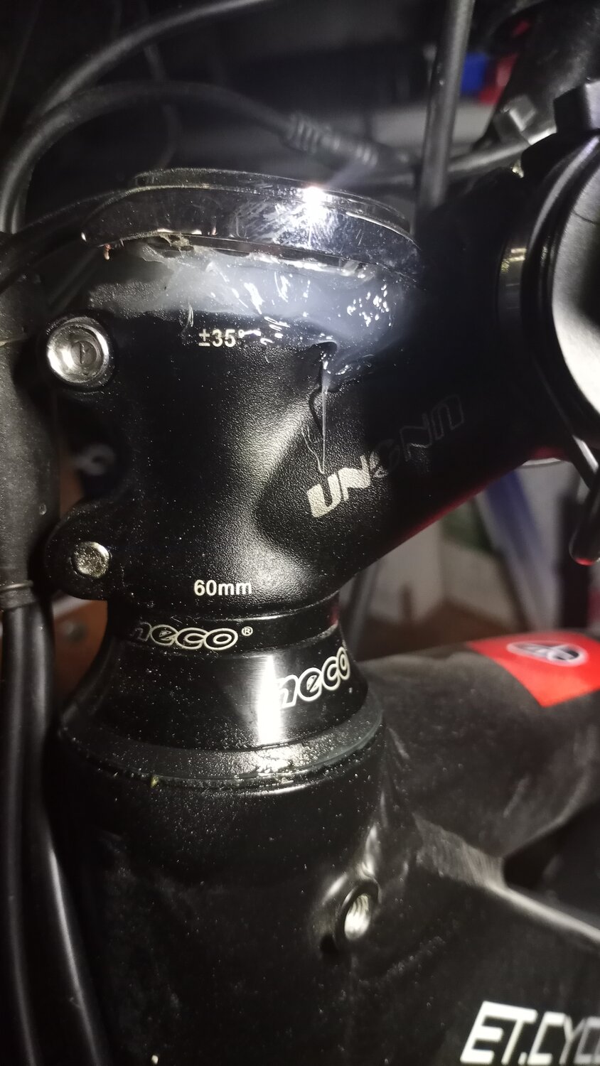

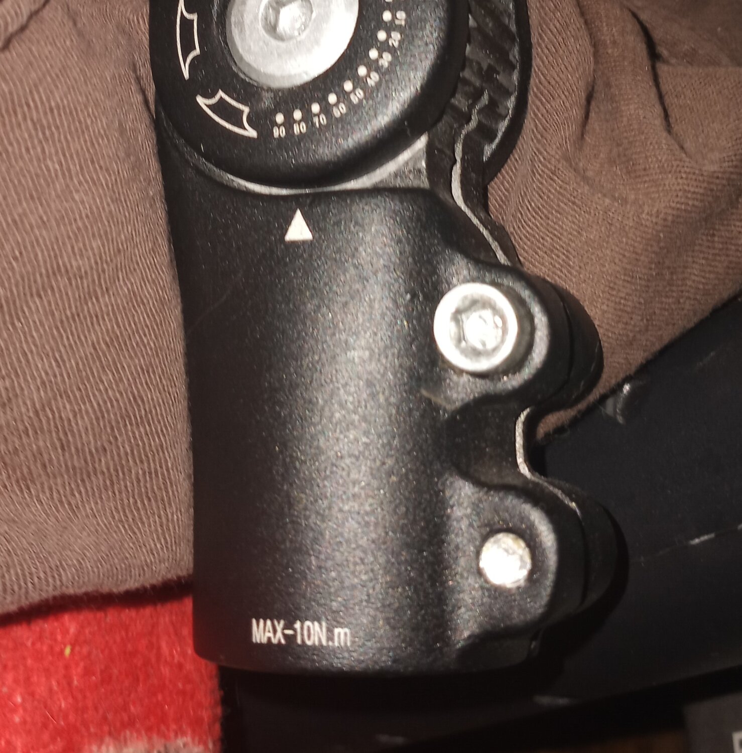

What?!
A photo, please. Stem is 5 Nm...
My old stem is 10 N.m
My new stem has a 60 mm rise.
It kinda looks like 60 nm
55 Nm is a very high torque usually applied to the crankset to fasten it to the mid-drive motor axle or to fasten the cassette (40 Nm) to the rear hub.
I happen to have owned an e-bike similar to Dave's and know the A-HEAD stems only require 5 Nm. I hope Dave hasn't pulled his stem bolt thread yet...

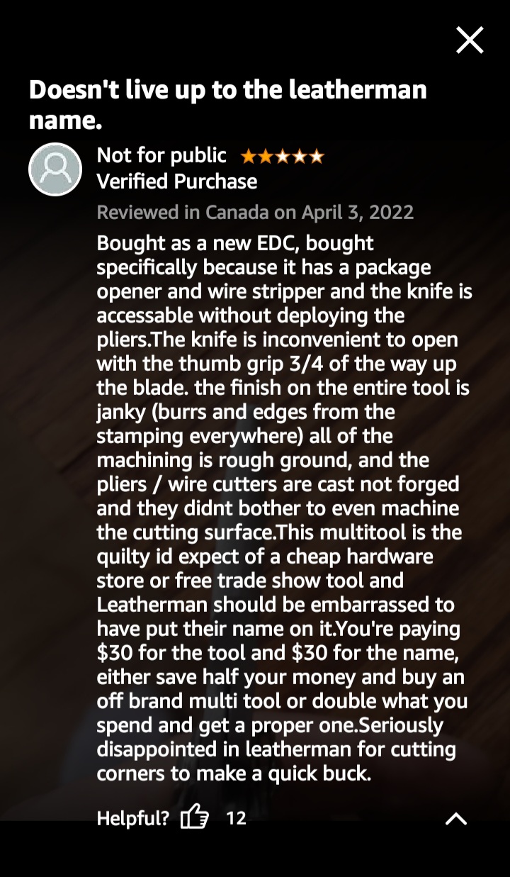

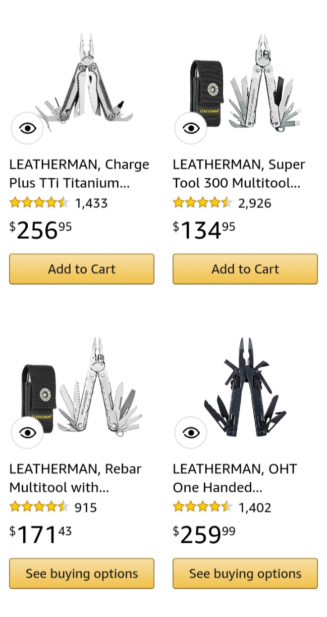

I know Leatherman is good quality but I'm not spending that kinda money,..

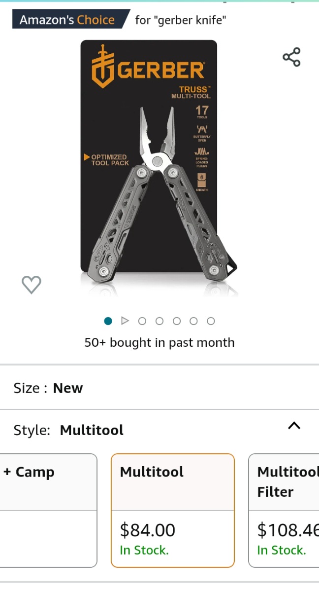

Gerber is good too, but still too rich for me,..
Looks like Leatherman has gone downhill, just like Irwin tools and Visegrip.
Same deal with Gerber.
