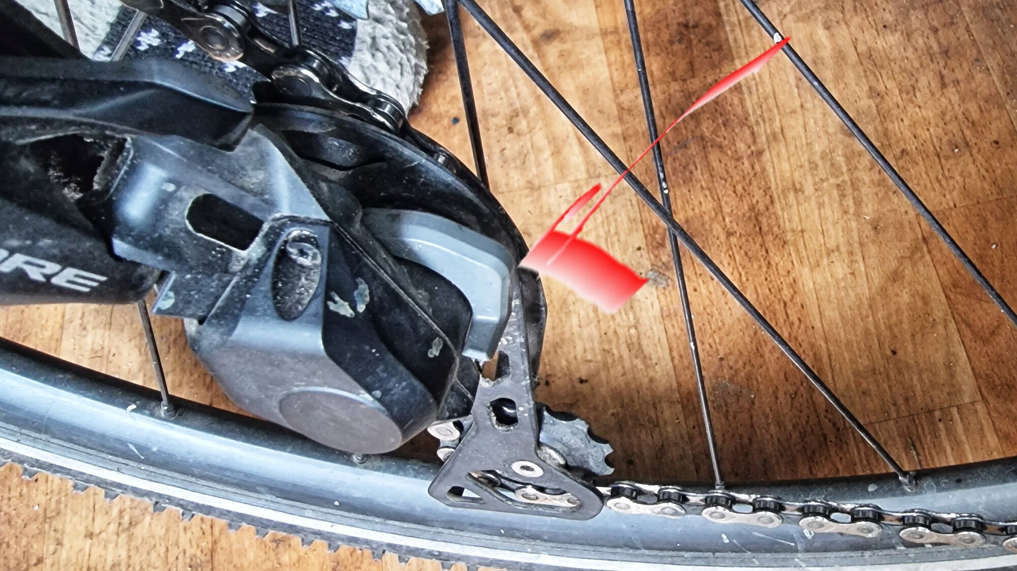

While getting my gashed tire and tube replaced at the local shop I looked at a variety of their night lights. But decided, really, when are you going to ride at night again! So I stopped dreaming and headed to the repair and the tire was done. Little did I know the next morning it would take me an hour to get the damn wheel back into the rear derailleur. I cursed mightly. I watched another video. My derailleur would not yield to the gears and disc brakes.

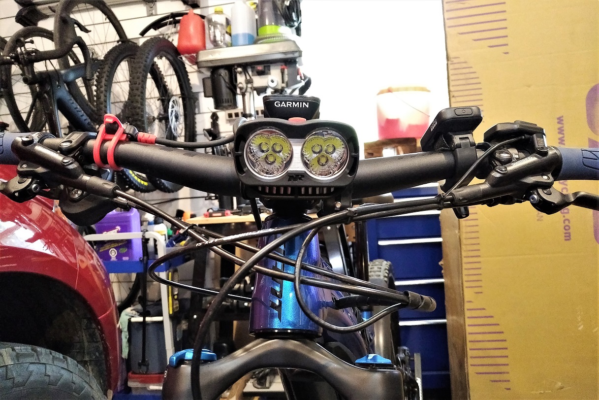

I have to admit that the light system on the Trance might be overkill for most but I won’t compromise when riding the trails at night. I tend to ride all year round and winter/spring night riding offers up different challenges when having a clear view of the trail becomes even more paramount.
It’s much easier removing the wheel if you pre-shift to the smallest cog on your cassette. Release the clutch mechanism on your rear derailleur and then pull back and down on the pulley/tensioner assembly. Re-installing the wheel is the reverse procedure with the chain resting on top of the small cog. Easier said than done I know and it takes a bit of practice to get it right. Don't forget to re-engage the clutch when your done.
Did you release the clutch?
You and Stefan mentioned the CLUTCH and I have to admit: CLUTCH? I'm not familiar with a clutch on my bikes!!!!
Creo, so where's the clutch and what do I release???? Yesterday, I recalled reading about them but the video I reviewed did not help me locate it.

Many derailleurs do not have a clutch. If yours does it is a small lever on the device and if you can see thru any dirt ( wipe it off) there is an 'off' and an 'on' label. The small lever only moves like an inch or less.
The on position on an equipped derailleur just increases tension on the chain. Useful if riding on bumpy ground.

Look on top of your rear derailleur and you will see usually a gray lever. Shimano. Don’t know about SRAM.

My Creo: Rear DerailleurShimano RX812 GX, Shadow Plus, 11-speed
I will look.
FOUND IT. Okay, chalk it up to the OLD guy who has been pedaling about 60+ years and never dealt with a clutch (outside of a car and even that's been a while now) on a bike! The switch certainly did not have any resistance as I moved it. Did not futz with the derailleur - too early for grease. A BELT drive next time ;):eek:
Shadow Plus means the clutch. The little gray piece shall be pushed forward to release. Then you will be able to move the derailleur cage forward, and thus you can install the wheel.
The clutch in the released (unlocked, off) position allows moving the derailleur cage forward.

One can also adjust the tension of the clutch as shown in the video below. If your Creo has an XT derailleur as in my case, it’s a simple matter of turning the Allen screw on the bottom of the housing.

I guess, now after the fact, I am surprised I was able to even get the wheel re-seated. A second set of hands might have helped. But I was trying to force the derailleur out and back and it was fighting me the entire time as I was trying to thread the wheel into place. Live and learn.
Also make sure before leaving the house that the Through-axle can be moved and loosened by a mere human being. I guess if I had been able to remove the through-axle, I would have had to create a boot/patch for the tire gash. And with Covid, I no longer carry any cash (dollar bills)!!!!
What is problematic with removing the thru-axle?! Lovely idea: it makes the rotor always precisely get between the brake pads without the need for adjusting the disc brakes. Also making the bike laterally stiffer.
Note: The wheel replacement is easier with the bike upside down. And as everything else, it requires practice.
My rear through-axle was tightened by a super strong giant and would not yield to firm human efforts to loosen it. I finally had to zetz it with a heavy duty rubber mallet three times.
