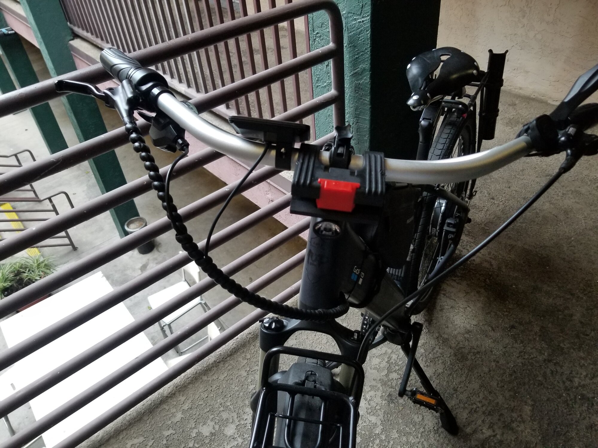

Not so long back I added Jones H bars
https://jonesbikes.com/jones-h-bar-butted-loop-aluminum/

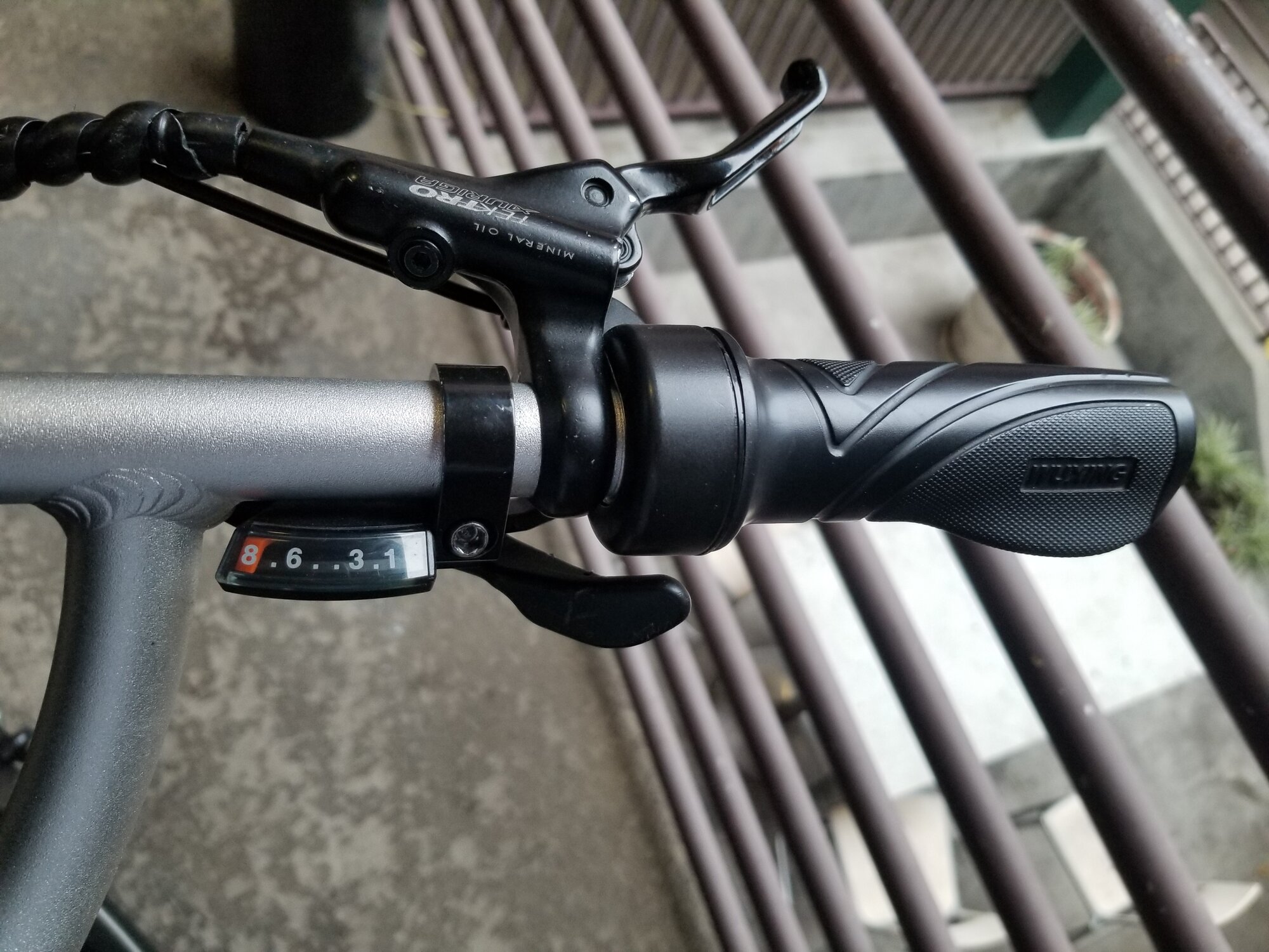

Enough straight line space in grip section to accommodate my (R side) twist-grip throttle, shifter and brake lever at good angles -- and by moving the shifter inboard just that additional little bit more than the stock bars allowed, my thumb knuckle no longer bumps into the shifter levers when turning the twist grip throttle.
Also, wiring loom is improved with the display; quick release for detachable basket and lights out front - proper - out of the way.
I prefer display close to center. You want a cleaner loom, move right, close to shifter and run both lines together as one.

Level with the saddle is 'correct' (for a touring bike) but they feel so perfect up higher on this bike. More upright, less hunched over. Eased my neck/ hand/ wrist pains - but that could be the general geometry not the rise. Control of the bike was enhanced a lot after adjusting the angle.
The flat rise in the less expensive ($90.00)
Jones SG Loop H-Bar (the same design, but uses straight-gauge aluminum tubing in place of the custom-butted tubing may be even better.
Jones is such a maniacal purist, he's missing his real market. These are the perfect e-bike bars.

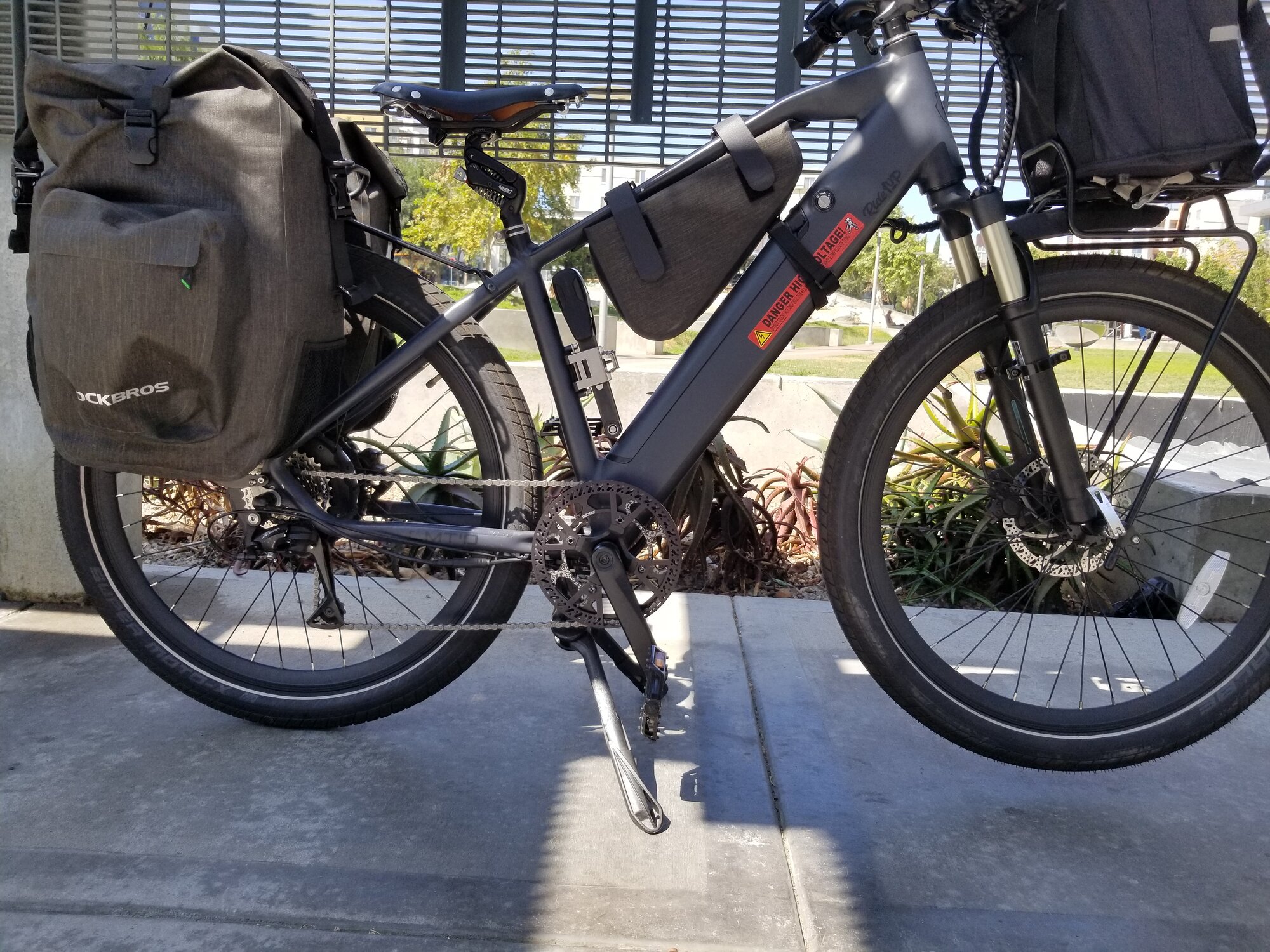

5K and my schedule say's it's time to replace the fork.
Doing my own maintenance so far, I can learn the craft, invest the money in quality parts and be sure it's right.
The Ltd has been a great performance platform with a lot of potential.
The initial price got me on the road and the utility is awesome.
