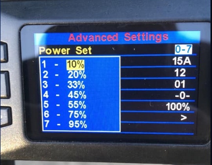

That assist level power config option is a feature of one of the bikes on one of your earlier lists - The Ride1Up 700.
https://electricbikereview.com/foru...ere-and-to-ebikes-and-i-need-some-help.35869/
Also, the Ride1Up Core-5 and 500 have that feature. The R1U LMT'D may include it as well with the next shipments that include the KD218 LCD. The LMT'D is the only one of those with torque sensor based PAS, although it's not necessarily any better for exercise, and can actually be worse - depends on the bike. You can get good exercise with the cadence based PAS systems in the other 3 R1U bikes by adjusting the power level of assist level 1 (and others) to a lower percentage, if you feel it's necessary, rather than being stuck with some unchangeable setting. That's actually the first thing that attracted me to the Ride1Up bikes - I ride a standard bike for exercise and want to continue riding for exercise without having to ride extra fast due to an overpowered PAS 1.

Thank you so much for showing me this as I didn't know R1U had this featutre, one I think is super cool and will be useful for me. Buying two of the R1U will save me a bit of $, too, which is always a plus. Question- I read on the reviews that the suspension on the R1U is bad. Do you have any issue with it? And between the R1U and an Aventon, would you still choose the R1U? I think Aventon is making an announcement today for something new, so we'll see what else they may have to offer soon.

In a heartbeat. Getting exercise without having to pedal to an unnecessary high speed is important to me, and the R1U lets you tweak the power of each assist level for the balance that I want, while the Aventon Level and Pace 500 will run up to 12 mph in the lowest assist level with ghost pedaling.
Note: It's unknown at this time whether those power settings will be available and functional on the LMT'D, but the new shipments will have a new LCD which includes options for those settings. It's just a matter if they are enabled and work on the LMT'D with its torque sensor based PAS.

Not exactly. I have gone back to look at the R1U series though (700 or Lmtd) as another poster/owner here informed me that it has the option in the settings to lower the assist levels which would be good for me, exercise wise. But it's not a mid drive nor has torque sensor.
I need to correct the above since I was the one who brought these up. The adjustment of the assist level power percentages definitely is a feature of current gen 700, but at I stated a couple times earlier in this thread, it is an unknown at this point whether the LMT'D will support those settings, despite the fact that the new LCD that it will be shipped with supports those settings. We will have to wait and see on the LMT'D.
Also, as I stated earlier in this thread, the LMT'D DOES have a torque sensor. The 700 does not. Some people prefer hub drives. There's a new LMT'D video with the new controller, but it's still the old LCD. See:
https://electricbikereview.com/foru...lmtd-new-owners-perspective.35049/post-311993
