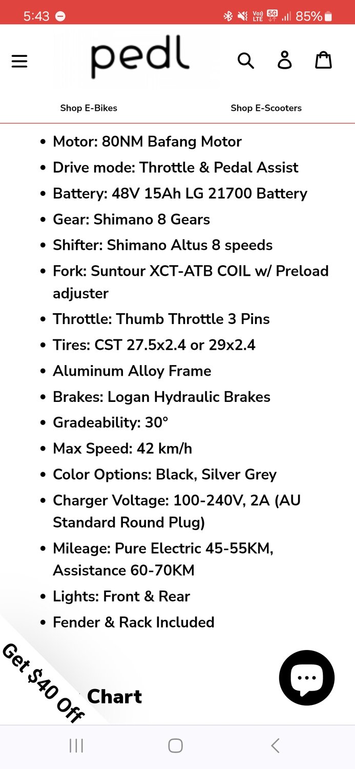

The bikes are the NCM Moscow Plus (I'd likely replace the tyres), ET Cycle 1000 and finally one that is local to Australia and that's the Mamba Venom Antidote. I'll post a link here, just wanted your guys opinion. To my untrained, amateur eye it looks both reasonably spec'ed and priced, coming in roughly the same price as the other 2. I'd really appreciate your thoughts - cheers.
https://www.pedl.com.au/products/ma...-electric-bike-48v-750w-15ah-720wh-lg-battery

The mamba doesn't say but appears to have a bafang mid-drive, which has a lot of fans on this site.
It's a hub drive. I hear what you're saying regarding quality materials. Looking at the spec list though names of components appear familiar - Shimano, Bafang, Suntour, LG. This is what piqued my interest in regards to this model. I've searched local forums for info but these are a new model, the model they are superseding doesn't carry the same componentry, but in saying that, I have not found any issues with frames cracks or fractures.

On the face of it the Mamba seems like a better commuter choice. I would be a bit skeptical of the Logan brakes. You would want to make sure you make an informed choice about the legality of a high speed throttle ebike where you plan to ride it. And you would probably need to charge at work since your round trip is pretty close to their range estimate.
