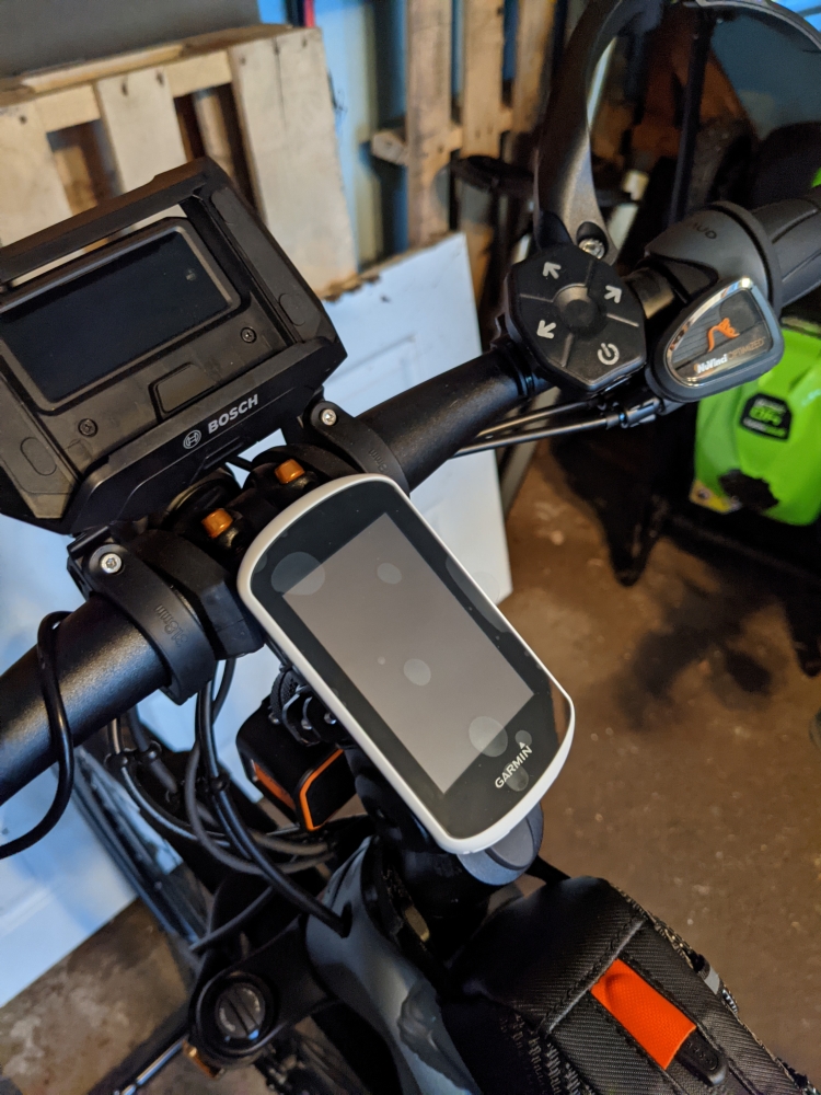

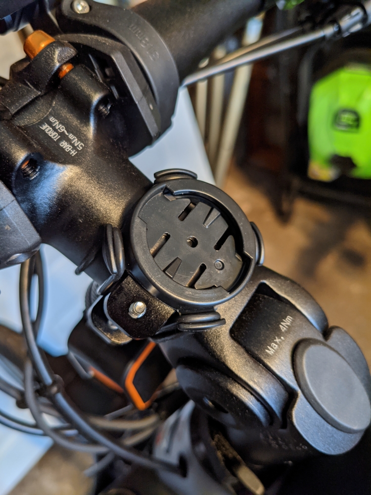

Just curious ava1ar, which stem mount do you use? I've been looking at garmin but I wasn't sure how I'd mount it with the smartphone hub. Is it pretty stable just with the stem mount?
This is the mount I found in the box with 520+ - it is connected to the stem using two rubber bands and it is rock solid (I believe it sits there so well because I mounted it on top of the my front camera adapter).
Checking out the Edge Explore now - decided what to keep. Honestly, Explore looks much better for my needs (navigation). Also, touch screen navigation is much better than I expected!
P.S. Yes, Edge Explore is definitely nicer than 520+ for the navigation purposes. 520+ goes back to Amazon, Edge Explore - welcome to the family!

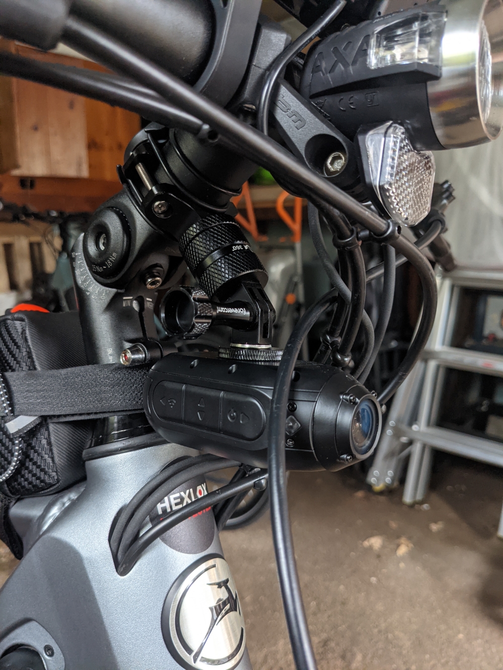

Thanks for confirmation Darlinsk and Alaskan! But actually charging the phone is the last thing I care about here. Let me explain. For last 6 month I am in search for perfect camera setup for my bike (I am riding though the NYC a lot, so I want to have recording just in case something happens) - so I am looking for something like car dash cam. My requirements are:
  • descent video quality (so the plates are readable)
  • ability to have "infinity storage" (new videos overwrites old when storage is full)
  • ability to integrate with my bike, so I don't need to think about charging and turning on/off the camera.
While first two criteria are pretty basic and there are lots of options, it is difficult to do something with 3rd option, but with SmartphoneHub I was able to get it working almost like I want. And how, after upgrade I lost that and need to start my research from scratch :(
I am using Drift Ghost XL camera mounted under the front light and it has a special waterproof power connector (using 3.5mm audio jack which screws in the came case one one side and regular USB connector on other). Also, this camera has a "dash cam" mode, when it powers on / start recording when powered on via the cable and stop recording / powers off when power is disconnected. Since SmartphoneHub has a power port, I just made a special cable from the one coming with the camera and one coming with the Hub, so camera is always connected to the hub port. And this was giving me a trouble-free camera setup:
  • camera is powered on from the bike battery - no need to worry about it is dead since I forget to re-charge it
  • camera starts recording after I start the ride (SmartphoneHub powers on the port the app when the phone is connected to the hub and I am in riding mode)
  • camera stops recording after I ended the ride (SmartphoneHub powers off the port the app when the app is closed and phone is discconnected from the hub)
I used it few month in this way and it was working fine. And I was hoping to get similar with Nyon since it has a USB port (my fault I never double check it is suitable for charging, but knowing the even Kiox has it I have zero reasons to not expect much more advanced and expensive display can't do this like basic Purion can't), but my hopes are dead now. My plan now to explore the option to use some power from front/rear light power input (it has 12 volts, so I will need to use car/motocycle usb outlet with built-in convertor), but I am still not sure will it work and if is it enough power there to share between usb port and light itself.

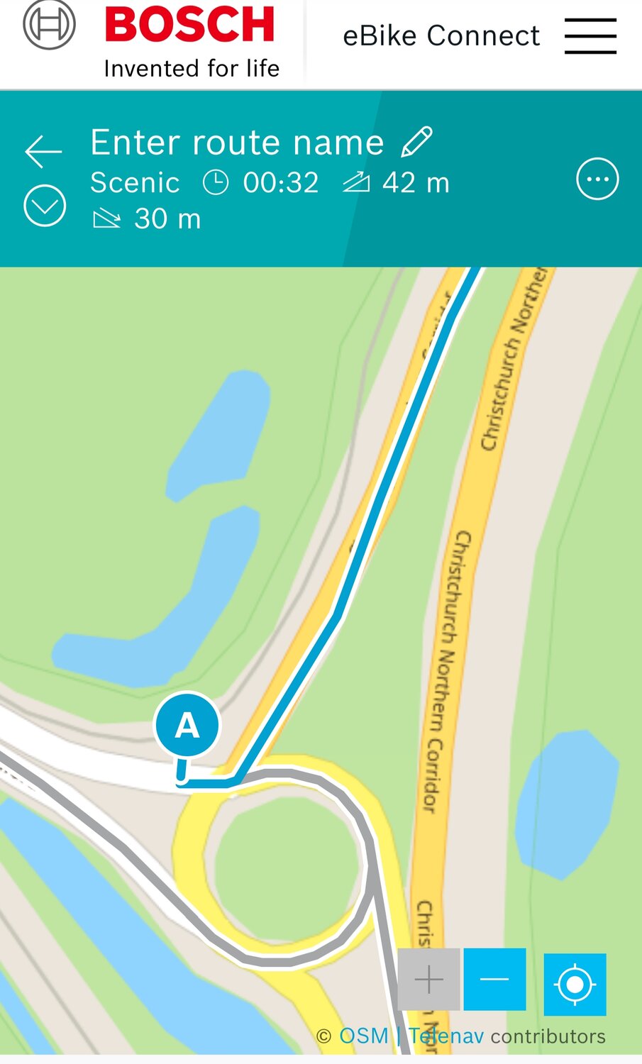

I agree. Personally I find this the most serious flaw. There are many times when you want to join a route half way through, or pause the route guidance because you want to detour for a while. Sometime I only need route guidance on the way back along a route. Nyon has a hard time in these situations. I think this is because the software still tries to compute the navigation between waypoints and often there are too few waypoints. Often just the destination waypoint or the start/stop waypoint on a return journey. So when you start navigation somewhere along the route, the software can only see the beginning A and end point B and tries to take you back home to point A because its closer. The software doesn't seem to see the route. This happens on both routes calculated in real time and saved routes that are downloaded. Unfortunately, even if you manually navigate to the route, the route you have downloaded or want to follow may not be the route the bike now wants you to take if the conditions or settings are different. For example, you may have a scenic route that you want to follow, but when you manually join this route and turn on guidance, a new route is generated that may be quickest or shortest, or some other variation, because the routes are computer generated between way points. The fix would be to have the software put an invisible waypoint at every turn along the route, and then when you turn on the guidance, it would navigate to the nearest turn. Bosch seems to have great ideas, but still needs to iron out the details.
Yes, the cycle routing in Nyon 21 and Bosch Ebike Connect Is an ongoing disappointing saga.
An example of the flawed routing engine is attached. The planned route follows an official designated cycle path and, in fact , starts and finishes on the path. The cycle path is shown on the map (other OSM based routing apps use the path). However Nyon/EBC "refuse" to use the path. As you can see, the worst case has the routing diverting onto the motorway. That's so obviously ludicrous it's not dangerous but I can envisage other scenarios being dangerous.
On a positive note, there may have been some recent improvements with importing GPXs and allowing to simply follow the track.
