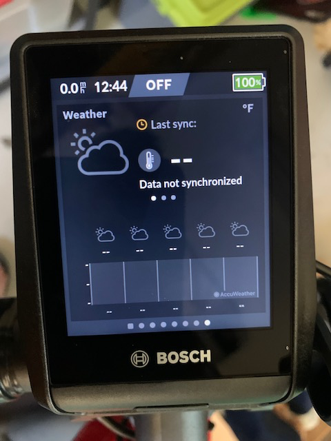

Has anyone had any success with getting the weather to sync? I get the feeling that this has to sync over bluetooth, not wifi, but I'm not sure.
I called Bosch USA and they couldn't get theirs to work either.
That's disappointing.
In Las Vegas I'm not in danger of getting rained on, but the sunset time, and wind estimates would be useful.
never tried it. dont really see a need with our phones. I battle my garmin not to give me the weather. it always gets me warnings when I am about done with the ride.
Nyon sync the weather page via bluetooth when the phone is connected. Given that you have to have the phone with you to get current weather, it is just as easy and way more customizable to just get weather info on the phone via your preferred app. Mine is Windy,
what he said! Open the Bosch connect app on your phone so you get the phone connected icon on your Nyon, weather should sync then
