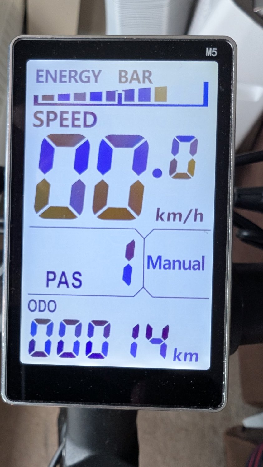

Hi Gang. I just bought a new Ecolo Cycle Mistic e-bike. The bike has an M5 controller. When I turn the controller on it automaticall goes into the P1 assist mode. There is no P0 (or manual) mode, which means that I have to turn the controller off to go into manual pedalling. I sure would like to see the screen in manual mode and not have to turn the controller off and on (which requires a 3-4 second press) to swith between manual and assist modes. Can anyone help me with this? I attach a picture of my M5 display. Although the display does show a Manual setting on the right side of the screen, I cannot navigate to it.....

M5 owners manual. Maybe you can try the 5 level and 9 level PAS settings instead of 3 level. The manual says it doesn't have a PAS 0 in all three PAS options. Does it have a throttle?
There is a reset mode P01 to go to default settings., Don't ever use it, as there are a couple of settings specific to your motor, and if you erase them, you have to read them off another bike that is the same.

Here's another version of an M5 manual. Look at the P09 setting,
Says if you set P09 to zero, you get a zero start. Maybe that means it starts in PAS0
Otherwise set to 1 for a non-zero start,

Thank You, Thank You, Thank You HarryS. Setting the P09 to Zero did the trick. I'm REALLY annoyed that I didn't figure that one out myself. The grey matter aint' what it used to be. If you're ever in Ottawa, let me know and I'll spring for a beer or two....
