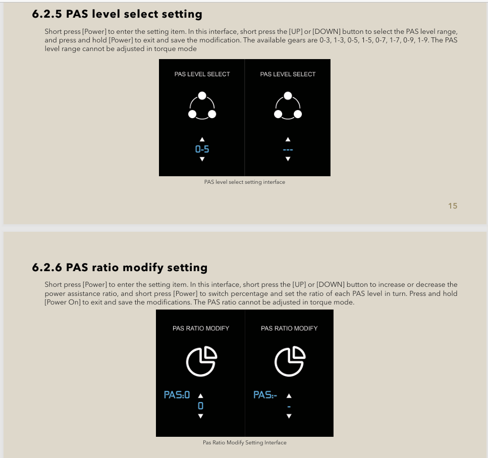

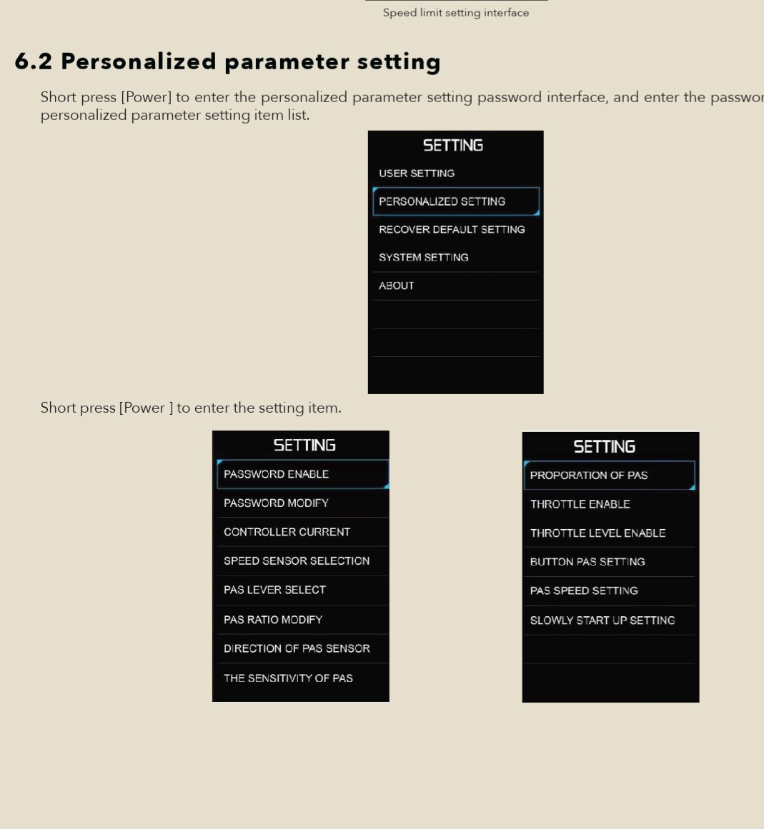

Hi I just bought a new MAUI e-bike and I was wondering if any one has experience with the K5351 TFT controller?
Unfortunately setting instructions for "PAS level select setting" and "PAS ratio setting" cannot be set while the unit is in "torque mode".
Bummer, no where does it say how to get out of "torque mode" or if any other mode exists. So i'm stuck with no PAS. :(
Any information on this would be greatly appreciated.

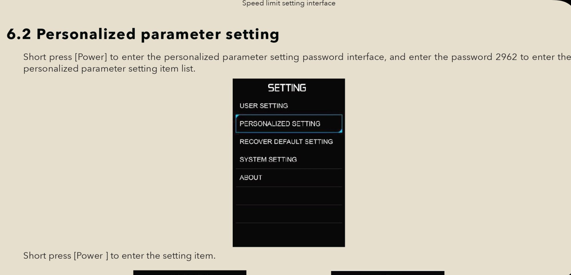

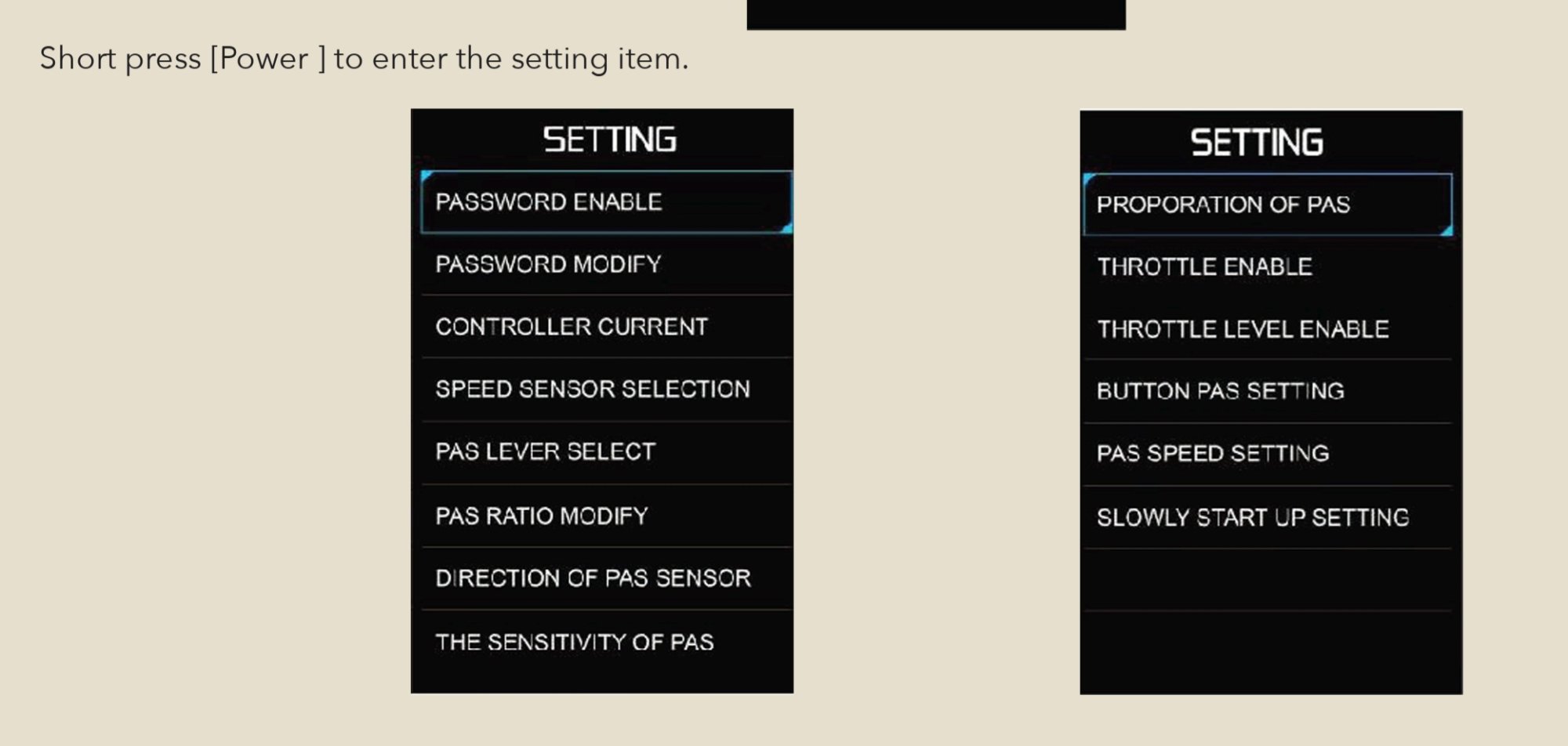

Maybe try 6.2 "Personalized Parameter Settings" first to see if you can switch it back?

Thanks for your reply it is much appreciated.
Unfortunately this setting does not say a lot and I beleive I will need to experiment a little on my own.
Of what I understand you probably either use Torque setting or PAS setting but not both.
Torque setting is used to mimick a normal bike use and from strengh(torque) it senses, it kicks in the motor.
PAS on the other hand is more like what we are accustomed to where you have 5 or 6 levels.
Let you know what I find out but thanks again for the reply

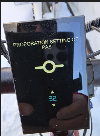

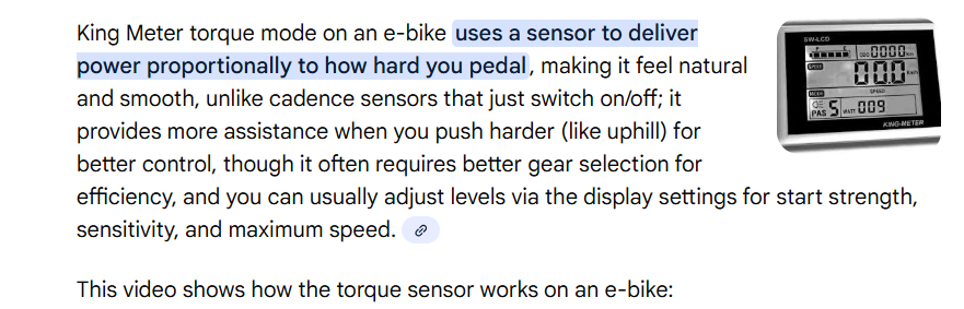

So here is the lastest on the K5351 TFT controller/display
For one, there is no word "Proporation" in the english language. This appears to be some kind of bad translation error, a contraction betwen Proration and Proportion.
From my readings, the K5351 TFT controller/display is designed to support both modes of PAS i.e. Torque and Candence if it is available for the actual e-bike.
Of course the sensors Torque and Cadence need to be present also. In my case, there does not seem to be any Cadence sensor so I'm gessing there is only Torque sensor.
The Proporation(Proration) setting appears to be a percentage and it was set originally at 24%. I Tries 32% with very little difference but at 50% started to feel very good torque from the motor.
FWIW,.. Most people that have a Torque Sensor prefer it over PAS.
That's the setting that I like to adjust.

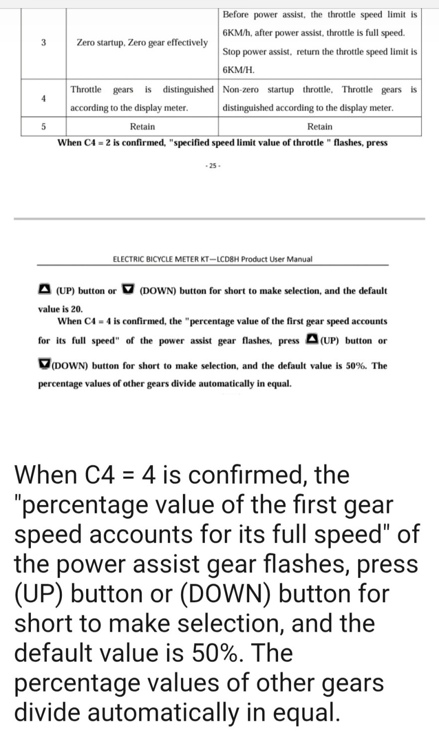

My KT controller and display have "Imitation Torque Control" which is the same sorta thing.
Power based control instead of Speed based control.
Don't forget that if your value is 50%, the percentage values of other gears divide automatically in equal.

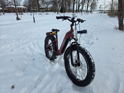

We are having pretty nasty weather, freezing rain and high winds today and possibly tomorrow.
I did notice though that 50% in the snow was a very good ratio.
Thanks for the tip and the info, much appreciated.

So I guess it is all about setting the PAS Level at the highest to have most granularity on the display and Proration setting at the maximum 100%.
Thanks again

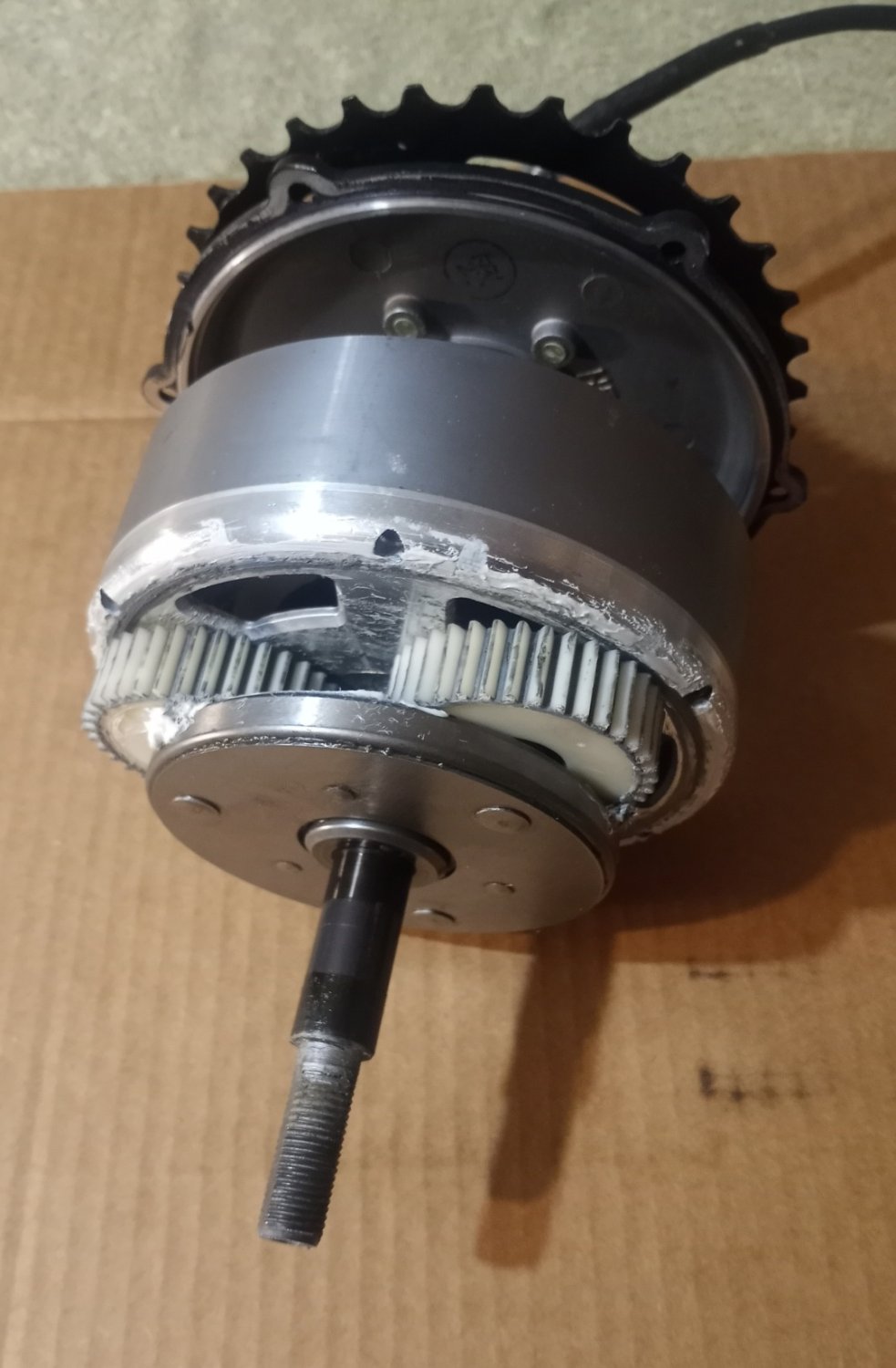

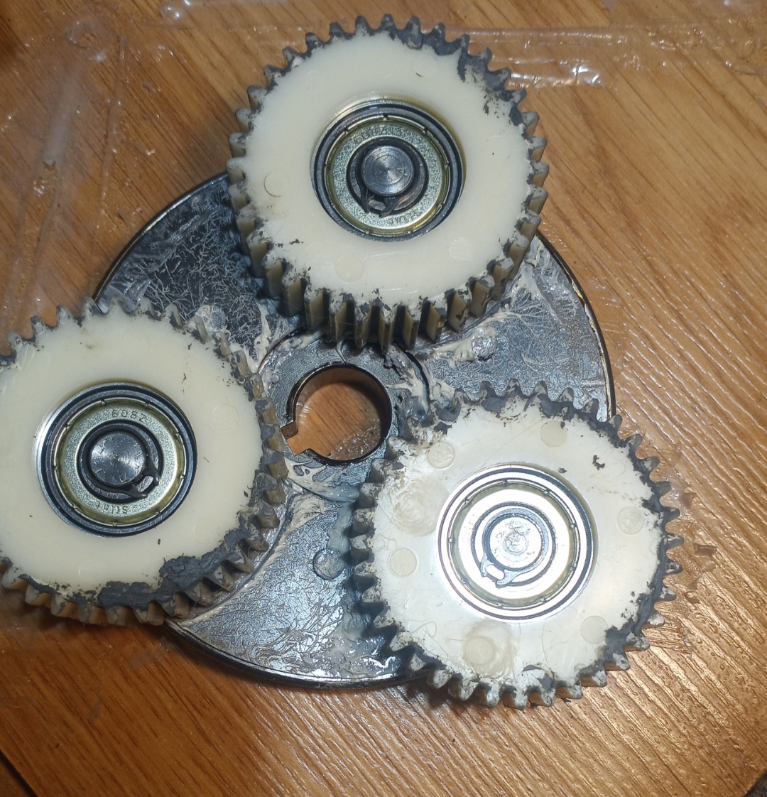

Keep in mind that you don't want to be slamming your power on too hard or you'll stress your nylon gears in your motor.
Try to ramp up the power smoothly to avoid shock.
You can hear a motor stressing and I occasionally get a loud "Clunk" when my throttle timing is off.
