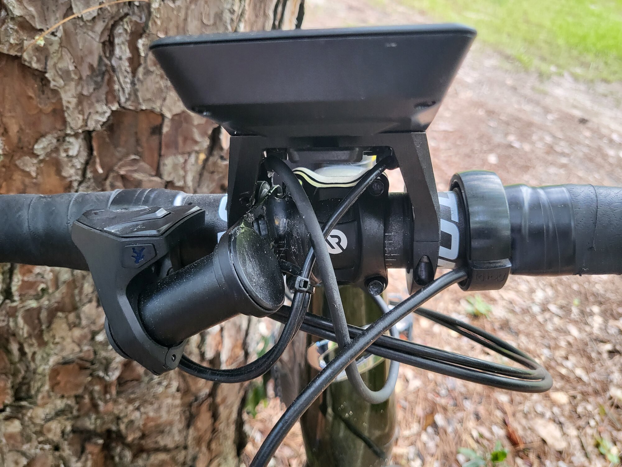

I have a Niner RLT e9 gravel ebike that came with the Purion display. About 6 months I upgraded to the Nyon because I wanted to customize my riding modes. I live in North Florida where the terrain isn't all that hilly and where most gravel/dirt riding is done on dirt roads or well-maintained greenways. Plus, I'm fairly fit and found that I usually ran at 25-30% assist and never had a need for assist settings of 50% or higher (3 of the 4 standard riding modes). Accordingly, I had little use for 4 assist/mode options so I configured my custom riding modes to create two sets of two modes each: The first set consisting of Mode1 and Mode2, and the second set consisting of Mode3 and Mode 4. Mode1 is 85-90-95-95; Mode2 is 135 throughout (50% increase of Mode1). Mode3 I set up as a more aggressive start: 100-110-120-120. Mode 4 is 170 throughout. So, if I just want a more aggressive ride, I switch to using Mode3-Mode4. Figured if I needed an assist level greater than 50% I could just go back to the "Standard" settings (85/25%, 170/50%, 255/75%, 340/100%), or pull out my phone and change the assist levels on the fly.
I did sometimes have a problem getting my Android smartphone to connect to my Nyon. In such cases, I've found that if I go to my phone and tap/start the "eBike Connect" app, it will immediately connect.
Re the Purion to Nyon upgrade: I found that the Purion handlebar mount made an excellent mounting platform for the Nyon's finger-pad. I did carefully bend it so that the finger pad was level with my handlebar.
