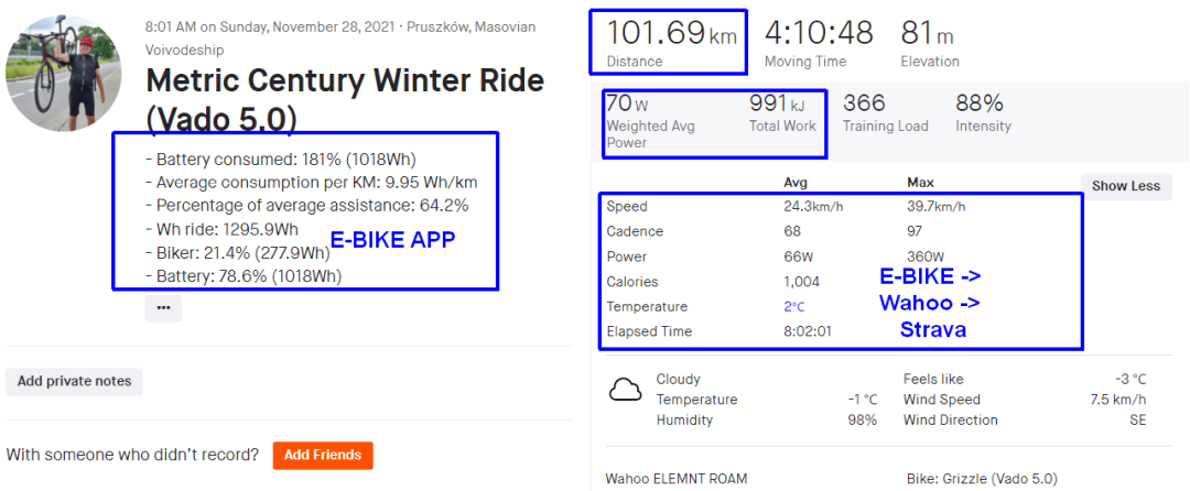

The capabilities of a Bluetooth/ANT+ compatible e-bike related to Strava.
This is just a way how bike export (or not export) the data to the external devices. Bosch has one approach, Specialized - another. Both have pros and cons. Honestly, I like Bosch Connect portal a lot - thinking about cancelling my Strava premium, since I have better (and more precise) data on Bosch Connect versus Strava and I don't care about Strava social capabilities at all.
It is because ANT+ e-bike systems deliver power, cadence, speed/distance, battery level, and Assist Mode as direct input to bike GPS computers, and the latter know how to talk to Strava. Including the ambient temperature for the ride!

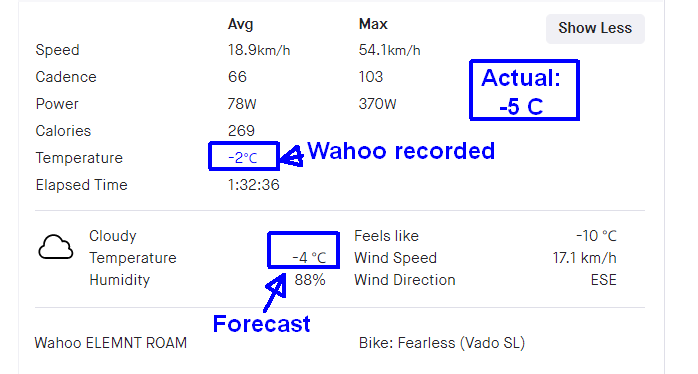

Hello Stefan.
Is the 2oC shown in your screen capture ambient temperature sensed by the Wahoo device?
That's one parameter Nyon21 doesn't appear to have. Would be handy.
Hello Stefan.
Yes, it is Peter. Although I think it was the temperature when I have just brought my e-bike into my car post-ride ;) I should have "stopped the ride" just at the ride-end instead of pausing it.
Besides, I'm finding the Wahoo's temperature entries somewhat strange. The Wahoo's thermometer was showing steady -5 C during my morning's ride today, and it is -2 C in Strava? Very strange!

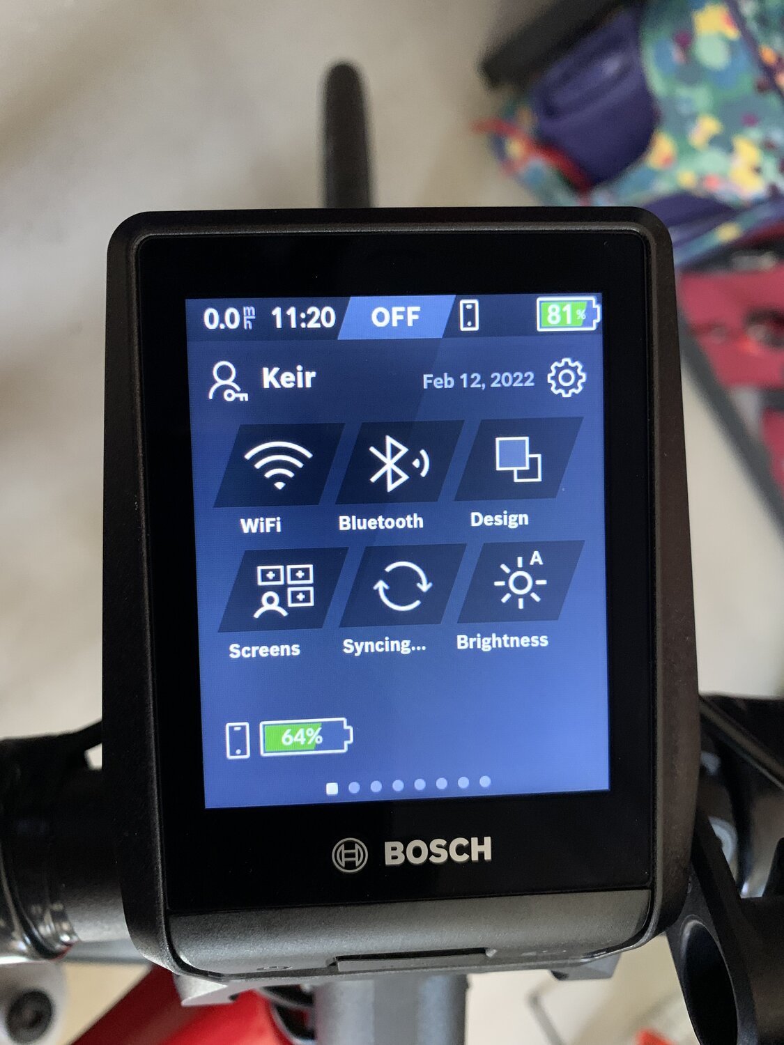

Nyon MY21 Bluetooth connection to iPhone.
Did you get any resolution finally, JPA, with your iPhone Bluetooth connection issue? I hope so, because it's been a while ago now since you posted about it, but anyway I had the same problem in October that took me two months to resolve (and two months worth of lost data). I did a lot of research, including this forum, and couldn't find a solution anywhere, but eventually I fixed it, so thought I'd post my experience to maybe to help others.
In my case it seemed to be a quirk of the iPhone (iPhone 8) operating system: the Bosch Ebike Connect app insisted I was connected by Bluetooth to the Nyon after lots of pairing, hard resets etc. but I still could never upload any ride data to the Bosch portal.
So what solved it in the end was, on the iPhone, go to Settings>Bluetooth, and then on 'My Devices' look for the Nyon (B350-etc. etc.). Whether it says the Nyon is 'connected' or 'not connected', just open the blue-circled information icon and click on 'forget this device' anyway. If you then repeat the pairing process again from scratch it might all work properly. Did for me anyway. It seems that internally, within the Apple world, if the app shows as 'connected', it just ignores the re-pairing process, so you have to 'forgot this device' before trying again. Simple, I know, but I couldn't find that out anywhere and there was a lot of trial-and-error involved.
Ya you have to forget the device. Hey I had to work out how to connect a new and a old nyon. I had to manually connect the old nyon it wont work through the nyon menu. every time I ride I have to open the bosch app and connect to either nyon.

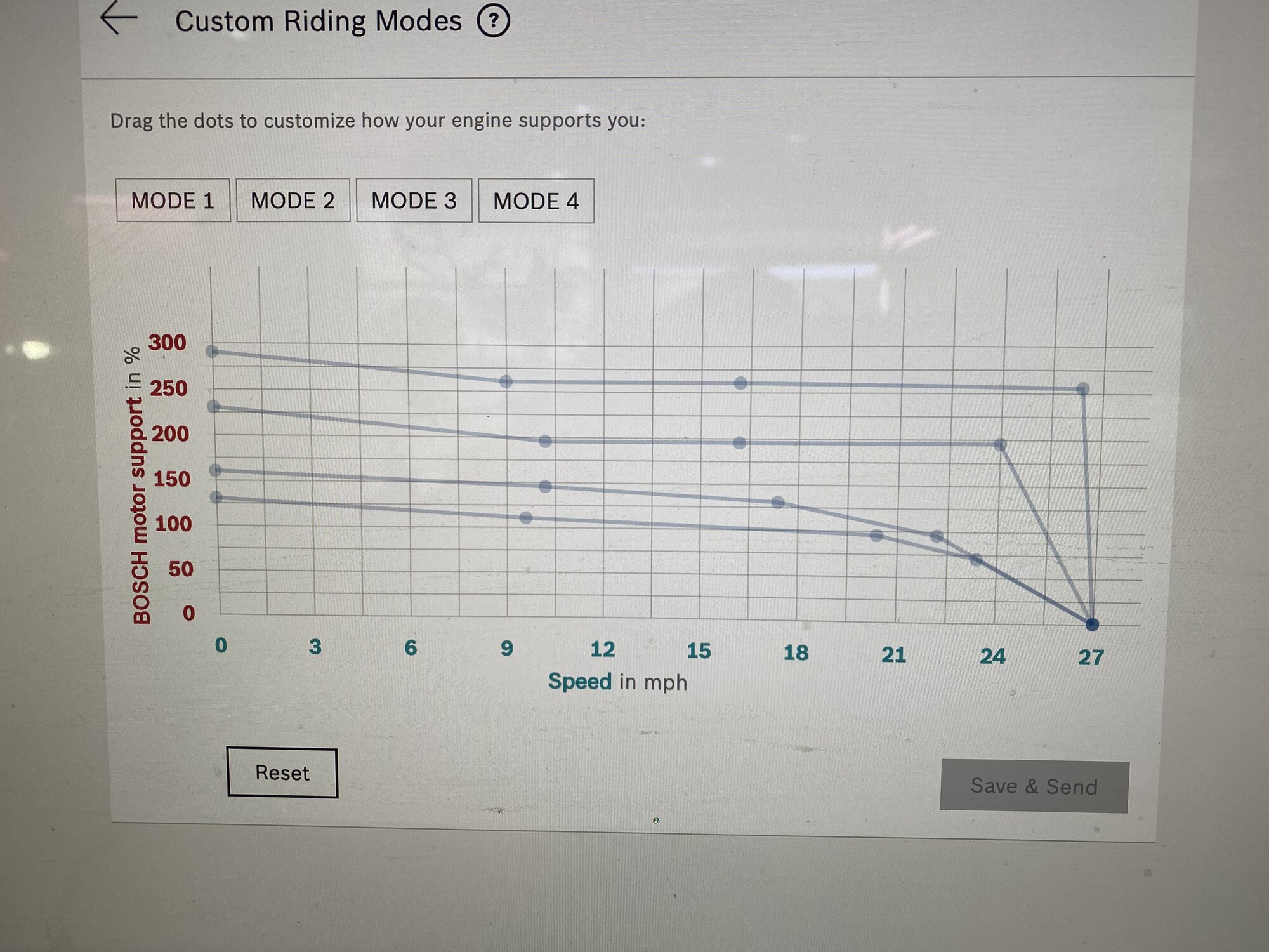

Now, the Custom Riding Modes is another story. I couldn't wait to start messing with that. My bike, with an 85 Nm Performance Speed motor, is probably overpowered for what I'm doing, even though I'm an almost 68-year-old woman riding in hilly Western North Carolina. I insisted on a 1X drive train but now find that I am too often in the slightly cross-chained and decidedly noisy highest gear. I typically spend 55% in Eco; 30% in Tour and 15% in Sport. I never use Turbo. I've been fiddling with bringing the support levels down in all of the modes. Interestingly, a relatively minor change resulted in significant battery savings. Just taking each of the bottom three levels down 10% (60->50, 140 ->130, and 240 ->230) reduced my battery consumption from 53% to 40% on the exact same ride (27 miles, 2500 feet of climbing), with nearly identical speed and assistance. Unfortunately, I was still too often in the highest gear. I will continue tinkering with the assistance modes and report back. BTW, I like that I can change from custom riding modes to the Bosch default modes on the fly. It gives me the confidence to experiment.

  2. Is there any way to see what the default Power Assistance profiles look like? Are they flat power, or are they curved? And how does the top Nm for each mode fit in with customized modes? There doesn't seem to be an option to fiddle with that when customizing the assistance modes. My guess is that it's a top-end limit, which wouldn't impact an old fart like me, but still, idle mind want to know. Also, I'm assuming that the Range is less meaningful for customized zones?

Any more updates on those custom riding settings? I am upgrading from Purion to Nyon this week and -just like you- I can’t wait to play with the custom ride settings. Would love to see screenshots of your settings. How are you liking the Nyon so far?
Nice! Thank you that is helpful! What was your goal/purpose for these custom settings (longer battery life? more comfortable? Etc) What kind of mileage are you getting from these settings vs from the default settings?
it was to let me use eco more as it was way too large of a jump from tour . less on tour as the speed I wanted to travel kept me lower on my power output then I wanted. I didn't not need as much power on the sport and turbo. I didn't to see a huge improvement in range but my energy levels vary so much its hard to really know. I have found if I am really tired and average less then 130 watts per ride Get more range than if I am between 130 and 145 watts that seems to be the battery sucking range. then above that I start getting more range.
