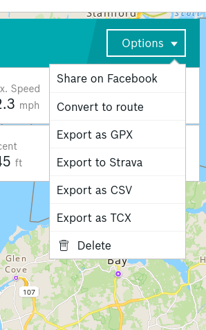

Is there some way to sync with Strava
Nyon syncs everything to the ebike-connect.com and you can export rides to Strava there (and only there, i.e. not from the app). Also, it looks like there is no auto-sync functionality - after ride you need to go and sync it manually.
SmartphoneHub in this aspect was much better, since it did the Strava upload automatically and directly from phone.

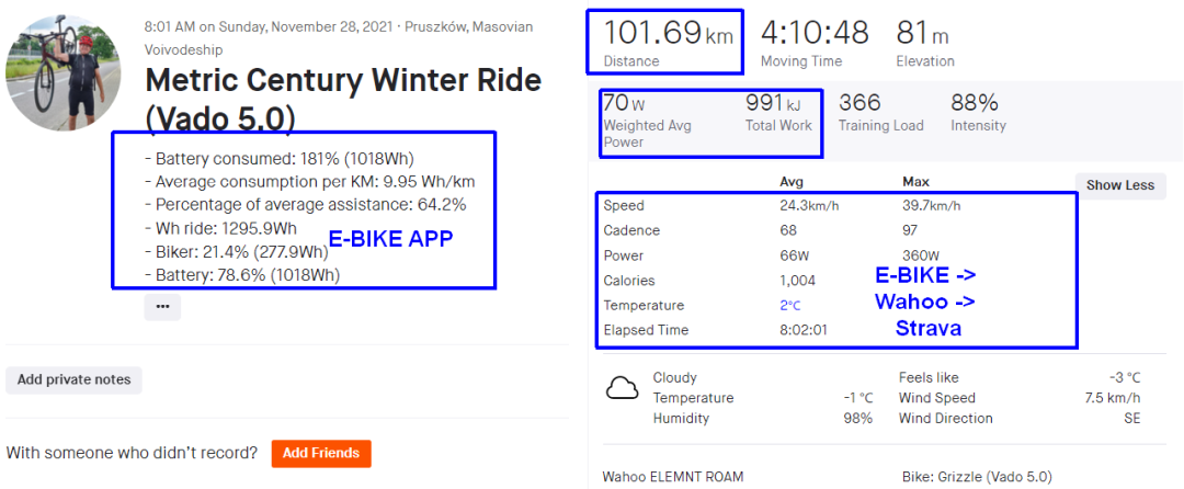

What is the connection between not reporting watt average and absence of ANT+? With Nyon ANT+ is not actually needed, since bike
already has all main sensors built-in, except HR, which is easy to connect via Bluetooth.
more likely strava just not setup to read that method of power bosch uses. but t could be just a strava thing too.
It is because ANT+ e-bike systems deliver power, cadence, speed/distance, battery level, and Assist Mode as direct input to bike GPS computers, and the latter know how to talk to Strava. Including the ambient temperature for the ride!

The capabilities of a Bluetooth/ANT+ compatible e-bike related to Strava.

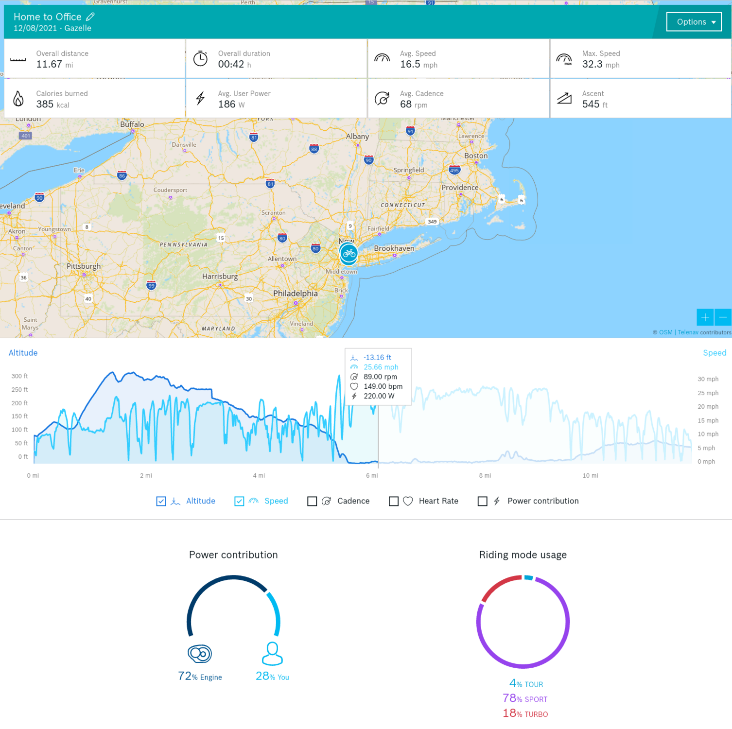

This is just a way how bike export (or not export) the data to the external devices. Bosch has one approach, Specialized - another. Both have pros and cons. Honestly, I like Bosch Connect portal a lot - thinking about cancelling my Strava premium, since I have better (and more precise) data on Bosch Connect versus Strava and I don't care about Strava social capabilities at all.
