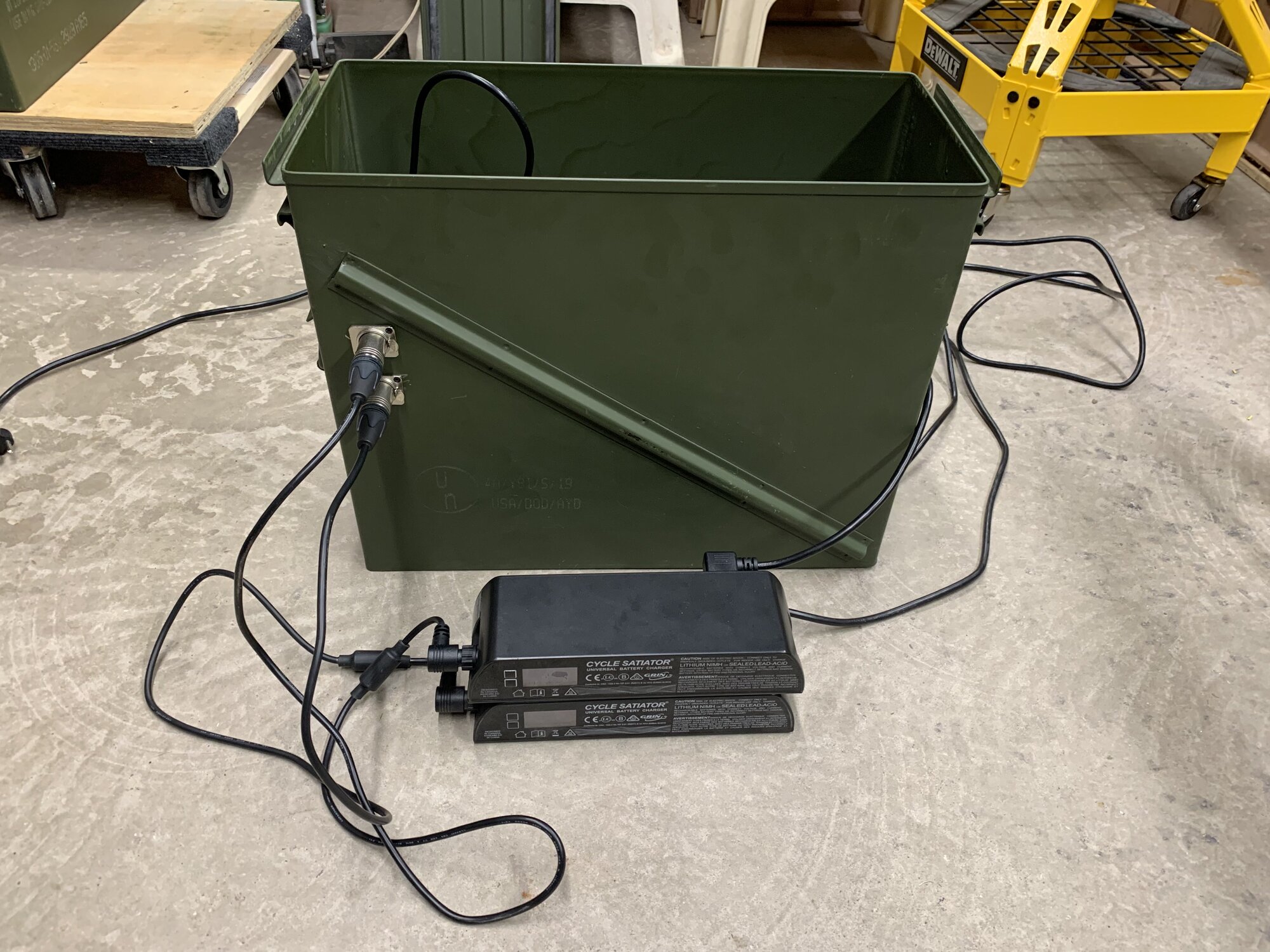

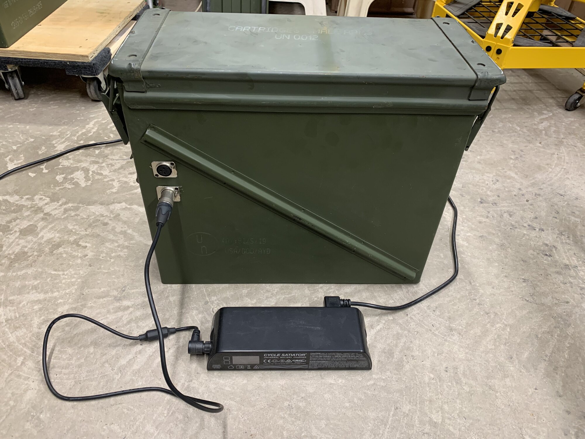

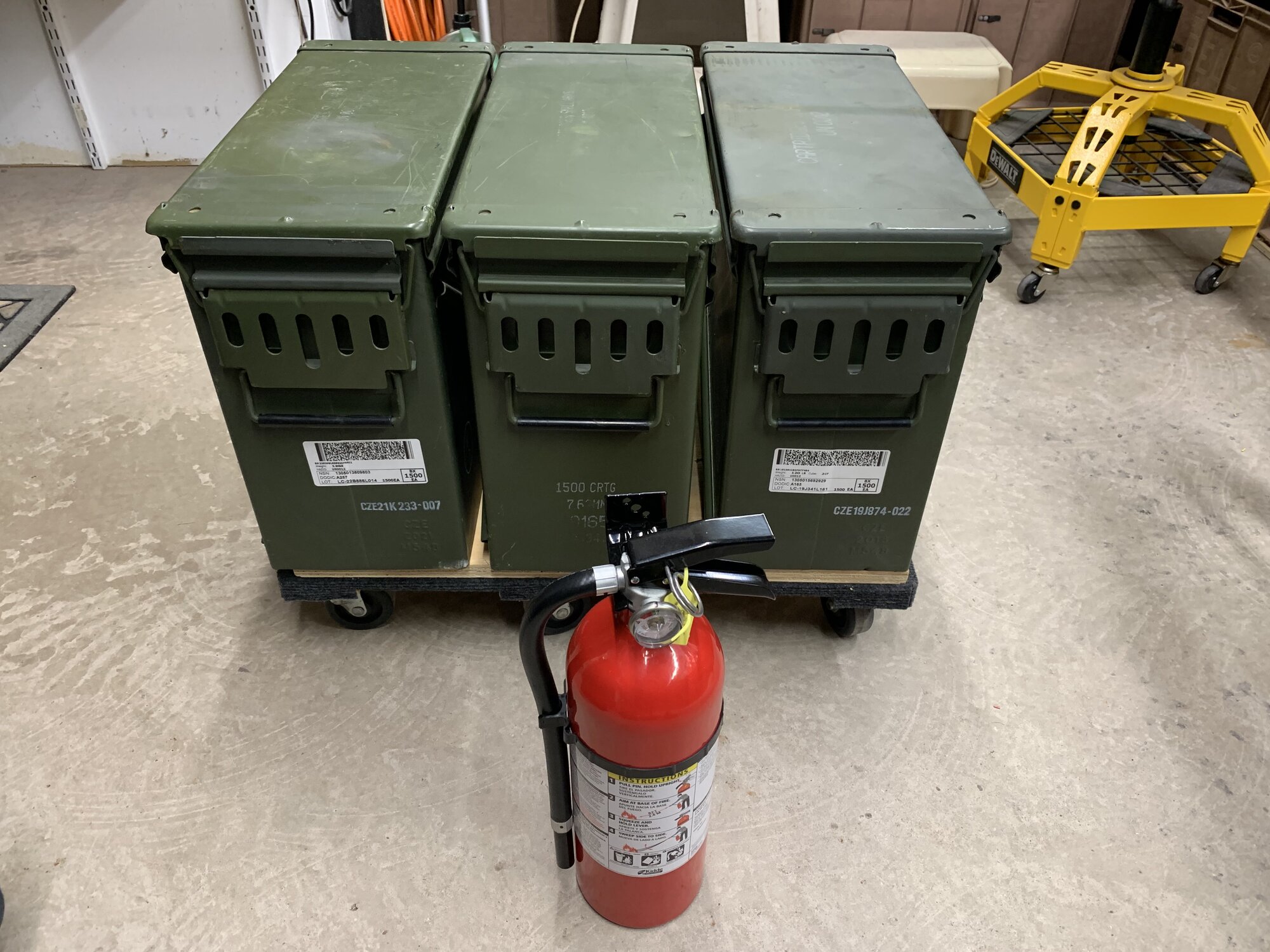

In my case, I lack the ability to charge outdoors or in a detached garage. My only option is to do it in my attached garage / workshop. I use ammo cans to both store & charge. They are placed on a dolly, on a concrete floor under a smoke / fire / CO2 detector. I never charge when I'm not able to hear the alarm. The dolly can easily & quickly be rolled out of the building with a garden rake should an incident occur.

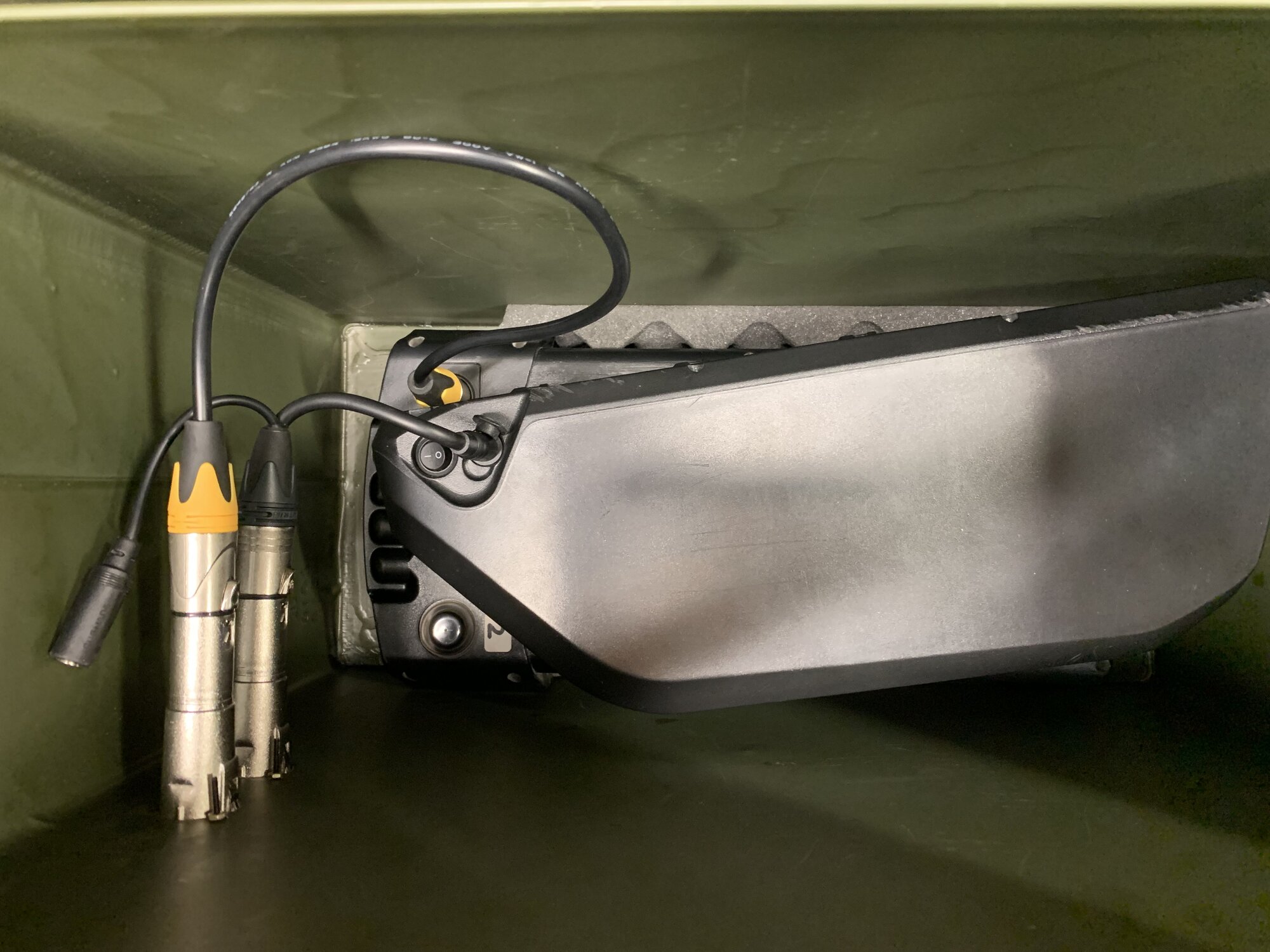

Two of the ammo cans are used for storage and the third for charging. That one has bulkhead connectors installed which will let me charge 1 or 2 batteries with the can sealed. I rarely charge two at a time unless it is at a low current rate to minimize heat buildup.
I can connect 1 or 2 chargers as necessary. I use Satiators with XLR plugs and adapters but almost any charger and connector type can be used. The bulkhead connectors allow the cans to remain sealed to better contain a fire.
Keep in mind, battery fires are relatively rare even when no precautions are taken. My system certainly isn't perfect but it does further reduce the risk of a catastrophe.

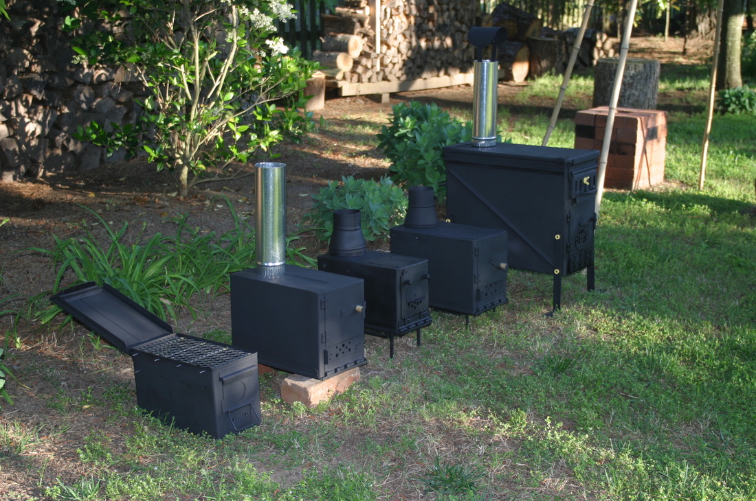

I often see old wood stoves cheap on CL and elsewhere. I thought one with a standard single wall steel vent stack would work for charging.
In summer these wood stoves are as cheap as above, winter you can expect to pay more. They could be setup to charge and store several packs of any size. A simple single walled steel stack could be vented much like a dryer vent.
How about cross breeding. ;)
Absolutely brilliant! Another winning creation. Copying for my 2 Satiators.

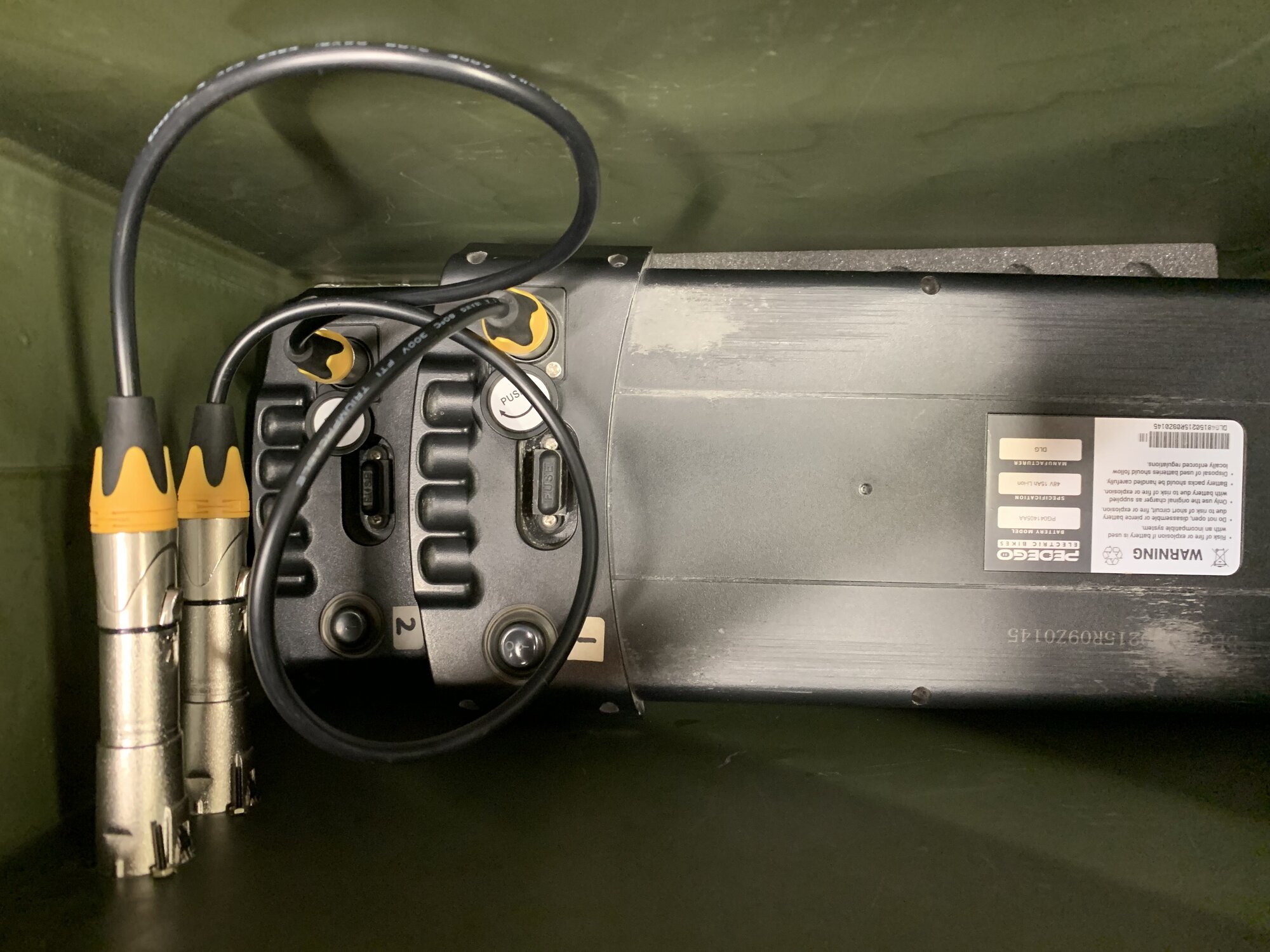

Here's a link to the XLR bulkhead connectors:
If you need short XLR male to XLR female jumper cables like the ones shown in my pics, DO NOT use audio or microphone / speaker cables. Most use 26 gauge or finer wire and can't handle 8 or even 4 amp charging currents. They will heat up and eventually fail. The resistance will also cause an inaccurate voltage reading and can affect the performance of the Satiator chargers.
I made up my own jumper cables using 18 gauge 3 conductor wire:
and these connectors:
Easy solder connections and the above cable fits the connectors perfectly.
I posted the following a little over a year ago, reposting here.
An interesting concept. Stoves are designed to contain a fire and direct gasses up the flue so I don't see why it wouldn't contain a battery fire.
I usually don't need to charge batteries during the winter so I could use my coal stove during the warmer months. Not an option for storing batteries during the winter though when the stove is lit. I usually disconnect the flue pipe from the stove when it isn't in use to keep dampness from coming down the chimney and causing corrosion. Still, a battery fire should be contained inside the stove, even with the flue capped. Clever idea!
Another possibility would be to charge in a fireplace with the damper open. Glass doors or even a screen would provide some protection from sparks and debris ejected from a fire.
I've seen no test data that proves that ammo cans are safe for 8 to 25 ah LiIon battery fires.
Bulkhead electrical connectors are suitable for sheet metal, not 3/8" (1 cm) steel plate.
My wood stove is sheet metal, not 3/8" steel plate.
Burning wood in a stove doesn't produce heat until it reaches 500°F and the burning isn't efficient until it reaches 1000 to 1100°F. The outside of the stove is typically between 600 and 800°F. A stove rated for coal, the coal reaches 2500 to 3500°F.
Lithium Ion cells burn at just under 1000°F (932°F to be precise).
Many modern steel fire boxes are lined with fireproof refractory panels that protect against the hottest fires. Cast iron fire boxes don't typically require refractory panels.
