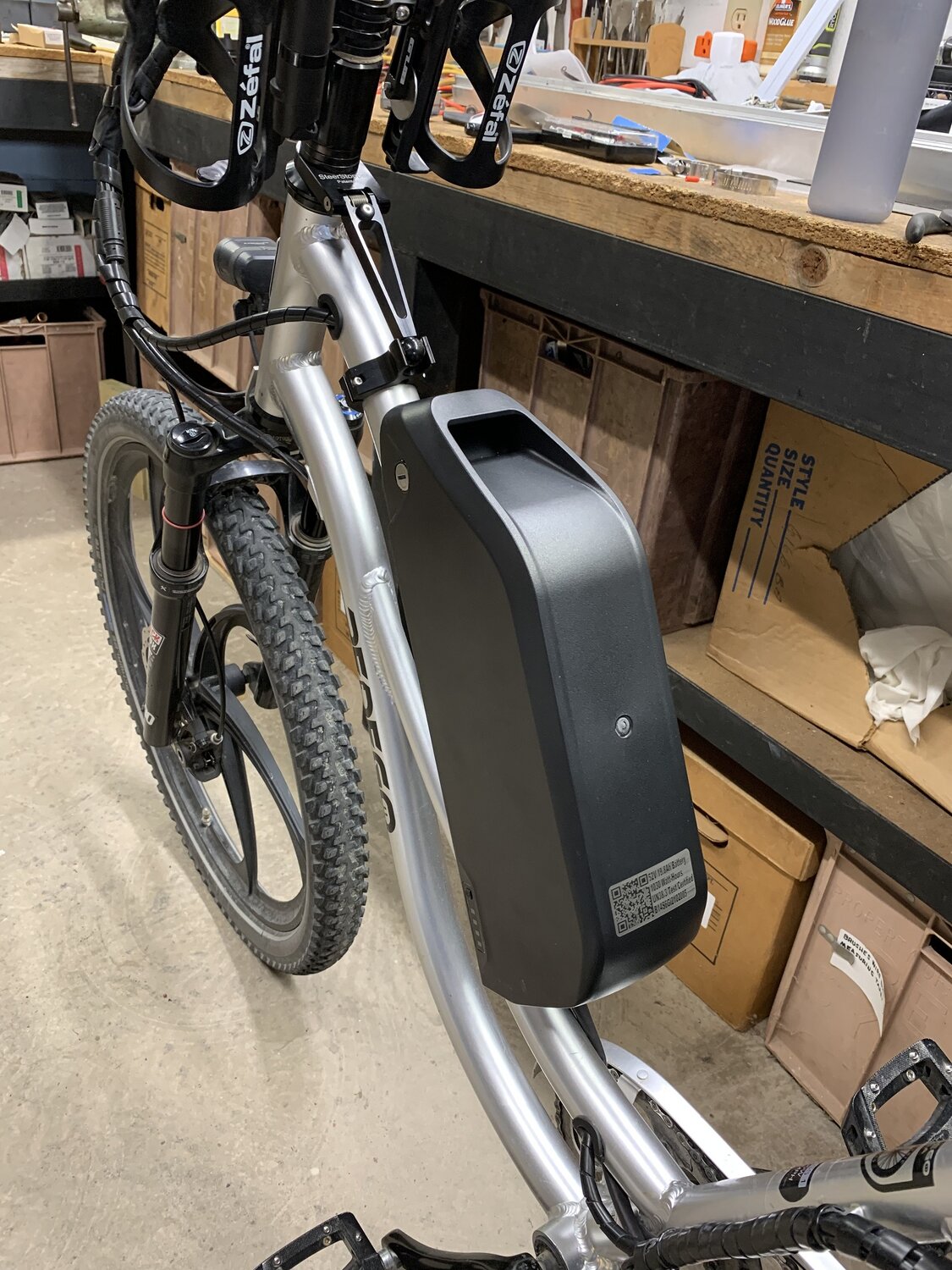

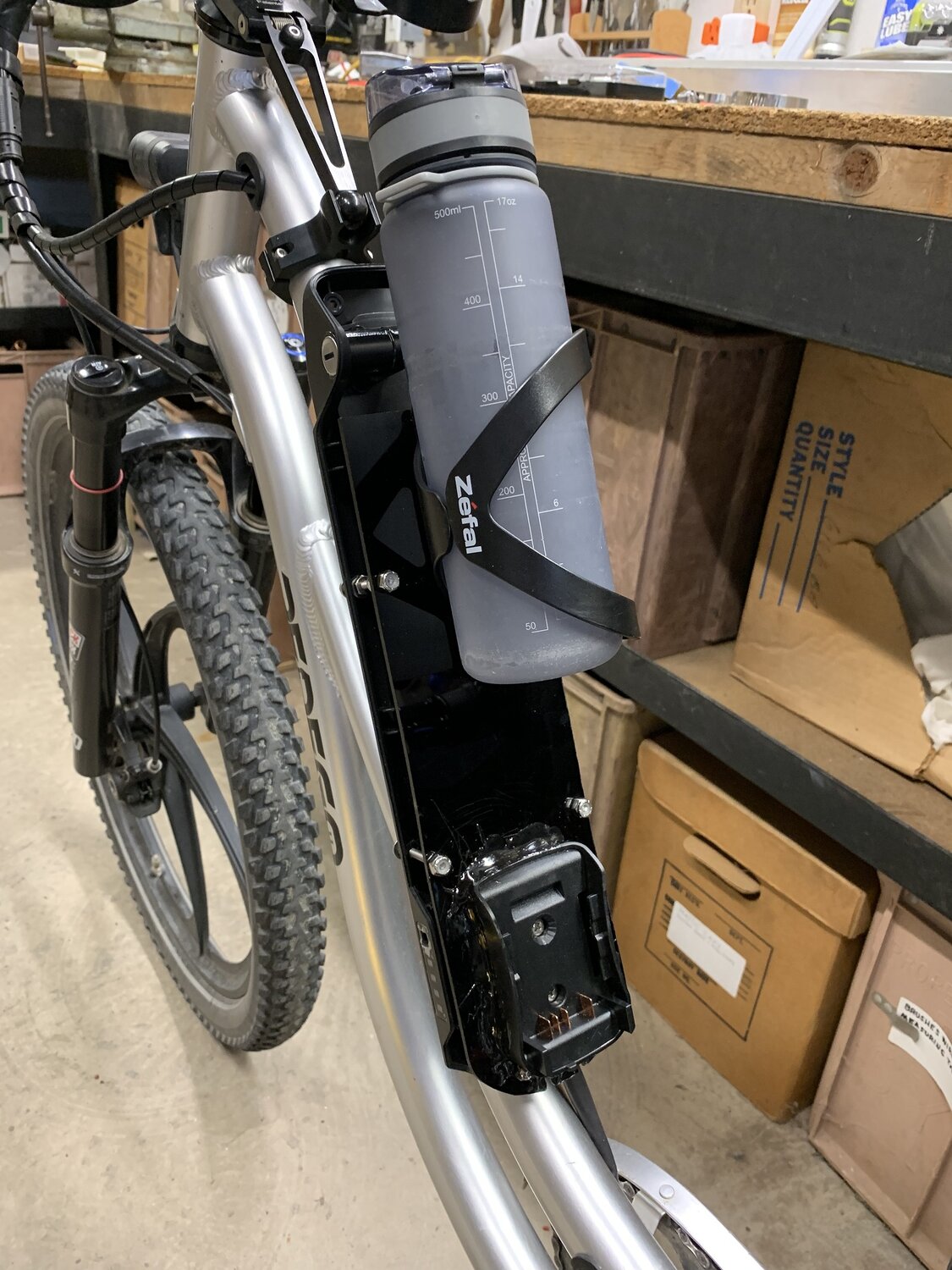

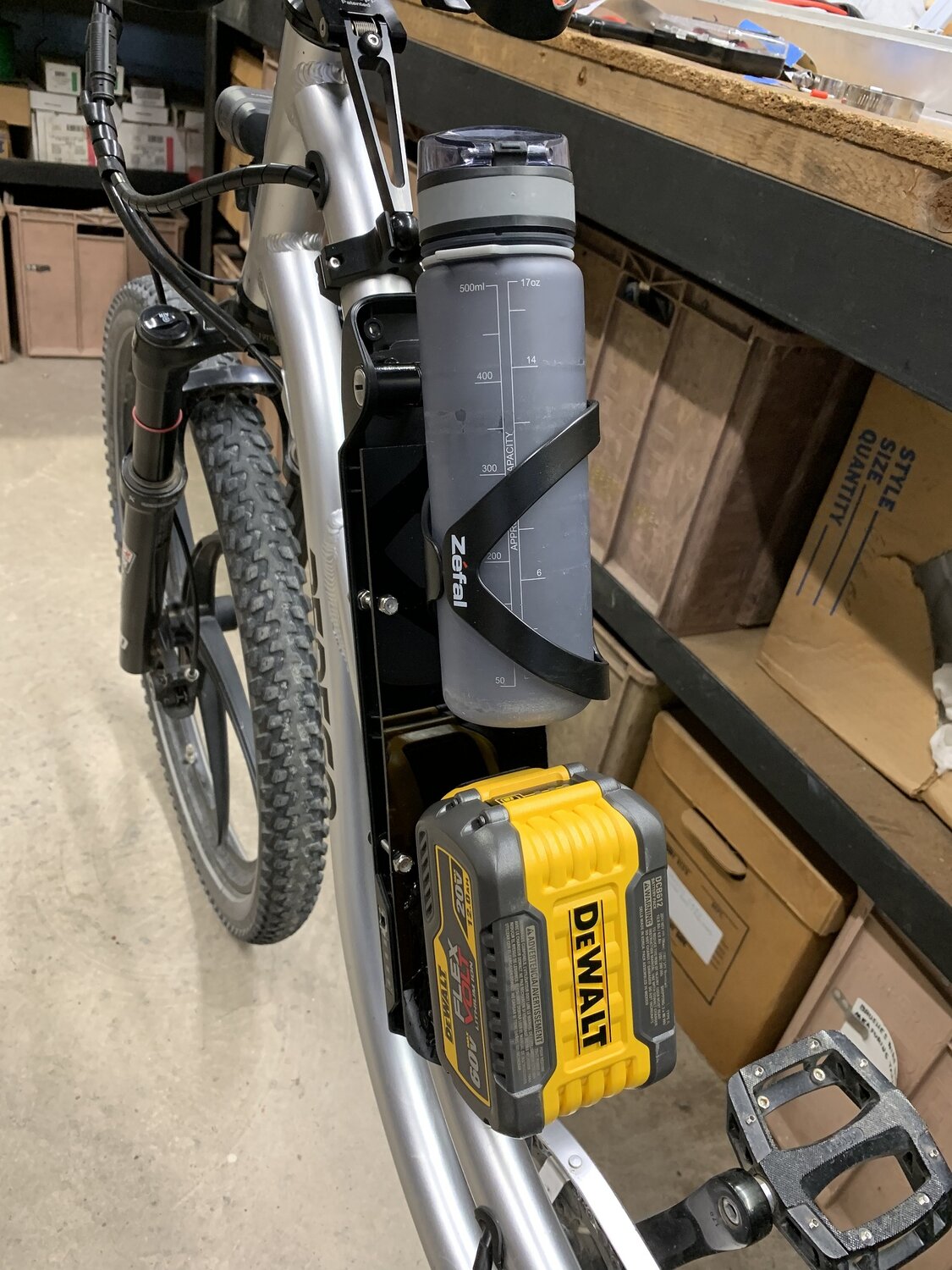

I already have quite a few DeWalt tools, batteries & chargers. I use them with the adapter you mention as e-bike range extenders. I mounted the adapter to the base of an old Dorado battery and swap it out like a spare. There's even room for a bottle cage.
