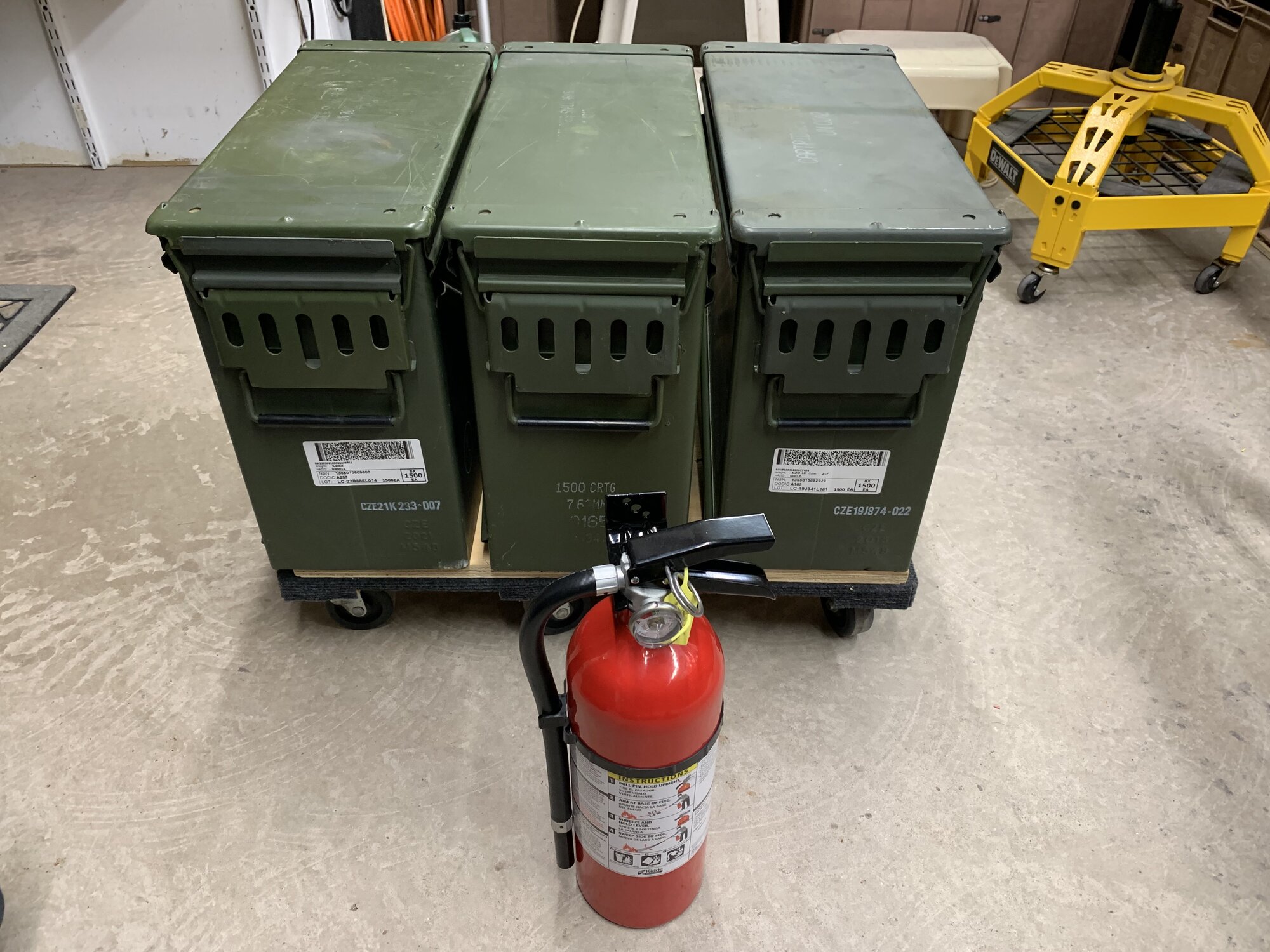

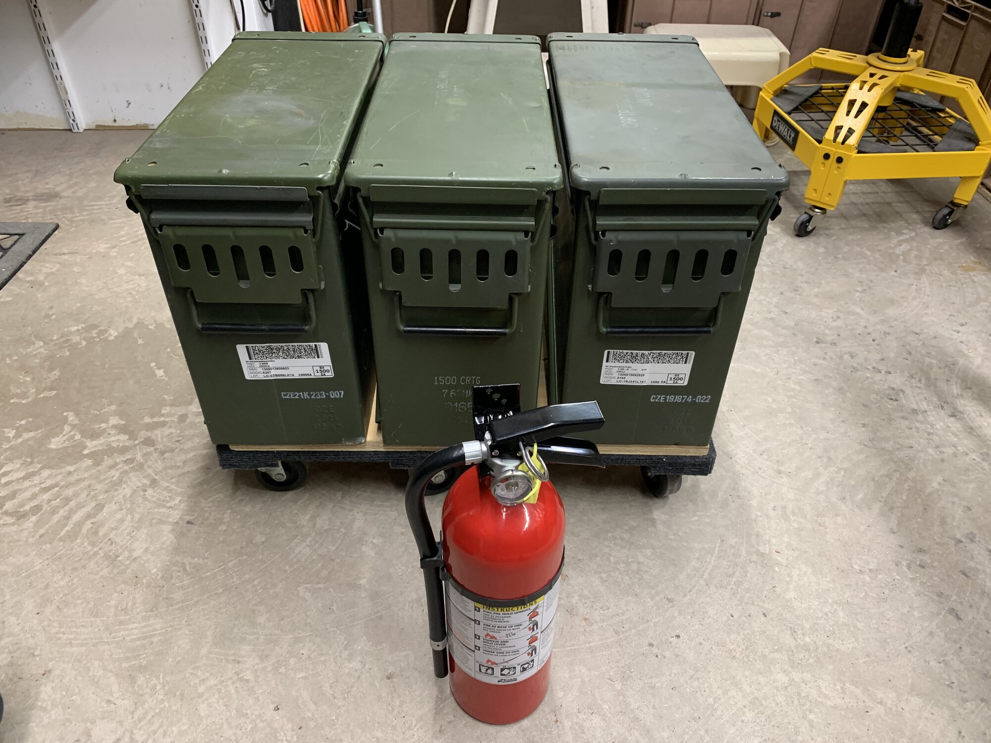

If you want to ride an E-bike, you will have to assume some risk when storing & charging batteries. Many threads here on EBR have outlined ways to mitigate this risk. They largely depend on budget (The ability to afford quality batteries & chargers), environment, DIY capabilities and a certain level of common sense.
Obviously, the safest way to charge is outdoors and away from anything flammable. Unfortunately, not everyone has the ability to do this consistently, mainly due to climate issues. The next best approach is to charge in a temperature controlled structure separate from the living area like a detached garage. Again, not everyone has this luxury.
In my case, I lack the ability to charge outdoors or in a detached garage. My only option is to do it in my attached garage / workshop. I use ammo cans to both store & charge. They are placed on a dolly, on a concrete floor under a smoke / fire / CO2 detector. I never charge when I'm not able to hear the alarm. The dolly can easily & quickly be rolled out of the building with a garden rake should an incident occur.

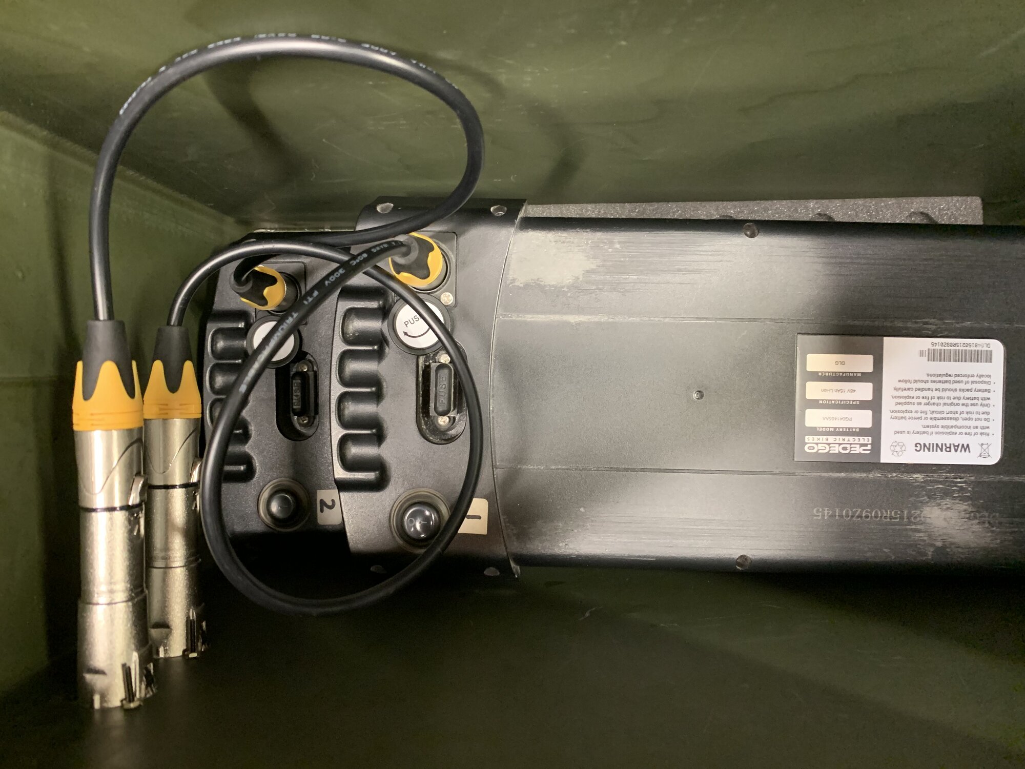

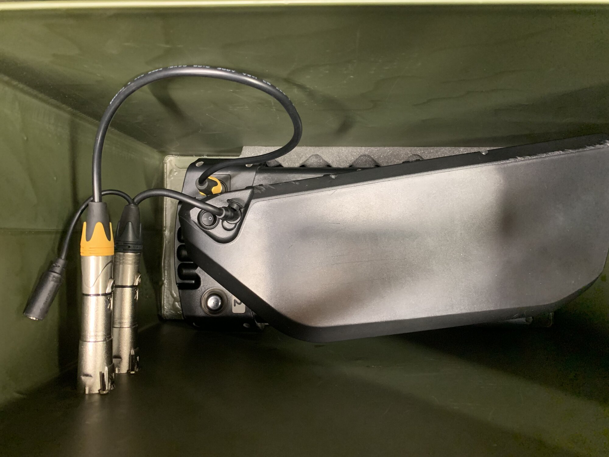

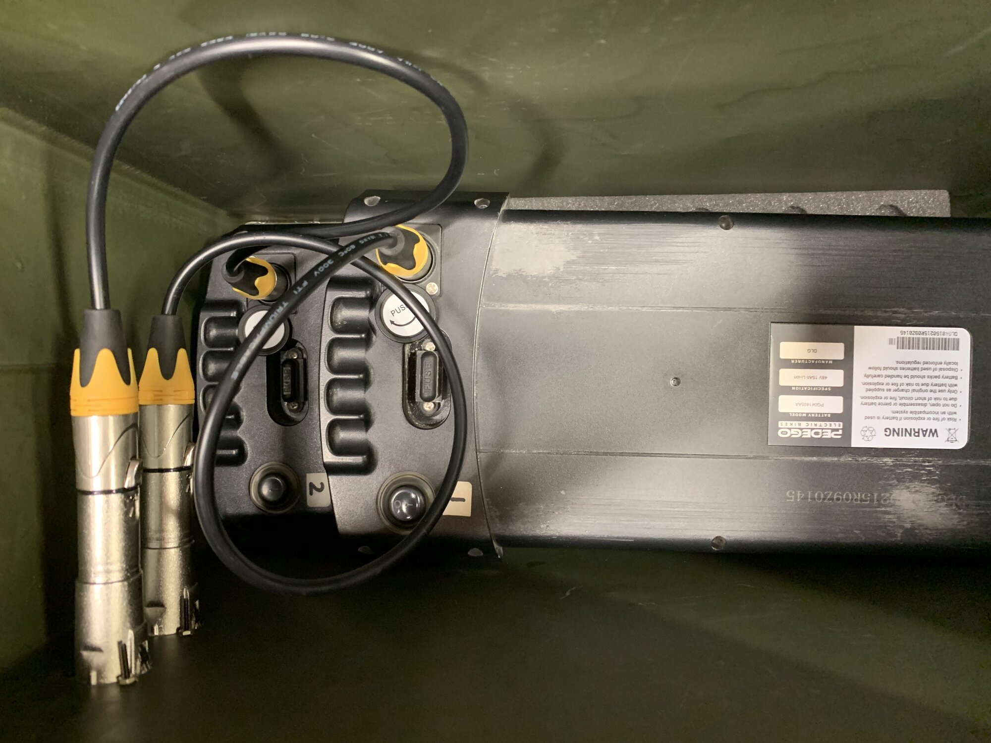

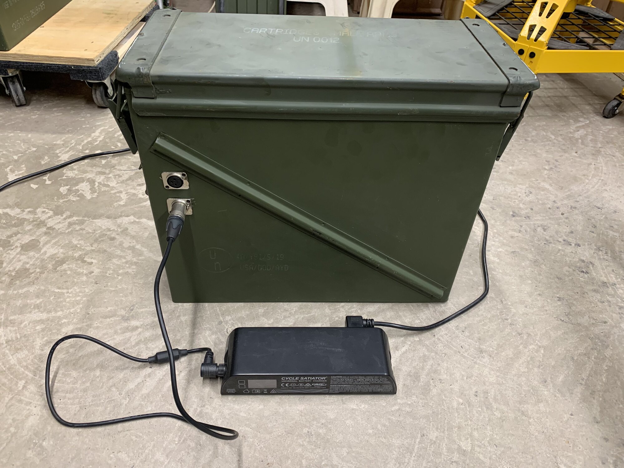

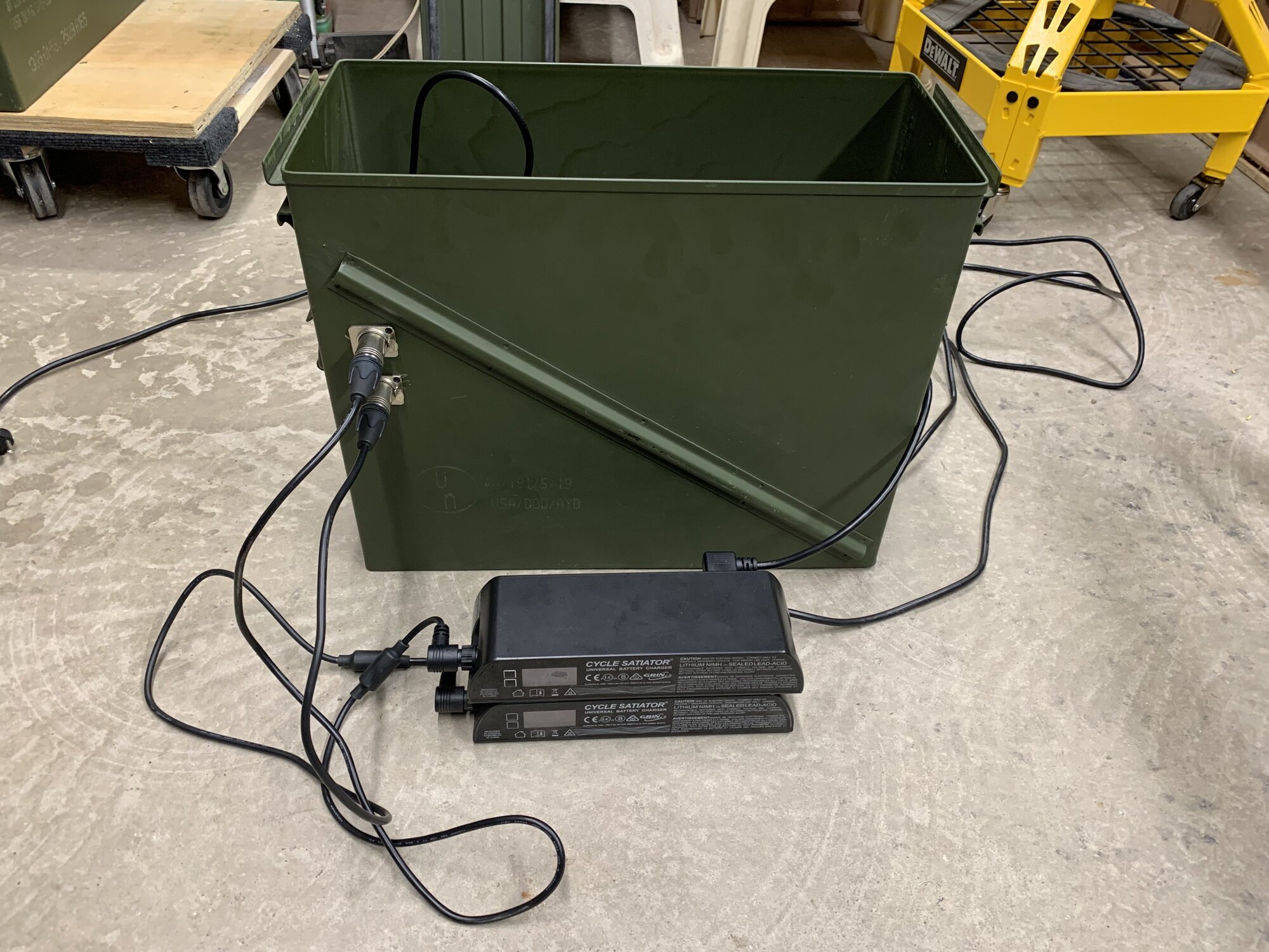

Two of the ammo cans are used for storage and the third for charging. That one has bulkhead connectors installed which will let me charge 1 or 2 batteries with the can sealed. I rarely charge two at a time unless it is at a low current rate to minimize heat buildup.
I can connect 1 or 2 chargers as necessary. I use Satiators with XLR plugs and adapters but almost any charger and connector type can be used. The bulkhead connectors allow the cans to remain sealed to better contain a fire.
View attachment 140217 View attachment 140220
View attachment 140218 View attachment 140219
Keep in mind, battery fires are relatively rare even when no precautions are taken. My system certainly isn't perfect but it does further reduce the risk of a catastrophe.
I'd be careful that in the case of a fire it can vent enough to release pressure or you may have a bomb on your hands that will spew shrapnel.
