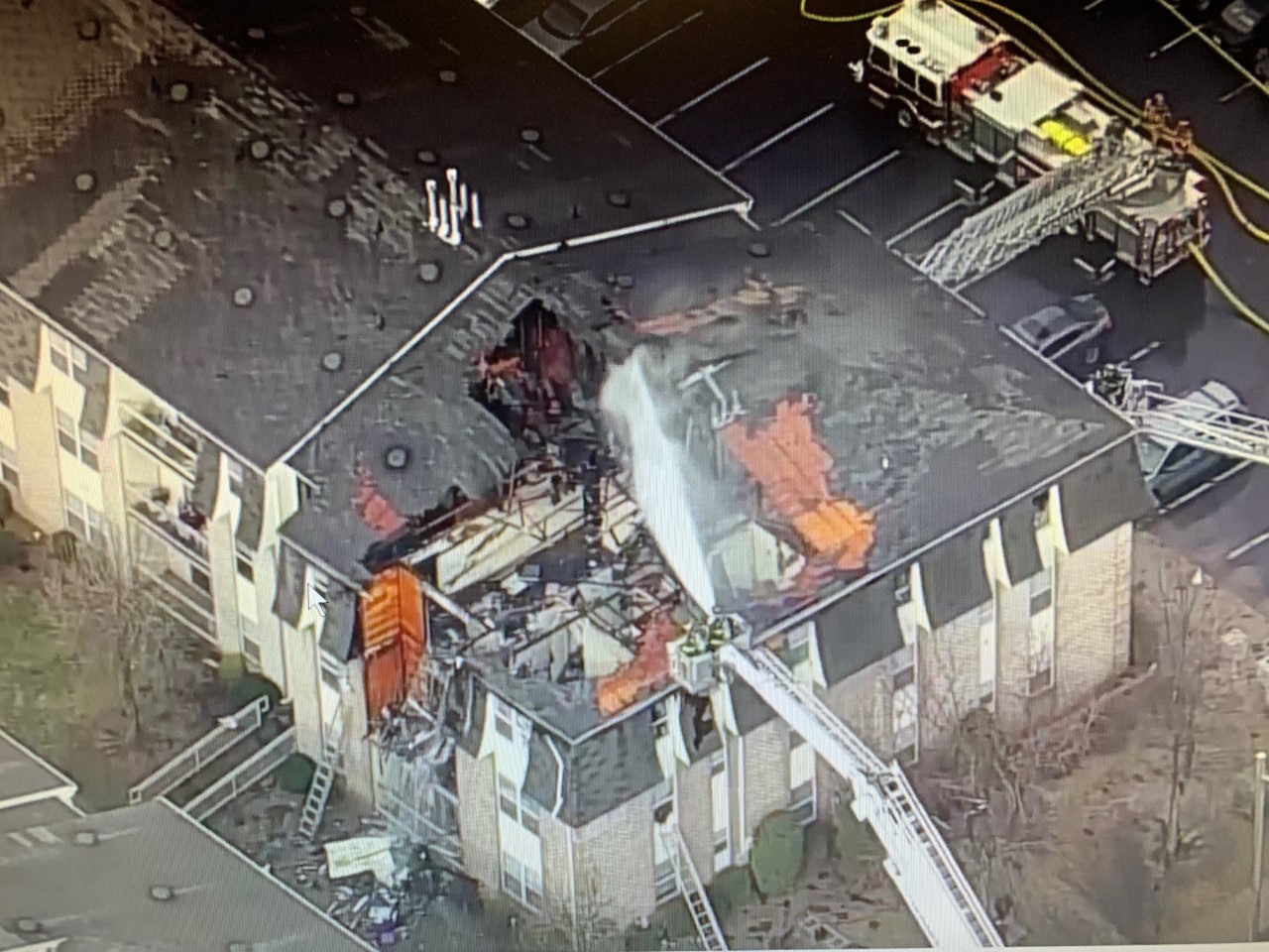

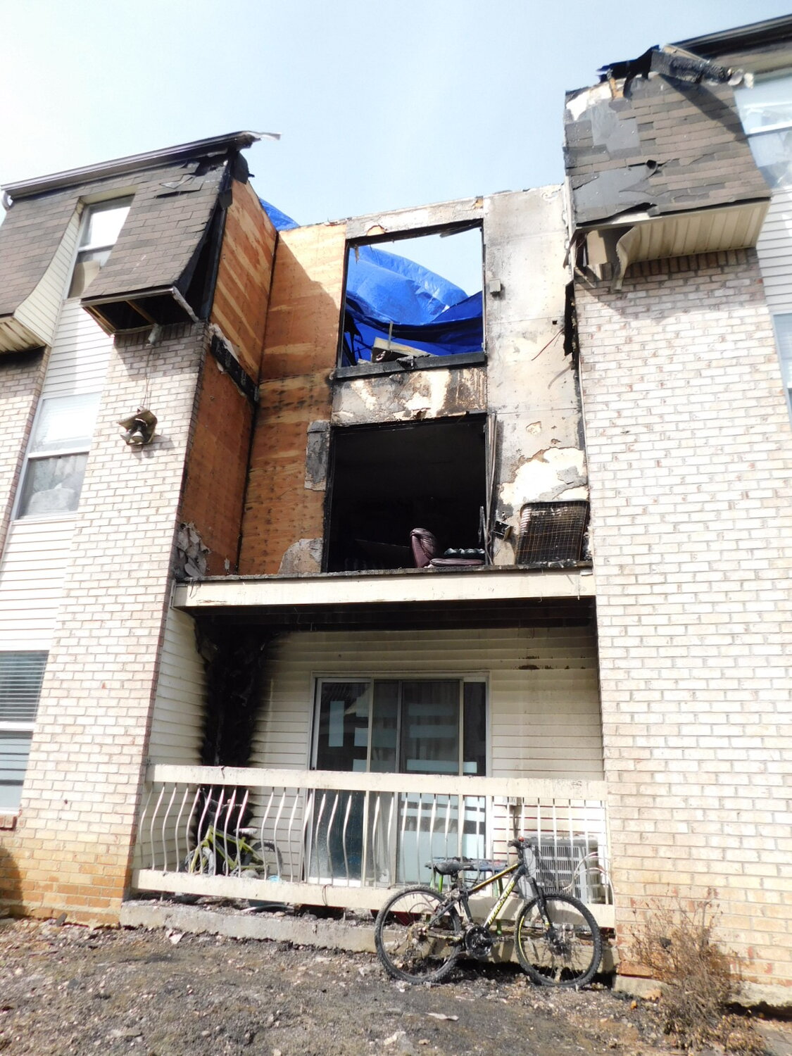

Good ideas but not foolproof. An apartment building where my brother lives nearly burned down from an e-bike charging on a balcony.
As a result, e-bikes are not permitted anywhere in the buildings. My brother has to run an extension cord out his window and charge in the trunk of his car. He stores his bike on the balcony and keeps the battery in his car.
