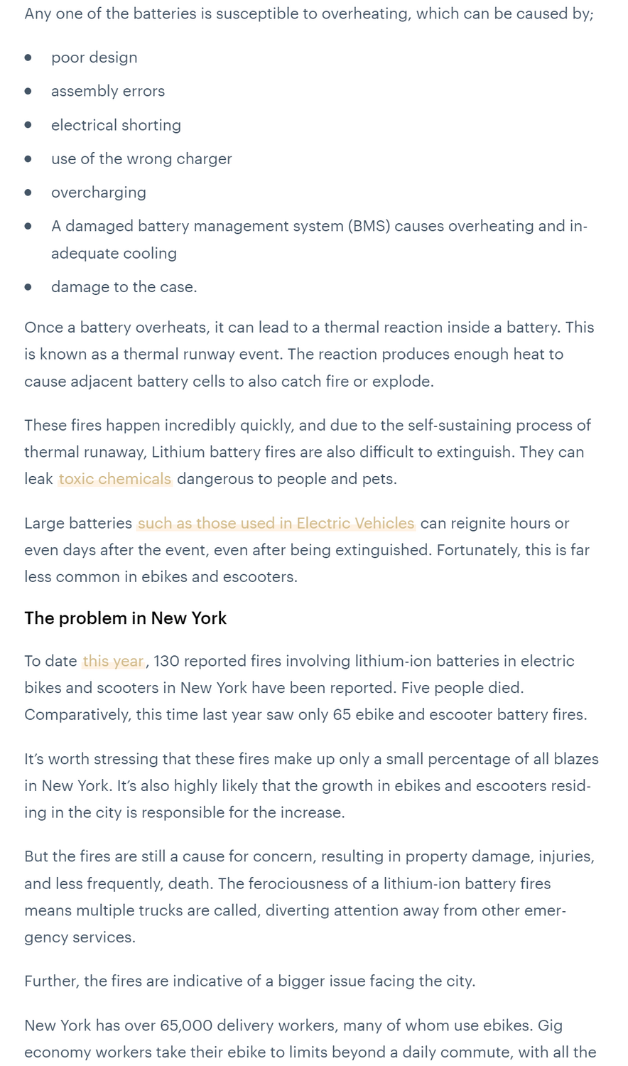

My thoughts are you plagiarized the article, word for word in a place where it was not immediately obvious what you were doing. Further, you snipped out only the portion that supports your agenda and ignored the remainder which contradicts your conclusions. In fact, anyone who actually reads the article will see it is talking about something else entirely. This exact sort of deceptive practice is something you have been caught at in the past. Originally it seemed you were just sloppy and inattentive. Now that a pattern is forming though, this appears to be deliberate; perhaps banking on short attention spans and an inherent belief of people that the well-spoken person is not being disingenuous.
You didn't even bother to correct the errors (psst... its "thermal runaway" not "thermal runway"). I have copied the post in its entirety above in case the OP revises it as he has in the past when caught out like this.
At bottom I have copied a screen shot of your plagiarized section, plus some of what you didn't copy, which starts to go off in that entirely different direction than you want to. If people are so inclined, I encourage them to read what was actually being written about. It is not what the OP is talking about at all. And remember this happened. Again.
