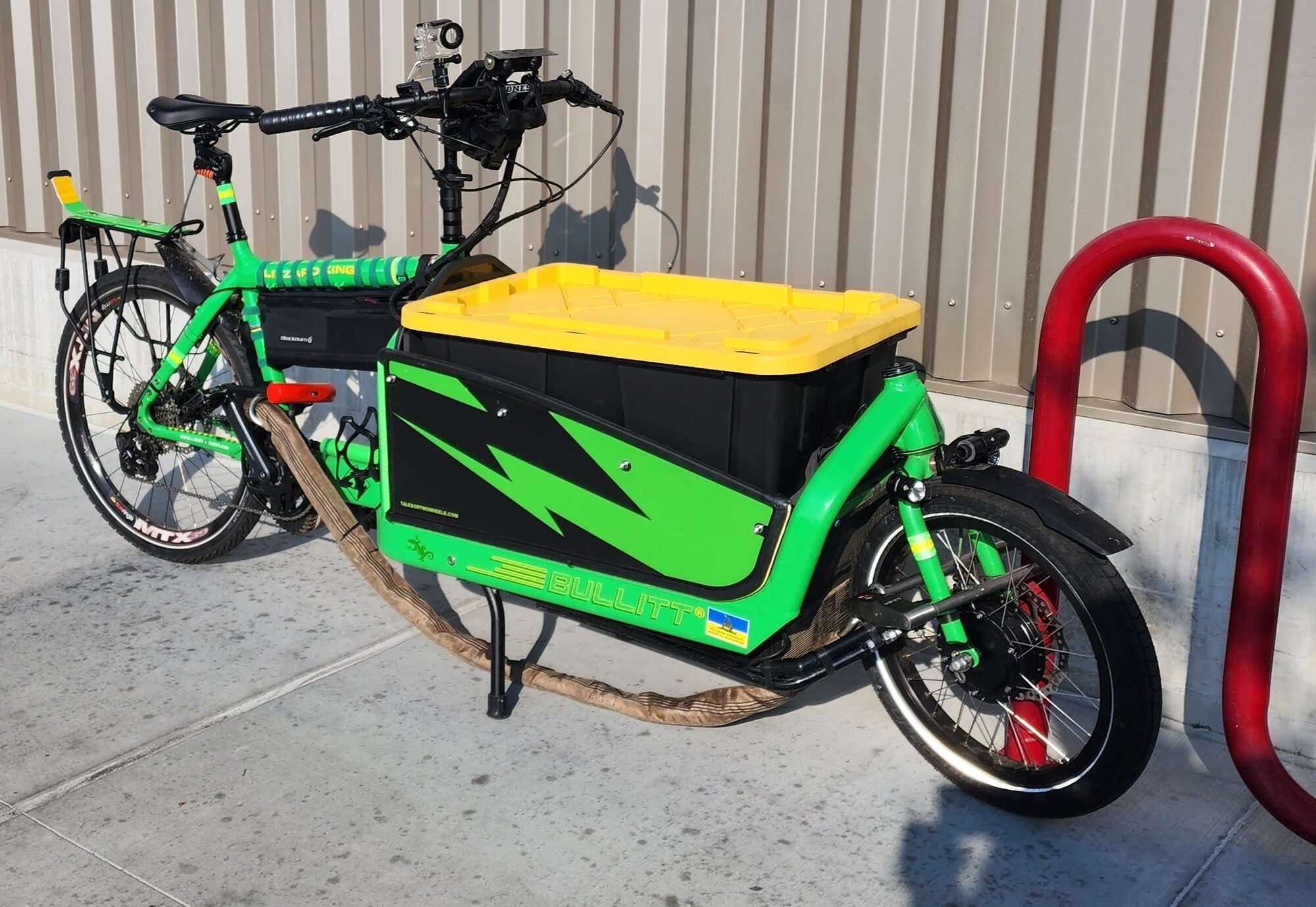

There isn't much in the way of thermal management involved when the battery is living in a hot environment and it is just flat out going to match ambient temperature. Check this pic out:
That is me parked at Costco in Clovis CA in the summer (my insurance kicks in if the bike is locked to a secure object, so I take pictures at every stop). The bike has been parked in the sun, right next to a steel wall, for about a half hour. The wall is radiating heat, and so is the sun down on the bike, but the battery is under the floor. So the real risk is the heat radiating up from the concrete. I keep a temperature sensor at the top of the pack inside that sub-floor box and when its parked in the sun I can see temps in the box of up to 105 after I come back out after my shopping trip. On the way home, I do my best on the bike path to roll over shaded areas and this is good for about a 5-degree temperature reduction inside the battery box. Look closely and you can see some heat sinks just behind the front wheel that are on three sides of the box and are good for about 3 degrees temp reduction while moving thru even hot air.
Since I have a temp sensor I use in real time, and I *know* how hot that pack gets, I don't shop mid-day. I will commute in 110-degree heat, but I won't park a bike outside in it.

That is an awesome bike. If I lived in a town where most needs were met within a 15-mile radius, I'd give that a go. Even when I was a daily commuter of 34 miles, I still couldn't get to everything I needed. Worse now because the only grocery store within reach, closed down a few years ago. How much does all that security weigh?
