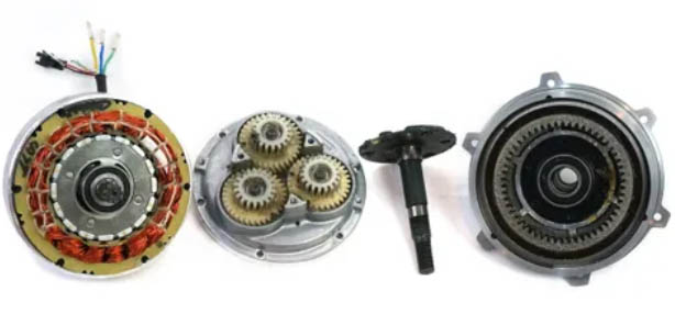

Well, we've got some bafang motors on our bikes, but our highest mileage is on some no name 250W hubs, over 4000 mile on each. It's not like there's a lot of new technology in a hubmotor. They can make them for under $50 USD. Now your mid motors are more complicated, but that's mostly the gear train, and more bearings,
Is 4000 miles on a gear hub motor considered acceptable product life cycle? What is it about the ebike industry that can't seem to get past the mindset that bike are only for recreation / leisure riding and should not be more "transportation-grade?" If the ebike industry is really ever going to be considered a viable replacement for a car or at least capable of getting people out of cars for some transportation needs they need to engineer ebikes to have much higher duty cycles and life cycles. I should be able to buy an ebike that can last 20,000 miles without having to replace the motor and drive system components many times. Oh, I'm sure their are industry bean counters thinking I just don't understand business and it's about re-occurring income from planned obsolescence that matters. Well maybe not everyone like getting screwed like that by this mindset.
Product longevity is a trade-off, especially powered equipment. You want longer service life? It will cost much more, try and be heavier too. Just look at the cost of pro grade power tools vs consumer grade, and their weight (unless you pay a huge premium for light weight...)
