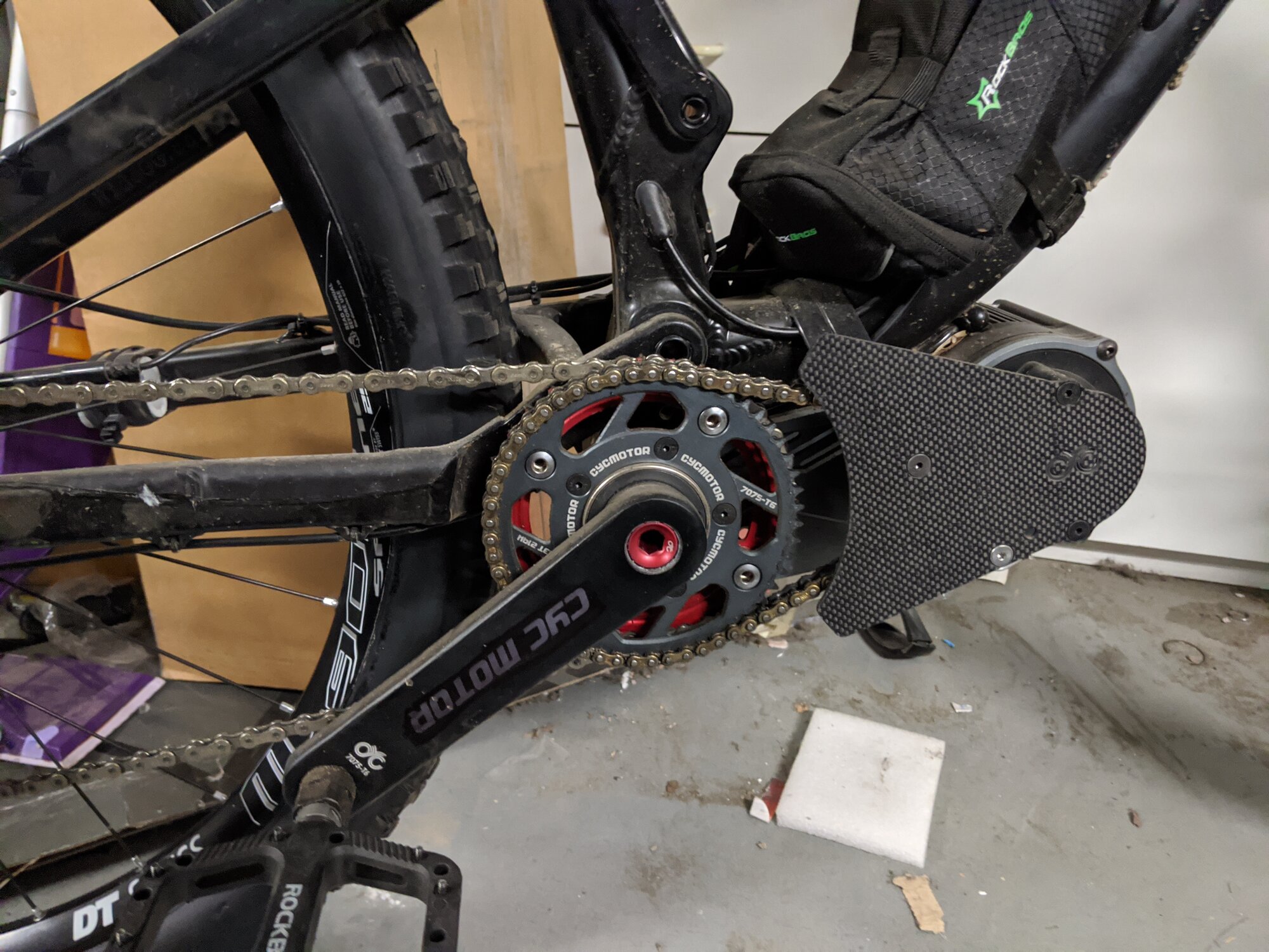

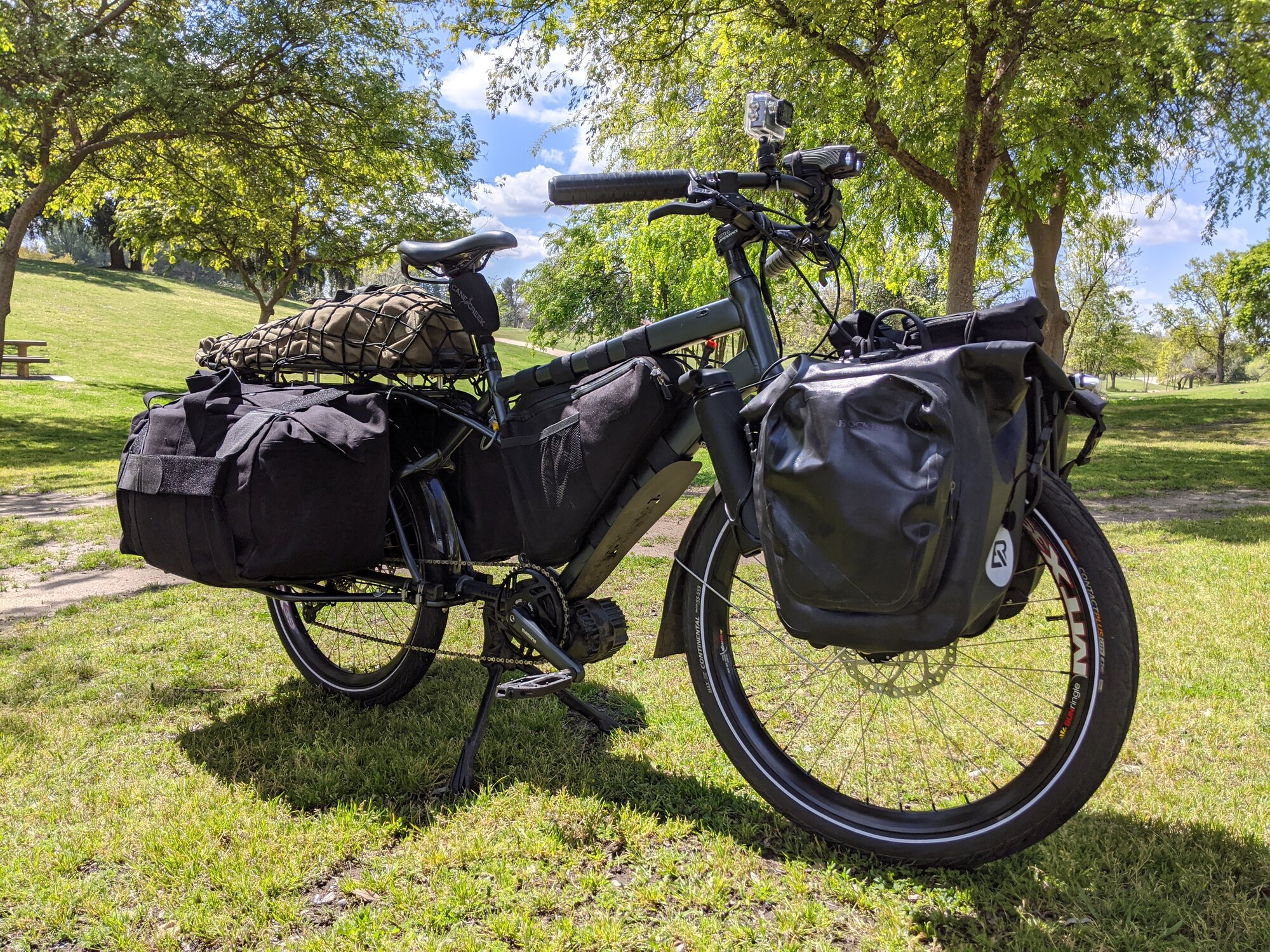

Well, in addition to us all riding differently, and thus there being no wrong answers, I'll point out that when I'm riding a cargo bike in the Monterey Bay area, where its all hills and I just changed my drivetrain to a much bigger rear cluster (from 32T max to 46T) because I needed it to do the thing I'm talking about: Maintain cadence up a hill. Its a different cargo bike and that one is set up to pump out a fair bit more power on PAS. Probably around 1000w with cadence probably being about 60 (remember it could be loaded with stuff). And that chain is (I forget exactly) in the 160-175-link range (my BFD is over 200). A power surge rather than a gear change in that scenario is not something I'm so sanguine about, although I certainly do peg the throttle if I think I need it.My point exactly. Turning up the power 1 or 2 PAS levels (as an option to downshifting) will still leave you with plenty of reserves, without tearing anything up or creating unusual wear, while maintaining your original speed and cadence level.
In fact, I've found this a really good option at low speeds/high loads to prevent stalling the bike with a missed shift.....
However, my Cyc-powered bike is in that same town and that sucker is 4kw with a 216 kart chain as its primary, leading to a second sprocket heading out back on a SRAM EX1 chain. That level of power... No way is a power surge a good idea there unless its on one of the biggest cogs, and that one goes up to 48T although I can only go to the 40T next-to-largest. Worth noting, thats also a SRAM EX1 (tool steel) cluster and its only an 8 speed. Since I can't get to the tallest gear reliably (chain line + front cog size = no go) I have a 7-speed. I don't like it one bit. The jumps between gears are too much along all the lines I have been going over above. So, I have some experience with this next-level power stuff and also with lesser gear counts like what y'all are saying you like.
