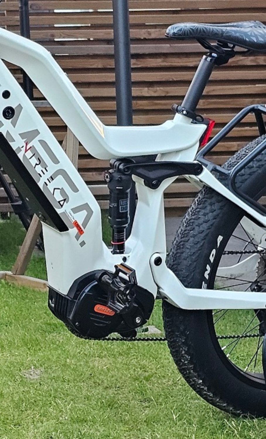

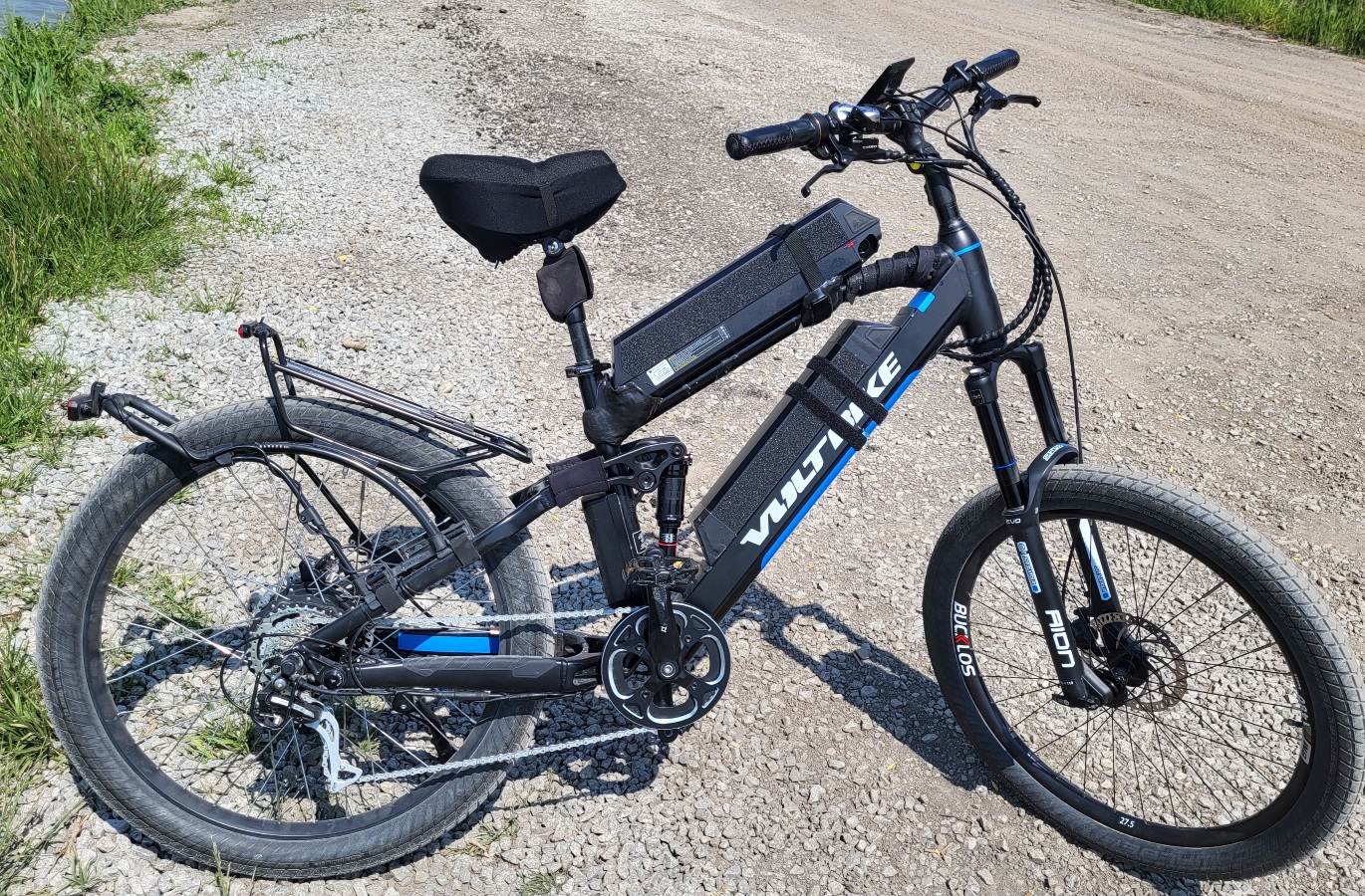

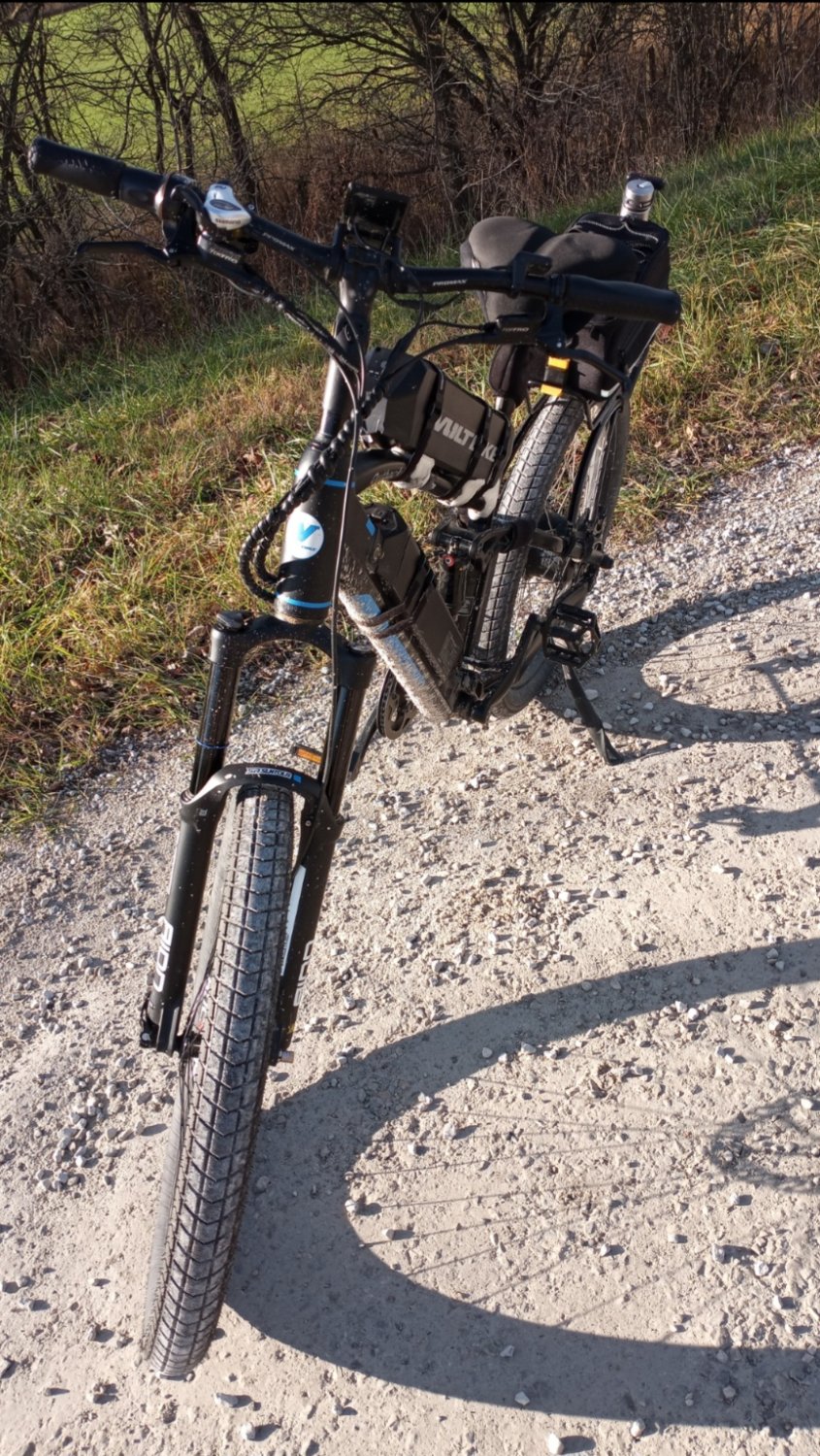

Just joined the e-bike world - wow!

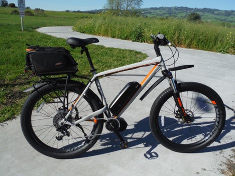

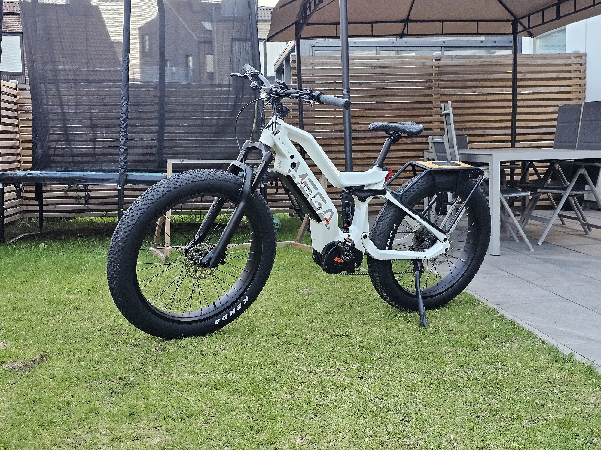

Nice. Agree on the plush ride of a dual suspension ebike. That Bafang motor is a perfect match for the fatty. I have the same motor in my Frey Beast emtb.

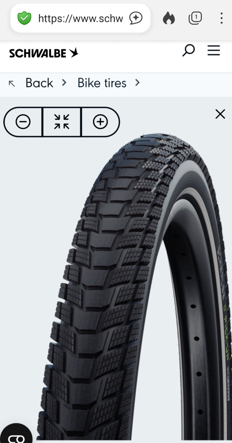

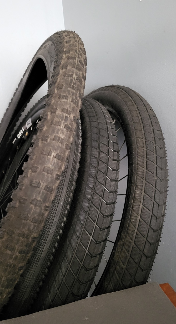

You might want to consider 26" X 2.4" Super Moto-X tires as a compromise ?
They'll fit up to 70mm wide rims.
The lower rolling resistance should make a measurable difference in your MPG, and your Beast looks Hungry !!?? 😀
Will save that info for the future, cheers
Do you also experience cog slipping when giving it everything you got on the highest gear and highest PAS at the same time? I've read similar complaints about the M620 in that situation.
If I'm being honest that level of effort is not really sustainable for more than a couple hundred meters at a time, and the speed at those levels is kinda scary so it's only when I have a fully empty and long straight and want to break my top speed record that I "need" to combine all of the above, but I'm just that guy that wants his stuff to work as it should despite using it or not.
I got some recommendations already to adjust the derailleur which I did by following the advice for regular bikes, not sure if strong mid-drives need a different fine tuning though, I tried to close the pully/cog gap by adjusting the B-screw, nothing really changed.
Checked the hanger and looks straight at least to the naked eye.
Cleaned the chain and sprockets thoroughly, still no effect.
I then removed two chain links and on the first ride no slipping occurred and new top speed achieved, I thought "I got it!" Then strangely, on the following rides and top speed runs the slipping somehow came back?!
It's got a 9-speed ALIVIO so no Tourney but also nothing special either. Next in line are a new hanger and a hanger extender, before I splash the cash for a new gearset (current one only has 400km on it)
Open to more ideas to try before dropping money...

Look into a Box 4 eight group set. It is very strong and has a powerful clutch. If you are using the smallest/fastest cog regularly, then get a larger narrow/wide chainring to still have the same speed while using a cog with more teeth and with less ware.
Dude,.. Seriously, How long are your crank arms ???
WTF Have you gots goin on here ??,..
Maybe 2" long cank arms instead 1" long would help ??
What you have is a moped.
Same as I have,..
But my pedals and entire crank system are entirely functional.
Good for you for your generous input to your torque converting cranks for recognizing that you were helping 👍 👌
With your ENORMOUS Crank arm/Pedal clearance, you could easily lose an inch or so for a more street oriented tire.

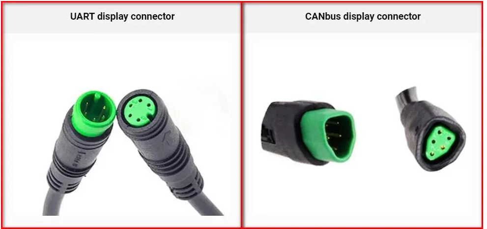

Also... Do you know which version of the M620 you have? UART or CANbus?
Reason being that the UART version is end user tune'ble and you can tweak each PAS as you like as well as smooth out the acceleration curve if need be.
Easiest way to tell is to look at the display connector
Nobby tires at high speed don't have very good traction with asphalt.
Street treaded tires off-road are 👍 but sometimes you fall over,..
I would much rather take a on-road treaded vehicle off-road, than take an off-road vehicle on the road.
In fact it wasn't even legal for my dirt bike.
I needed to install trail tires to be legal AND SAFE On pavement,..
It doesn't matter how much motor or braking power you have, it all boils down to the tire contact with the road/trail/path whatever.
Tires Are Critical.
Especially with High Power
My full suspension Fat e-bike came with Kenda nobby tires.
I switched them out for Shwalbe Super Moto-X after the first test ride.

I concur... I hated the Schwalbe Johnny Watt tires on pavement... they broke traction way too easily.
My current Schwalbe Al Grounder are an SUV tire that is more pavement oriented but still work well enough off road (for me).
Very smooth and quiet on pavement.
Super moto (X) don't have any off road rating....
ymmv

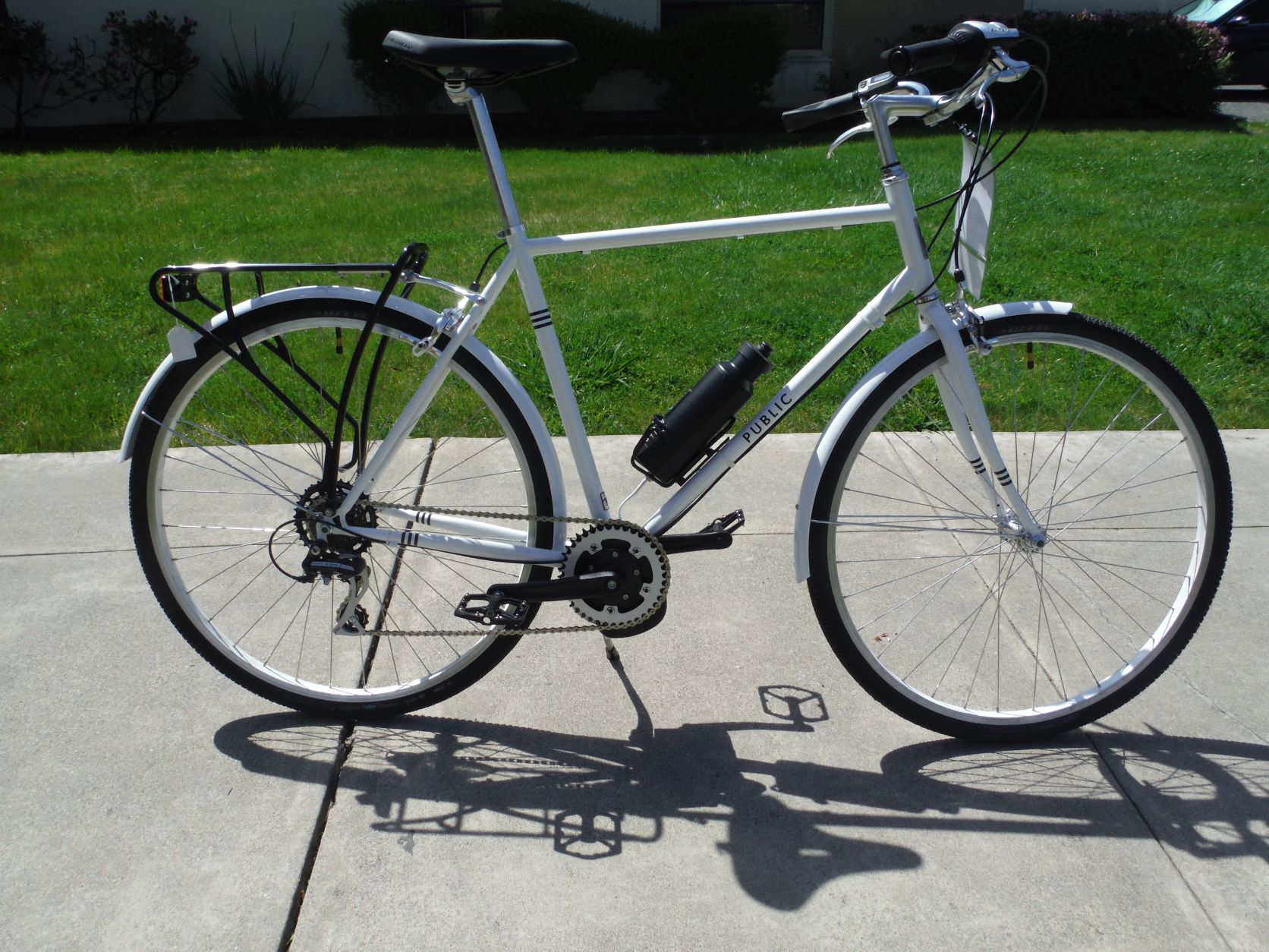

This is my second bike build. It was 2018 and a Bafang BBS02. Look at the weird chain stay. I loved those tires. It was only my second build so I didn't have the clean and light thing down yet. I did race and beat a 350 pounder on a Harley with it to the next light. Those engines are powerful but they need revs. That bike had torque off the line. I pulled up to him at the head of a red light and said 'Nice bike. Want to race to the next light.' He just laughed at me.

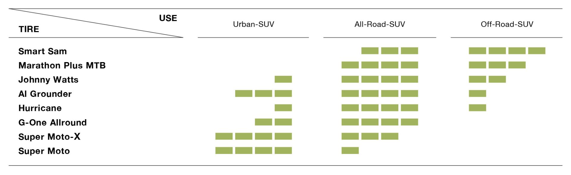

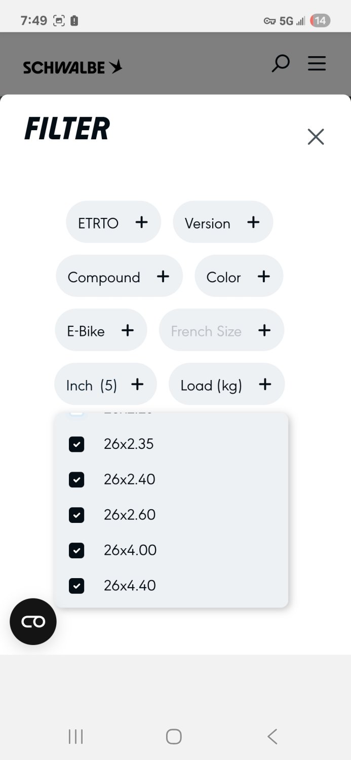

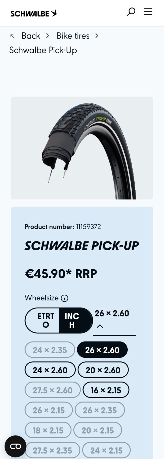

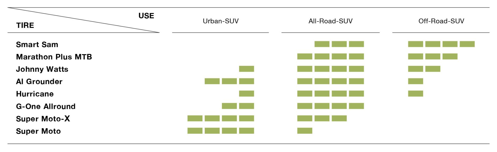

I was having a hard time finding a 26" Shwalbe fat-tire, but I found this,..

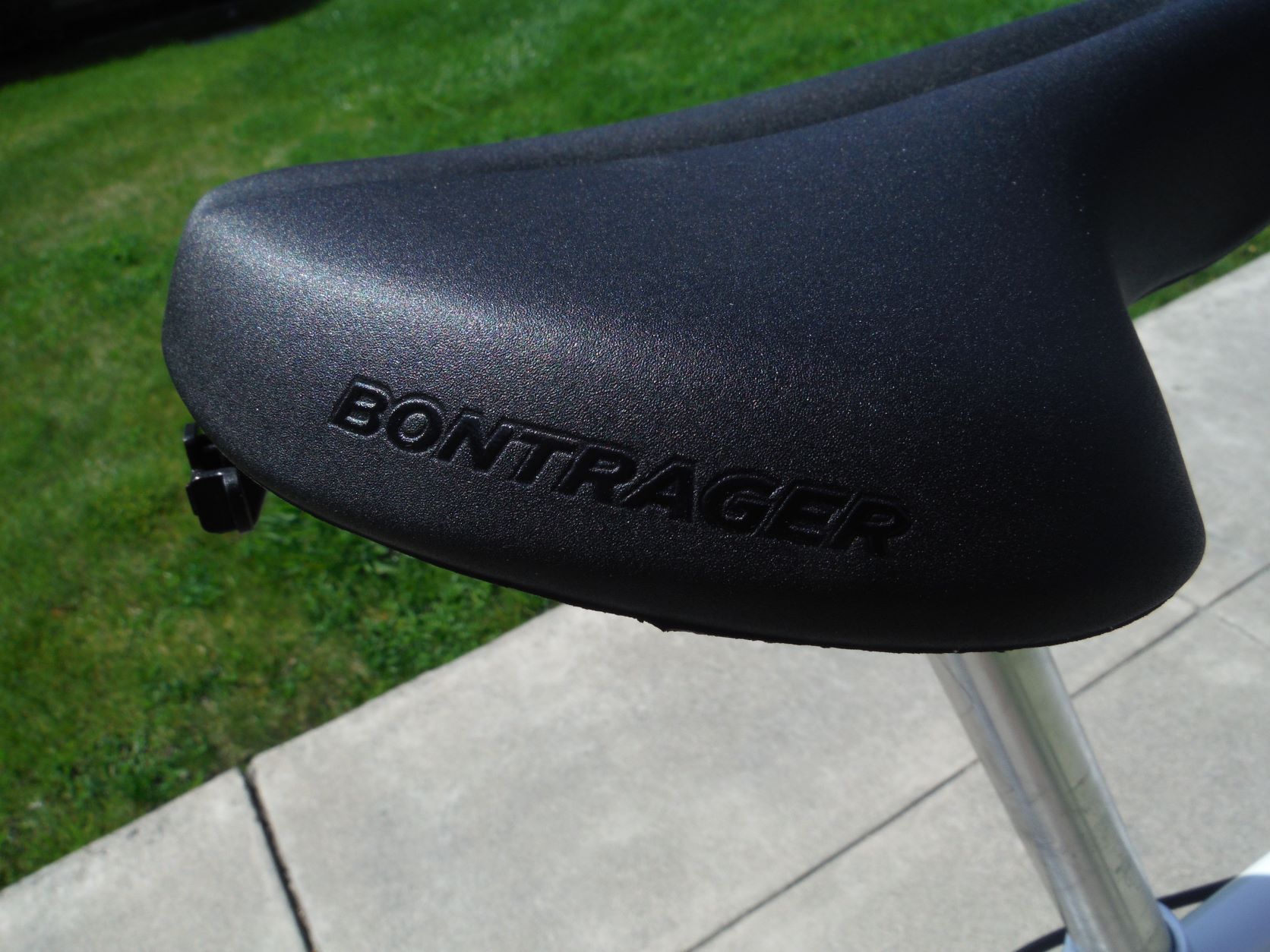

I couldn't last ten minutes on that seat
The cargo PickUp's kicks butt. My friend Natalie has those on her heavy cargo kid hauler bike. For over three years she has never had a flat and it still does not need a rotation swap. They still look new. 90% of her trips in town, like dropping off kids and shopping are on that converted steel Mundo.
That saddle only looks like torture from the side. It is the most comfortable I have ridden. It is a Bontrager. Supper soft and Flexi with the air vent in the middle. It is a wide-ass saddle. The thing at the back in the middle, sticking out is for clipping on a rear Bontrager light. It is nine inches wide, the circumference of my rooster.

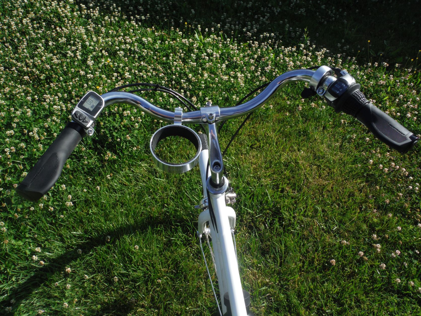

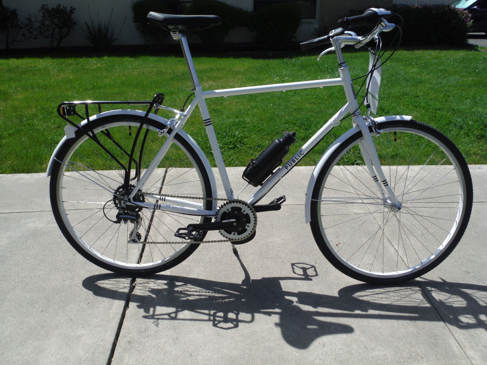

Here is a H-Bar wire check on that white bike. And to double check for any ugly connectors or fatness. Those masts on boats are ten miles away from that hill's top. The top mast is thirty-feet tall and 100 yards away. It is a big hill and Gracie, a friend, did it to the top riding an SL Vado I sold her. It is just over 2000 feet and sometimes it even snows for half-a-day up there.in January before it melts, so we can look at a distance and admire the beauty of distant snow a for half-a-day about every ten-years. I like looking at snow each decade for half-a-day as long as it is ten miles away.
