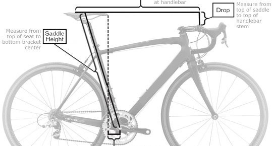

There are 3 basic riding positions when cycling:
  1. Sport - Handlebars lower than the saddle - (drop)
  2. Neutral - Handlebars even with the saddle - (flat)
  3. Comfort - Handlebars higher than the saddle - (rise)
Great summary with one minor correction. Hope this helps. ;)
Selle Royal names the three positions: Athletic (45°), Moderate (60°), and Relaxed (90°). They even do not differentiate the forward position from the road-cycling one. Not that I disagree with you.
P.S. Sorry for editing.
No worries... here are the full range of positions: Comfort, Relaxed, Neutral, Athletic, Triathlete!
The height of the handlebar relative to the saddle decreases along with the angle of attack. ;)

I used to run my 1994 MTB with the bars 5 inches below the saddle (stack of 515mm), I also used a 130mm stem (considered short at the time) and 550mm straight bars with bar ends that made the bar more like 500mm. I now run the bars even with the saddle (125mm more (accomplished with newer fork with longer headtube and 50mm of spacers, 700mm 50mm rise bar and a shorter 80mm stem)). Older MTBs had lower stack height than todays bikes.
Adding 125mm to a newer geometry bike with higher stack height would be ludicrous IMHO. My newer geometry bikes now have a stack height of 600 to 660mm.
They are often frowned upon, but I opted for an adjustable stem riser. Not only did it raise the handlebars, it brought them rearward a bit, decreasing both hand numbness and reach and lower back pain.
One of the Amazon comments regarding any fear of movement of the adjustable stem riser while in use:
The inner portion of the linkage is what's known as a rosette surface. Basically, a bunch of interlocking "V's". The result is that once it's tightened down it doesn't budge.
I also added a Metropolis handlebar, which also improved comfort (by decreasing reach and relaxing hand position) immensely:
I’m riding mostly roads and rail trails on my fat e bike, and I’ve read neither of these options may be appropriate for aggressive eMTB riding.
I need to add some extra info. Some e-bikes (and Specialized ones are a good example) have the display mounted on a custom stem, and might have stem integrated headlight. Replacing or rotating the stem is impractical in such case, leaving the stem riser as the only option.
