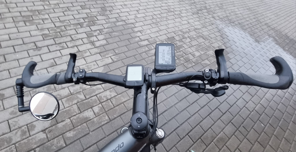

Now, let us say you want to keep your existing handlebar grips and just go with the Innerbarends 411. Bear in mind each 411 will take up 21 mm at each side of your bars. The Innerbarend needs to be mounted as close to the brake lever mount as possible. Measure. Plan. Consider possible issues. Be conservative with your estimates. Prepare for the worst case.

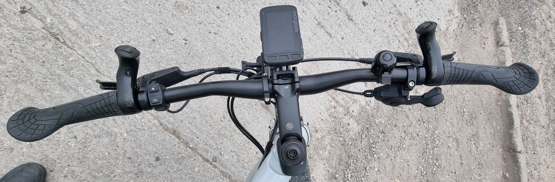

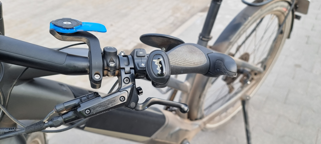

Innerbarends 411 with Ergon GP2
Installing Innerbarends 411 with Ergon GP2 grips on my Vado 5.0 was complicated, and it required some compromise. For example, the handlebar remote has to be located between the Innerbarend and the brake-lever mount. I needed to substantially trim the left hand side grip to ensure the fit. Now, my hand barely fits on the Ergon! (No issue for me, which I will explain later). I also had to remove the bell on the other side of the bars, or my hand could not hold on the Innerbarend (but I have got a horn button on the other side).

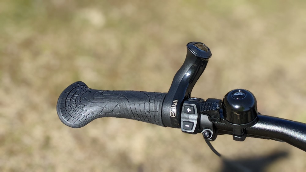

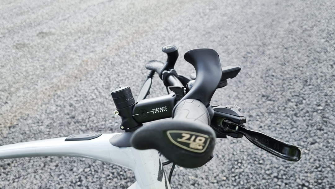

Innerbarends 410/402 with SQlab grip 710 size Small
Can you see how wide the 710 size Small + 410/402 combo is? I could barely mount the combo without relocating other handlebar objects!

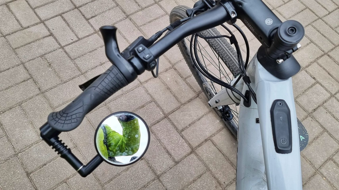

Installing the mirror required drilling a hole in the SQlab grip.

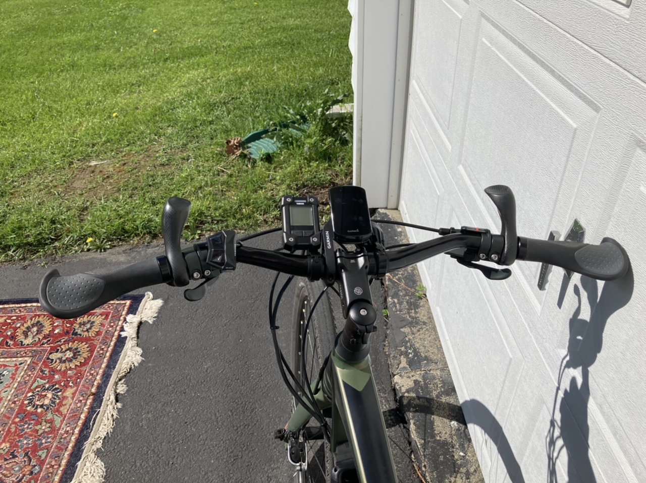

Thanks for this @Stefan Mikes ... I've just ordered the 710/402/410 combination for my Vado SL. I didn't have a printer so downloaded the PDF sizing chart from the SQlab website, scaled it to the correct size on my screen (it has a helpful centimetre scale on the right hand side of the page), and put my hand on the screen. I apparently need the medium sized grip, so we'll see how much handlebar space remains after fitting them. Fortunately, I have nothing else cluttering the bars.
Oh, you have.
  • Left brake lever
  • Handlebar remote
  • Bell
  • Shifter with Optical Gear Indicator (the latter takes up a lot of space)
  • Right brake lever.
Fortunately, there seems to be enough free space on the bars to mount the bigger combo anyway.

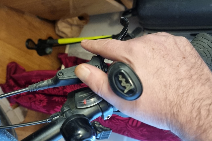

I have noticed one thing after several days of riding in the Innerbarends on my Vado SL. I managed to rotate the inner bar ends too much forward:
I made the part indicated by the arrows oriented horizontal. (It was wrong).
By doing so, I made the bigger part of my body weight resting on these "hoods", which made my hands hurt (I did it properly with the previous incarnation of Innerbarends). Now, I need to re-orientate the "hoods" the way these will be more vertical. This, however, will mean brake lever orientation adjustment, too. (As you hold on the "hoods", your fingers need to be able to operate brake levers with full confidence).
P.S. With my current (fixed) setup, the flat part is oriented at an angle (like, 45-60 deg), and the grip part is almost vertical. (The intention is to "push" the grips not "lean" on them).

I ordered and fitted the 410/402 innerbarends and the medium 710 grips. For anyone who reads @Stefan Mikes comments above regarding the space these take on the bars ... don't worry ;). For the medium size grips and the innerbarends I had to move the 'other stuff' (brake levers, assist controller and gear lever) no more than 1mm. I loosened them all off, added the grips and innerbarends and then moved the 'other stuff' back flush with the inside edge of the innerbarends. You do have to move the various levers as the bolt to tighten the 410/402's in place is obscured by the brake levers, so these have to be rotated slightly out of the way to give the torque wrench access.
I've only ridden a quick 25 km using them this afternoon. First impressions are very positive. The 710 grips are very comfortable (much more so than the stock 'ergo'-type grips provided with my Vado SL 5.0) and the size - determined from the SQlab sizing sheet - was spot on. The innerbarends provide a very welcome alternative to the horizontal grips. When using the innerbarends access to the brakes - for all but the most forceful "grip and pray" braking - is good. Access to the gears or the assist controller isn't really practical though it might just be possible to drop a gear. More importantly - as I see the innerbarends as being used on parts of the track that don't need lots of changes - when gripped your hands don't foul the assist controller or gears.
Enjoy :)

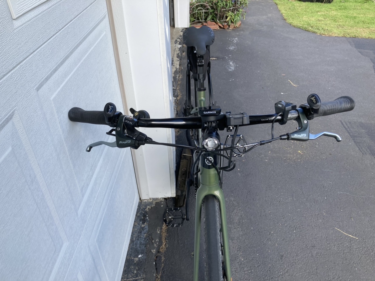

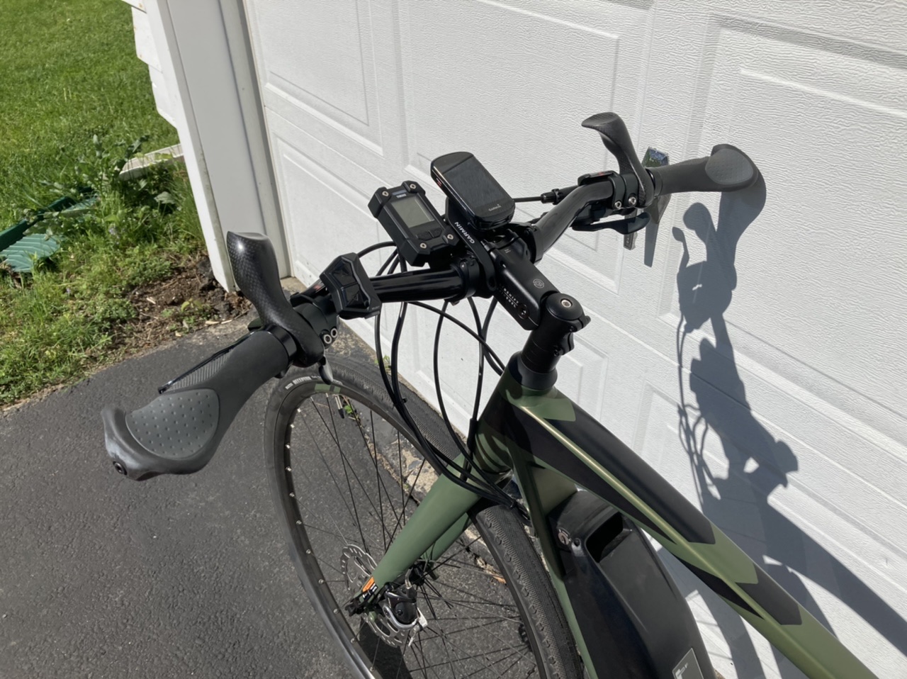

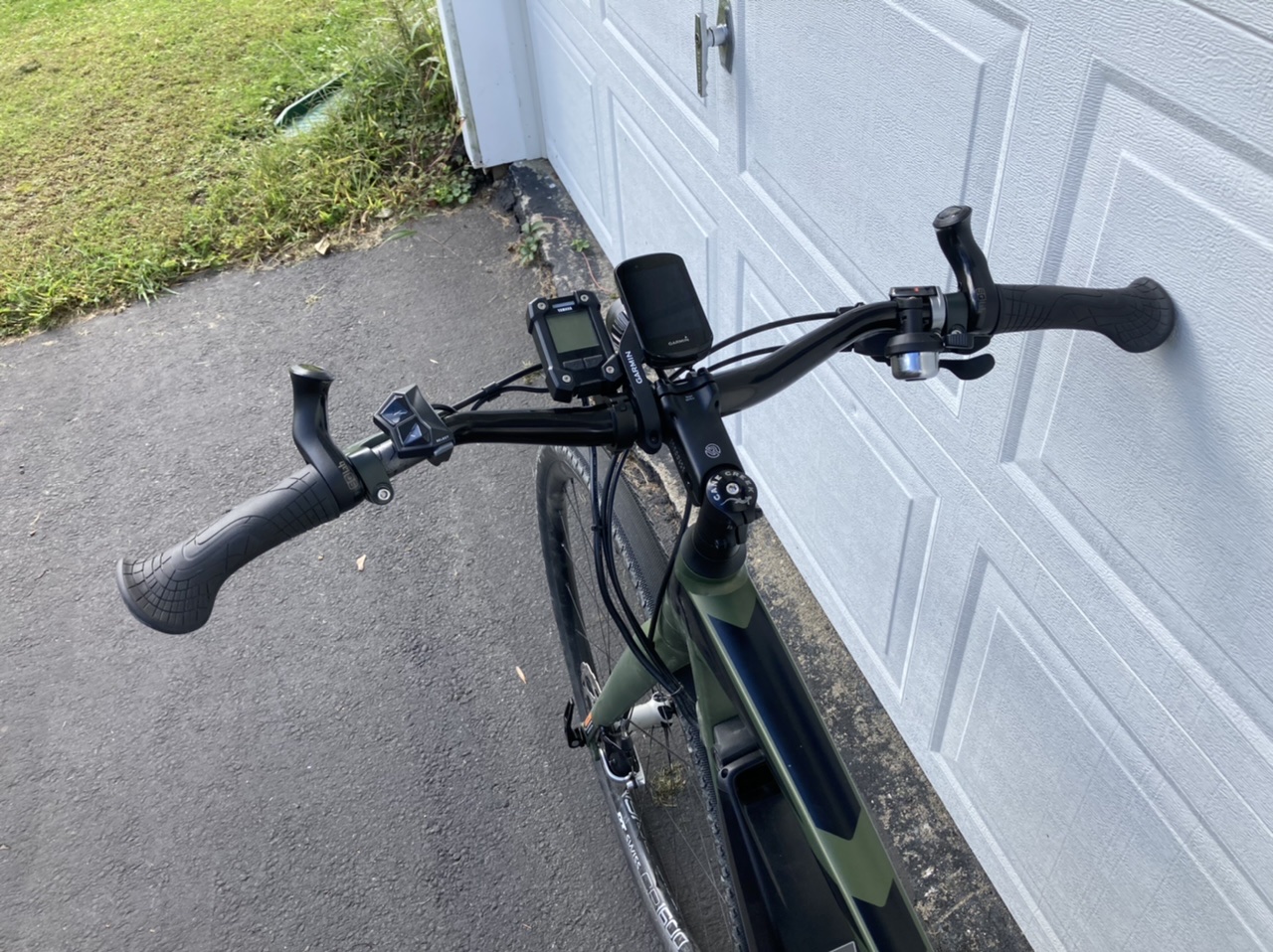

I have no experience with the SQ Labs inner bar ends or grips, but I have a similar setup on my bike. I use the stock, Yamaha grips which I find to be very good, (so far). My inner bar ends are an old pair of Specialized Carbon bar ends. I removed the graphics and polished them up. They provide a couple alternative hand positions and I find them very comfortable and efficient. My Cross Core is set up for road, (paved or gravel), and rail trail riding.
I highly recommend the inner bar end concept and the SQ Labs products look like a great option.
I am a long time roadie and mountain biker, so this set up is the best of both worlds for me and great for my damaged legs and spine, (motorcycle accident). I’m loving the ebike, but not ready to give up my carbon Wilier just yet.
I can also drop my elbows and get quite aero. I did have to move things around, but everything worked out well on the 710mm wide Salsa 17 degree Bend Deluxe bars.

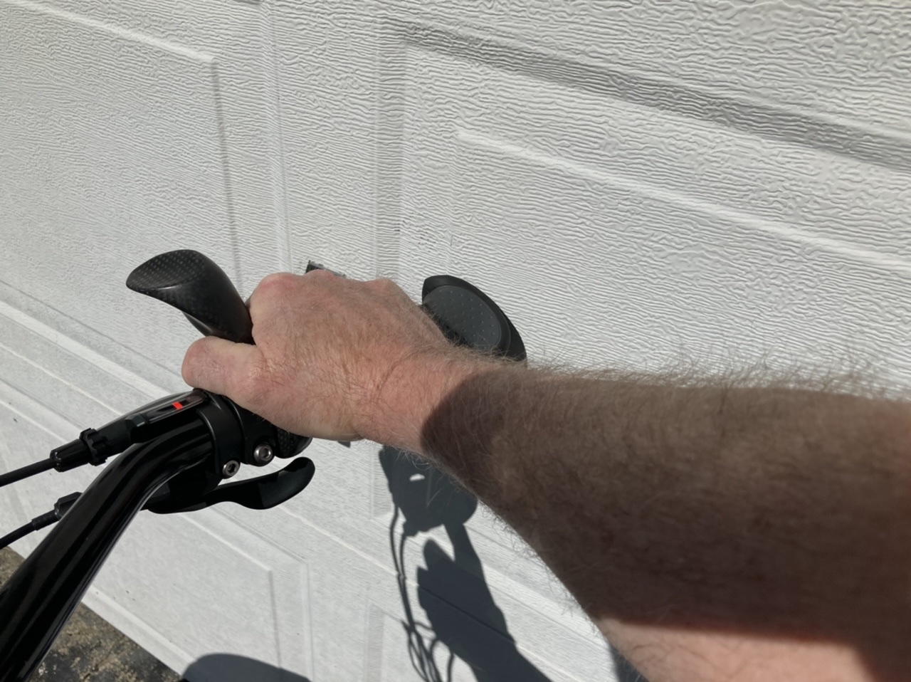

I decided to try the SQLab inner bar ends. I wanted to get a few rides in before saying what I thought. They don’t provide as many hand positions as the Specialized bar ends that I had been using, but they are fit nicely with my SQLab grips and they are very comfortable and still provide a good, alternative hand position while not taking up additional room on my bars. The verdict is that they are staying and that I like them very much.
how does one use the brakes with hands on these guys?
You rest the part of your hand between your thumb and the index finger on the IBE the way you do it on the hood of your road bike. The edge of the palm rests on the handlebar grip, and the fingers may rest delicately on the brake lever or keep the handlebar grip. The access to the brake levers is as instantaneous as with a drop handlebar!

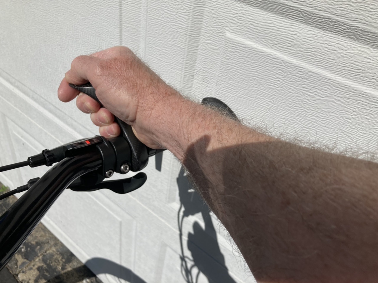

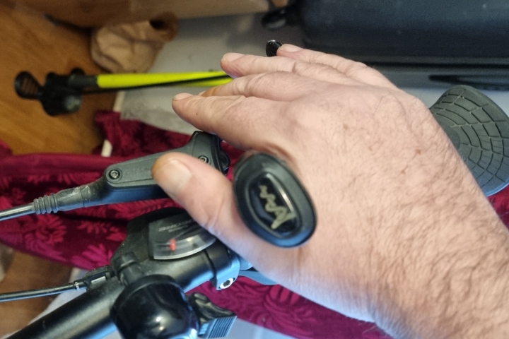

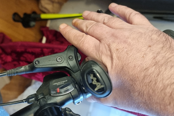

A Shimano or SRAM shifter? (Mine's Shimano).
Normal ride. Four fingers resting on the brake, the palm supported on the grip.
Upshifting. The middle finger pulling the shifter lever.
Downshifting. The thumb pressing the shifter lever.
In no situation I have to remove my hand from the position. I understand each of us is different and one size does not fit all :)

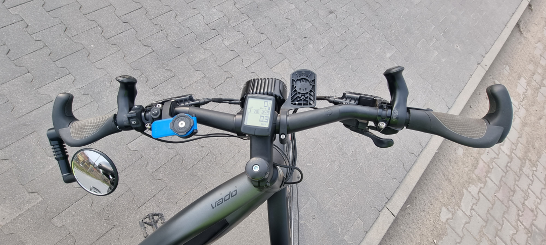

Keeping the thread going, I just got Innerbarends 411 2.0 thanks to Stephan‘s frequent recommendations. As with the other commenters descriptions, they make a terrific difference in my riding comfort. Though I still need to tweak their positioning a bit, I too rode with my hands mostly on the IBEs.
When you wrote your post @BEC111, I didn't even know what the 411 ver 2.0 meant! Recently, I wanted to tighten an older model of the 411 on the bar of my Vado 6.0 without the torque wrench, and broke both the screw and the IBE! So I visited the SQlab site and just ordered the latest 411 2.0. I actually was not aware what product I was buying! :)
The 411 2.0 susprised me with their extremely low weight, being narrow, beautiful and skin friendly. It is probably the ultimate IBE version. Not sure what it is made of (carbon fibre?) but the material feels warm and grippy to the touch (other IBE versions are hard, slippery and cold, and are the best used with cycling gloves). The 411 2.0 are hollow inside, and have no rear, so they solely serve the intended purpose of a hand rest (you cannot grab this grip).
As to the setup, I have found my ideal setting is when the cut in the IBE clamp is just horizontal. The matching angle of my brake levers is when the mounting screw's head is horizontal.
No more tweaking! Going for a second 411 2.0 ride!

Innerbarends 411 2.0 on my Roadrunner (Vado 6.0) during a test ride of yesterday. This morning, I did the last tweaking of the Innerbarends.
Your cockpit looks almost identical to mine. Same mirror, TCD, IBE and Grips with horns. I just have a phone holder - no cycling computer. My left hand grip and so forth still needs adjusting. My left shoulder and hand have been sore and I’ve been fiddling with fit. I don’t ride in bad weather so opportunities to test fit have been a challenge. Guess it’s a sign of old age 😉
