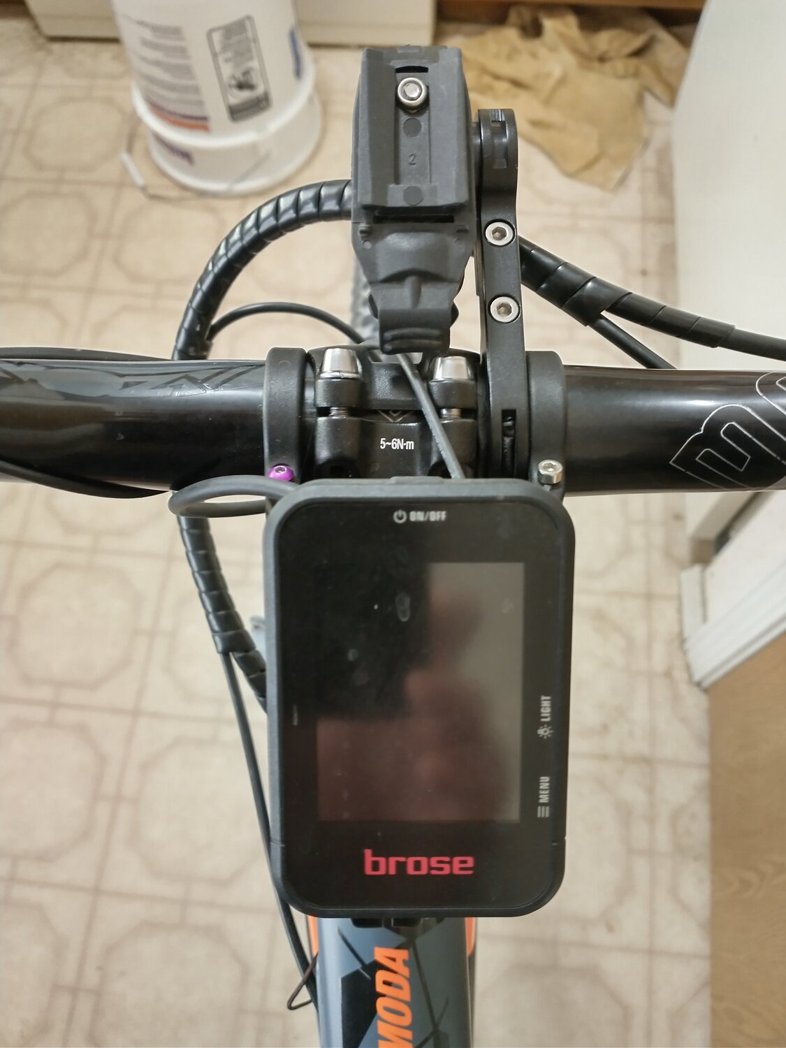

Good point. I ran into something similar on my iZIP Moda E3 with large brose display. When I went to a high rise stem with the stock bars, the display stuck out in the open and seemed vulnerable to getting damaged. The cable to the display were also not long enough and would have likely been damaged/broken in a crash so using a stem rise wouldnt have worked either. I was able to cure it with a higher rise 50mm handlebar.

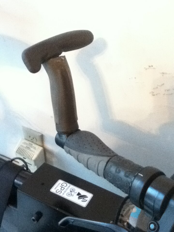

I just came back from a trial ride with modified bar ends with a four piece adaption that I simply love.
I used to get sour shoulders and neck muscles with the flat bars so I added a short bar end in reverse position (up instead of forward) which allows me to sit up more.
Well the ends of the bars were not comfortable on my hands so I attached an ergonomic additional end on top of the first bar end. Now when I ride I can lean into the grip and it actually relieves tension in the neck and shoulders ! Simply amazing! Total cost...$14

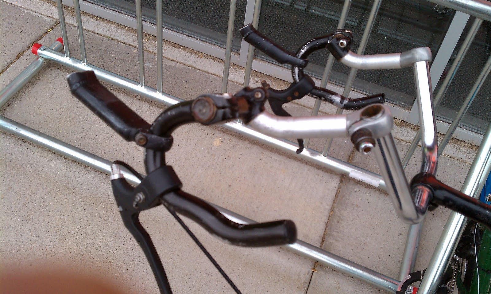

Reminds me a bit of this... o_O

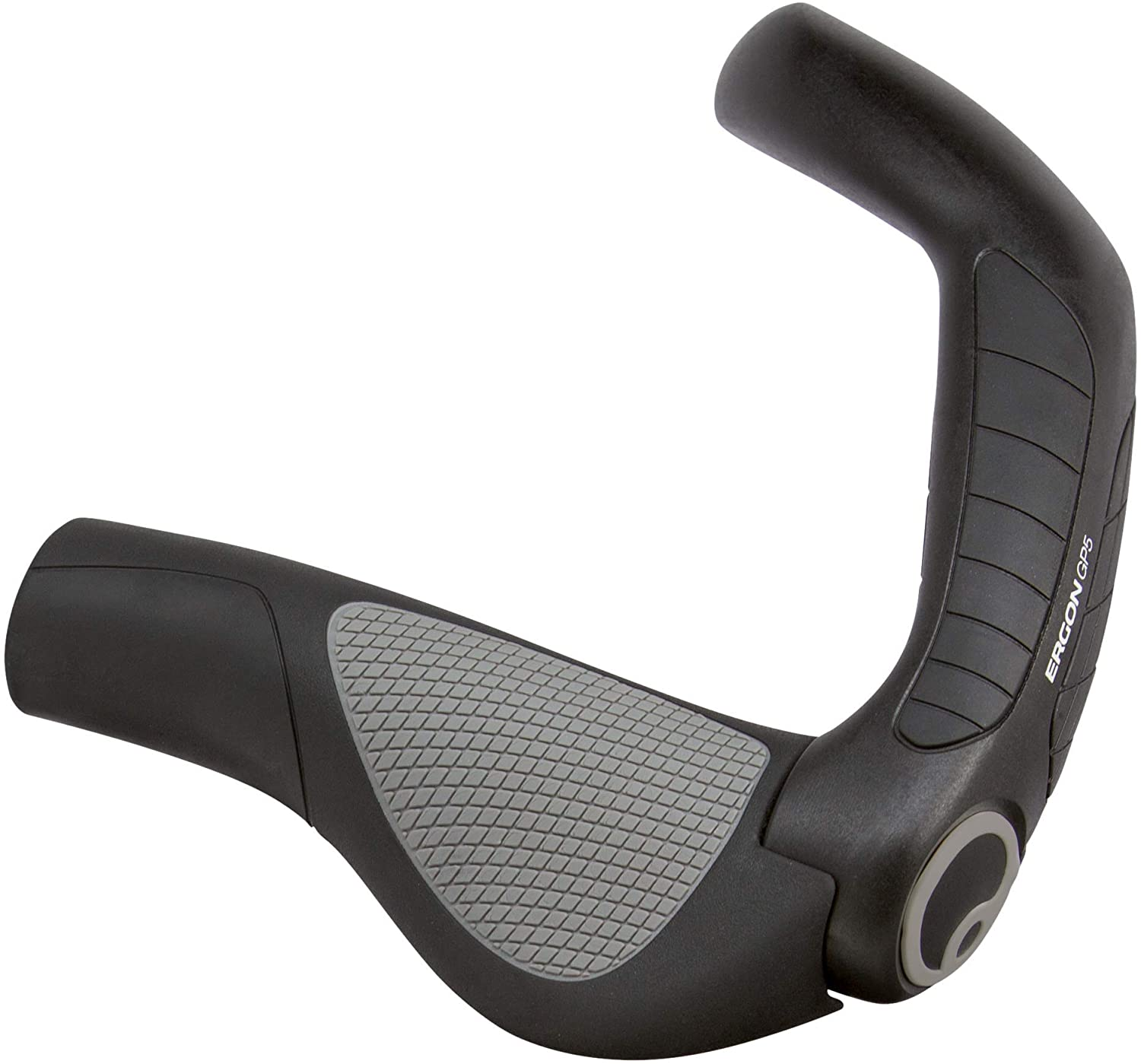

You may want to try out the Ergon GP5 grips shown below. ;)
I actually did see these Ergons and many others, but I needed to shift my weight back, not forward.
These other, extremely ugly bars you post🦨👎, look nothing like mine.
My extension are pointing back, towards the seat and actually allow me to lean back so far that my shoulders are behind my hips and still have a comfortable grip.
I originally thought to put a different set of handlebars on, but that would require me to re place the brake and shift cables as they were too short. Not to mention the considerable work of re mounting the grips brakes and shifters and other mounts on the bars. On the other hand my bar ends took a total of 15 min and look absolutely beautiful,🌷👍 (I have received many complements and imitators.)
