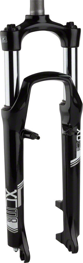

I have a major problem, in that I want to replace my 2009 Montague rigid fork for general purpose riding suspension fork.
The spec's for the replacement fork are:
1-1/8" x 26 tpi, (threaded)
spring type,
"V" type brakes,
26" wheel size.
Some of the ones I am looking at are:
(1st choice)
SR Suntour XCM 1 1/8" Threaded Suspension Fork, 180mm Steerer Length
PART NUM 409073
(2nd choice)
SR Suntour XCM Suspension Fork: 26", 1-1/8" Threaded Steerer, 100mm Travel, Linear Pull and Disc, Black, PART NUM 292827
RST Capa-T 26" Suspension Fork - 1-1/8" Threaded Steerer
PART NUM 687093
RST Capa-T 26" Suspension Fork, 1-1/8", 250/50mm, QR9, 80mm, Black
PART NUM 382444
SR Suntour XCM HLO Suspension Fork: 26", 1-1/8" Threadless Steerer, 100mm Travel, 100x9mm, Linear Pull and Disc, Black
PART NUM 235272
I have found several that will fit EXCEPT for this major problem,
I have a 1/8" key way running from the top of the fork, down several inches
thru the threaded area, to an unknown.
Why this keyway is there is unknown to me.
There are NO threaded forks that have this key way?
Is there a work around for this key way?
Can a nonthreaded fork be threaded to1-1/8" x 26 tpi, and still work on this bike??
Your thoughts or suggestions...

I have this suspension fork coming for the new bike,
SR SUNTOUR FORK SRST 26 XCM COIL 1-1/8 180/55 QR9 M-BK DISC/CANTI 2013 SF13-XCM- V3 26
SR SUNTOUR
SKU: 10-28376
$117.10

Thank you for that information, I finally found a suspension fork that will fit this new bike, just waiting for it to get here.
10-28376
This fork has all the required spec's to fit this bike, plus I can add disc brakes which I plan to do, as soon as the rat hole funds catch up with the spending funds. lol
