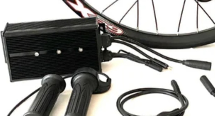

My current hypothesis is that my controller is square wave instead of sine. I was looking for a plug and play replacement online with a sinewave controller but didn't find anything yet.
I am hoping some direct drive experts
I'm no expert, but I think that your hypothesis is right.
I know that square wave controllers are noisier than sine wave for both the controller and motor.
When I had my firing order reversed on my geared hub motor, the noise sounded very mechanical, much like the sound of your motor.

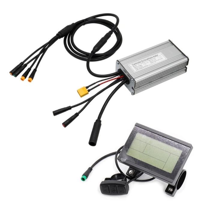

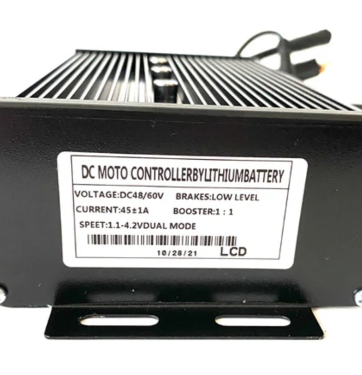

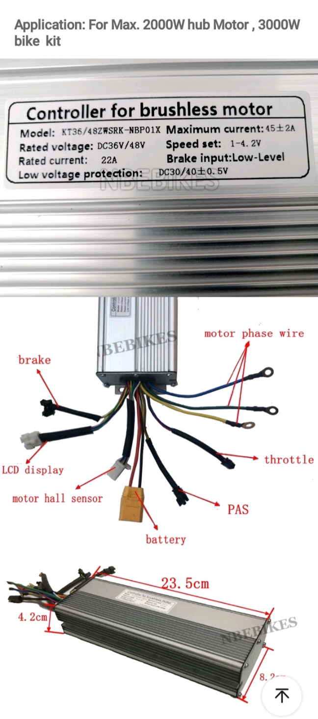

The web site says it's a sine wave controller.
Looking at the controller, it looks like a POS. 😂

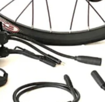

It's simply not large enough to be a 45 amp controller.

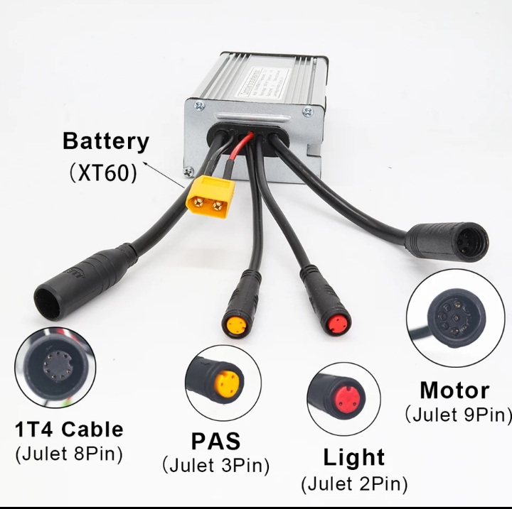

This is a real 45 amp KT controller,..
This is the 30 amp KT version,..
Notice the extra large motor cable connector. Anything over 25 Amps has the bigger plug so that it doesn't melt.
Your motor connector cable looks like it has a 25 amp connector?

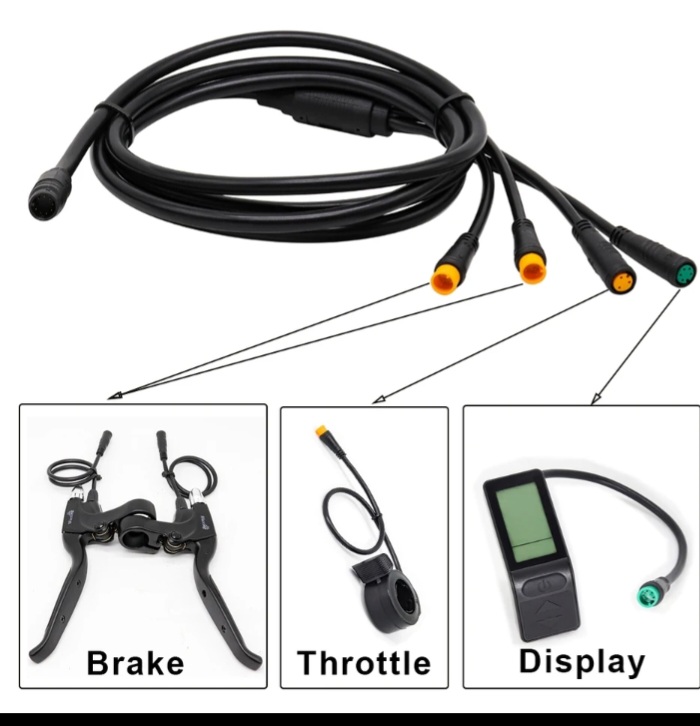

I think that you should buy a complete 25 amp sinewave KT-Conversion kit for about $250 and it will plug and play.
It will replace everything except your rear hub motor. (even the brake cut-off switches are different with three pin instead of two. Yellow vs Red connector)
A hub motor cable connector only has a few standardized configurations.
Your hub motor should plug into and work with just about any controller if the plug fits.
There's always 9 pins. (10 if you have a temperature sensor output. Very rare.)

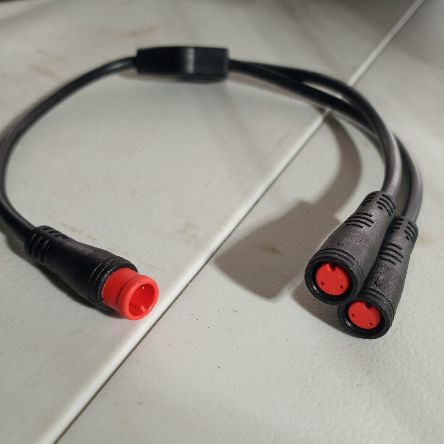

Or a Red-to-Yellow/Yellow-to-Red interconnector could fit the bill for the cutout levers.

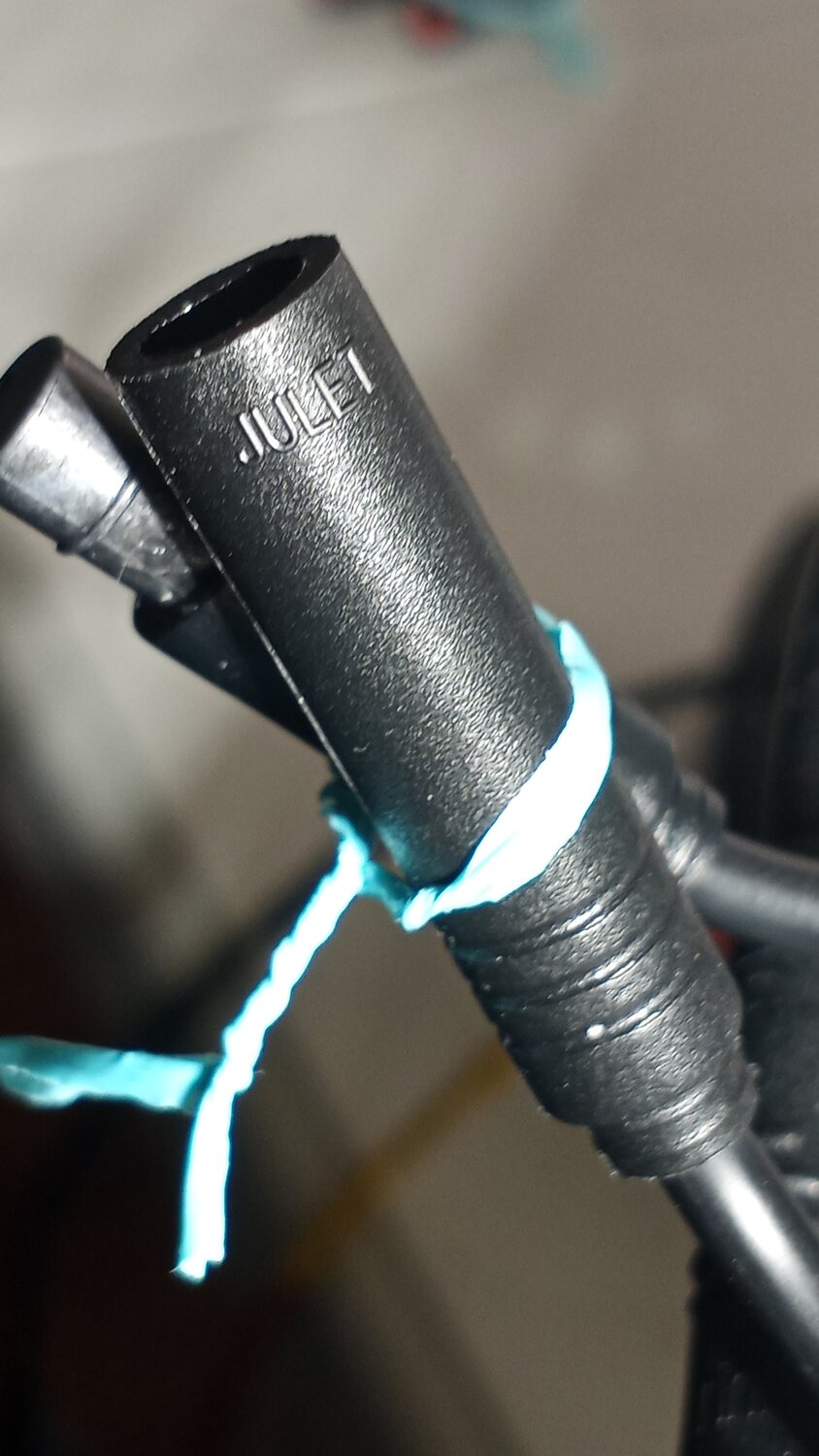

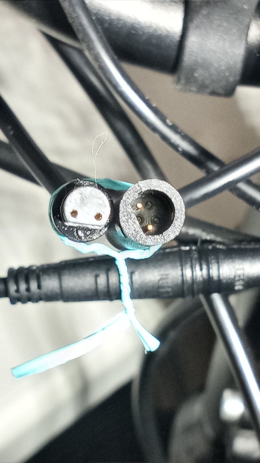

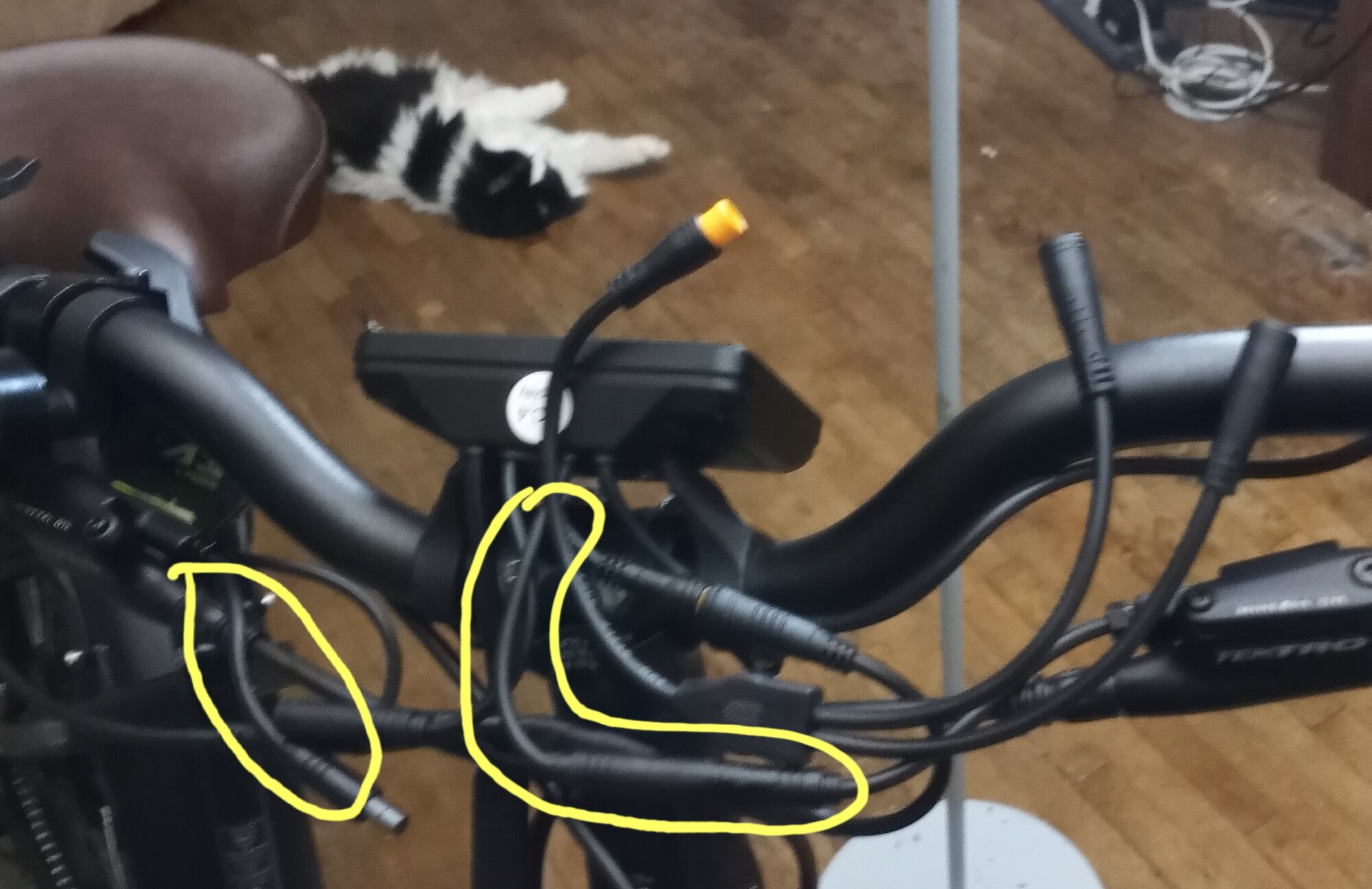

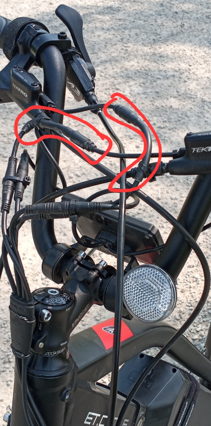

I couldn't find the convertor and didn't want the extra 6", so I cut, soldered, and reconnected everything after I figured out the pin configuration,..
If you could find an interconnector for my Julet/Tektro brake cut-off switch connector,. that would be Great !!
