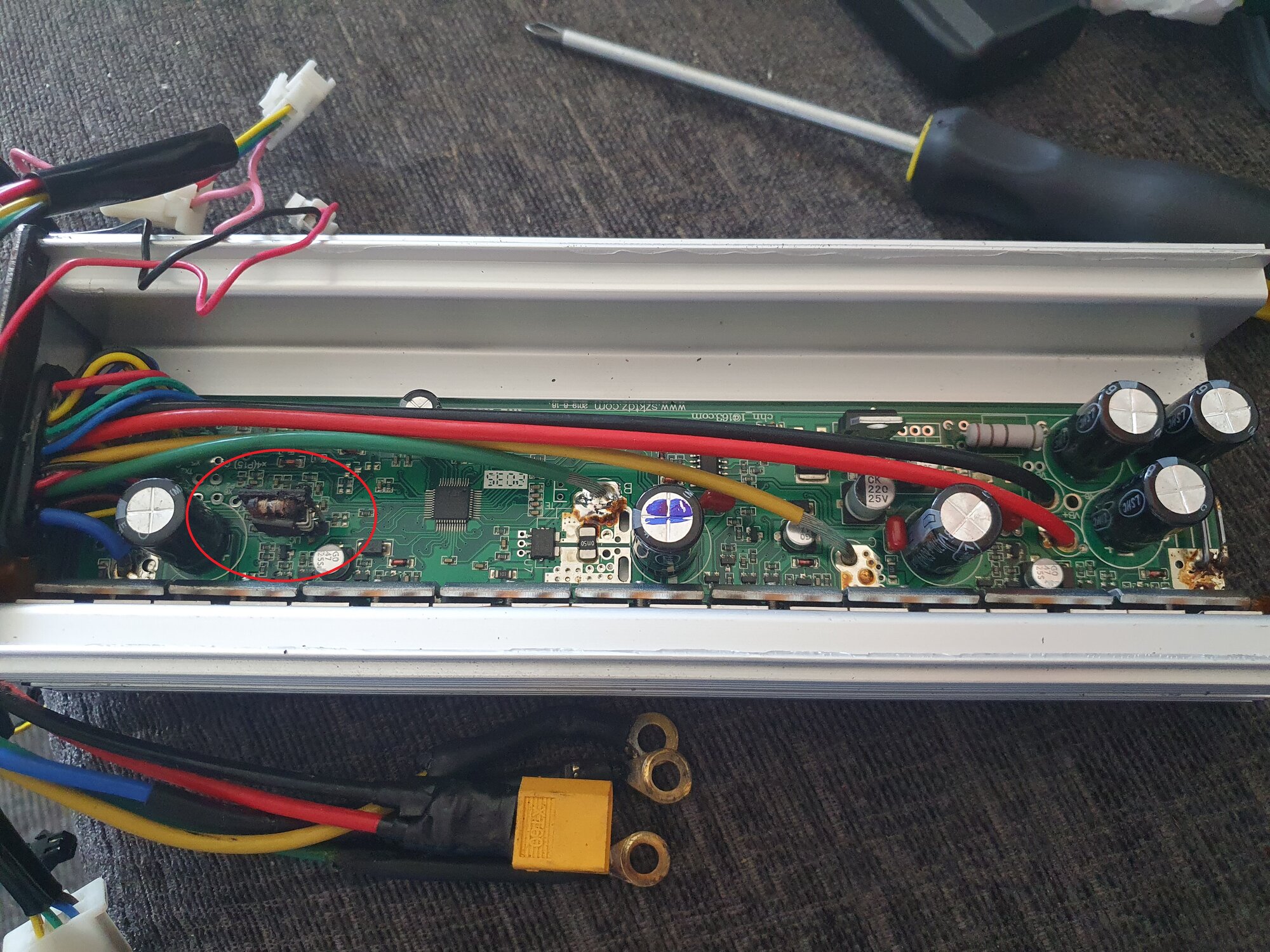

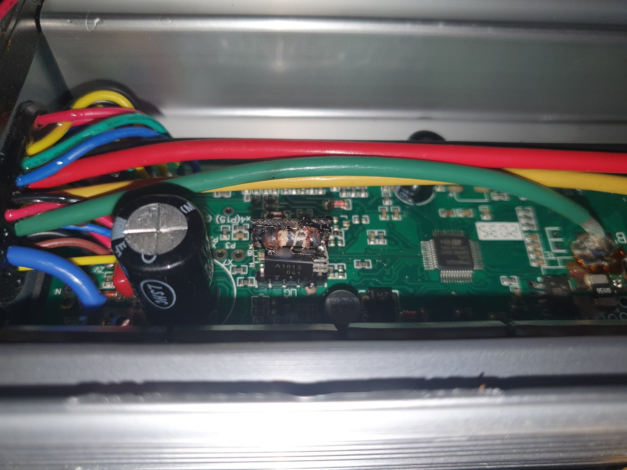

Thanks to all that took the time to read my post. I have found the problem! Something has burned out inside the controller as shown in the images below. Looks like I am going to have to replace the entire controller. It's a shame as I am more than capable of replacing the part if I knew where to purchase it. It's a resistor but is attached to a seperate board which looks to be damaged also. I can see the part number on the chip attached: A1013041. As explained above it is a KT 45A+2A controller. If anyone knows where I can purchase a replacement part to fix this controller it would be strongly appreciated if you could let me know!

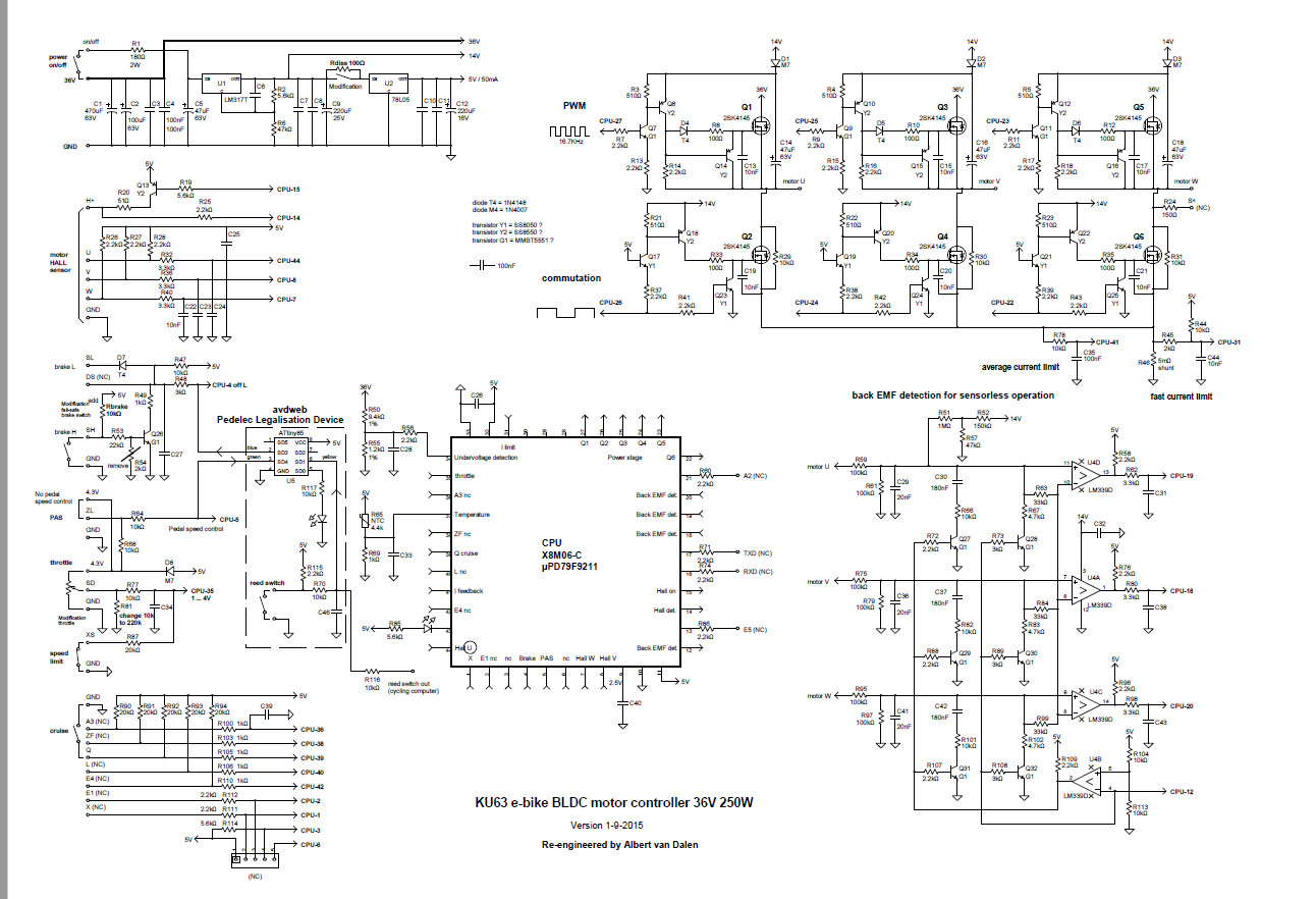

As shown on the top left corner of this schematic for their S06S controller, KT often uses a 2W 1800-2000W resister in front of the DC-DC converters that drop battery voltage down to 15V and 5V for the controller. If there is an external board, it's probably used to run the light output. I think it's external since users don't use relays and blow out the light circuit.
I could be wrong, but don;t think this is necessarily why a direct drive motor would rattle,
Hey harryS, thanks very much for your response.. You are definitely NOT wrong. A while back I did setup an LED light connected directly to the controller and it did not work for long.. I searched online and found that like many others I should have used a relay and subsequently burned out the light output.. I then set the light up directly to battery output via a switch and forgot about it.
In my haste, when I saw the burned part yesterday I assumed it was relating to my current motor issue but what you mentioned makes perfect sense.

I have since purchased a replacement controller so I hope this it the problem. I would still like to try and fix this one regardless..
I will disassemble the controller further today in hopes I can find some other issue with it..

Your rattle could be a loose motor cover. I've found I had to tighten the cover screws at least once a year on my hub motors. Loktite blue on the threads did not help, but KeyTite pipe joint compound did. KeyTite is about $28 a quart at mcmaster.com, so getting a bit is quite a commitment unless you do occasional steel pipe thread home repairs. Use latex gloves, the only thing that removes it is alcohol and that not very well.
Your burnt part in the controller looks to be about a 2 watt carbon film resistor. You can't measure it burnt out, but you could measure half from one end to the track in the middle. Then double that value for a new one. I would go up to 5 W next time, wirewound. I buy such things from newark.com digikey.com or mouser.com . They tend to hammer people that buy one or two parts with a $20 handling fee. There are storefront electronics distributors in mega-cities, I forget the name since I don't live in one.
