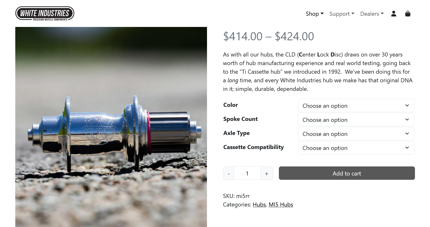

DT Swiss makes quality products. Good luck on getting an e-bike with one. E-bikes under $1800, 99.9% Chinese garbage sprockets freewheels/freehubs. Same garbage parts on unpowered bikes under $400.

I get the sarcasm, but I'm not saying expensive, just quality. You don't need a DT Swiss or White Industries, although they are worth the money. Just get a hub that's designed for high load and not light weight. The Shimano TC-FH500 is designed for e-MTB's, a high torque application. There are others like this. You will need to match up the axle type and length, spoke count, and cassette type.
I get the sarcasm, but I'm not saying expensive, just quality,.. Just get a hub that's designed for high load and not light weight.

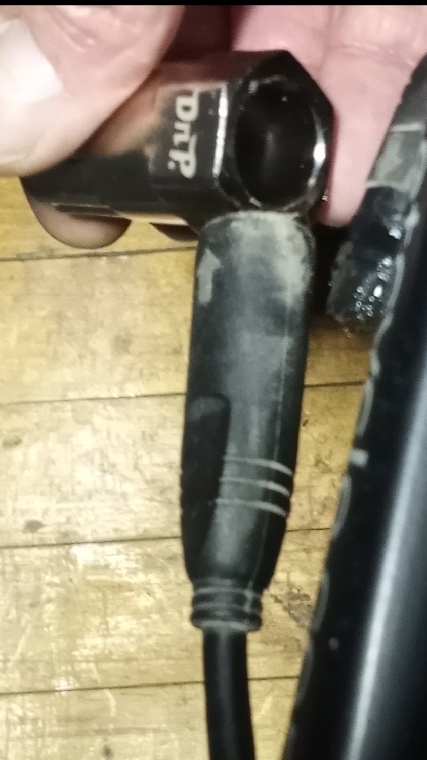

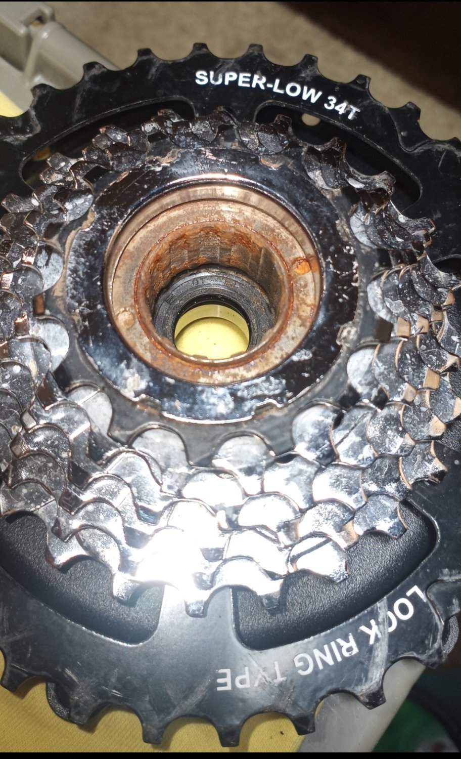

I suspect that @Yodaman1 has a freewheel similar what I had.
My freewheel was a rusty turd, so I replaced it with a better quality DNP freewheel,..
The ratcheting mechanism is built into the freewheel, so all you need to replace is the freewheel.
You will need a freewheel removal tool, and probably one with a bigger opening that fits over your larger motor plug connector on your high power motor.
Don't cheap out on the freewheel removal tool. It has to be very thin metal to fit, and needs to be quality steel.
EDIT: @Yodaman1 has a high power mid-drive ebike, so they may not have used a freewheel?

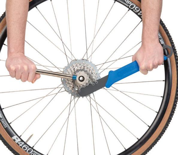

the mentioned hub is one designed around a cassette and a freehub-body on the axle. You would need 2 items to remove the cassette (lockring), a lockring tool and a chainwhip (or a similar tool)

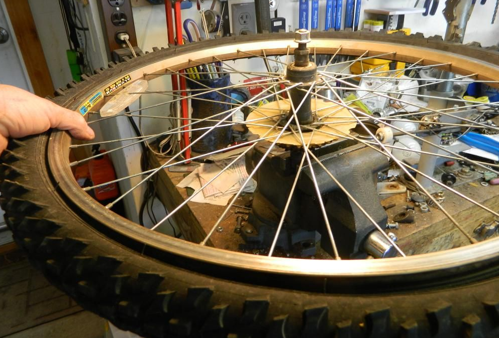

a "freewheel-type" all in one sprocket set with the freewheel integrated in it needs just one tool (TLFW30 is my favorite) and in most cases a strong bench vise and the look on your face as an angry bear.
Hard turn counterclockwise to get it free.... It usually takes a lot off force (freehun lockring is supposed to be tightend at 40Nm) because the chaindrive pulls the freewheel very tight on the BSA threaded part.
And yes I've managed to brake an actual benchvise while unscrewing a freewheel from an e-bike.... after lots of sweating/swearing

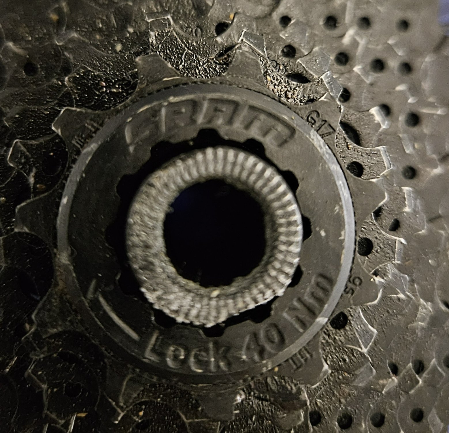

Hello everyone. I wanted to share a video of the sprocket to ensure I purchase what I need. I appreciate everyone's help so far.
You actually need to remove your rear wheel and pull out the free hub. So we can see the clutch mechanische/palls on the free hub and the inside of the gub where those engage. That would the info tho determine if your hub is toast or this one needs some grease and a proper assembly.

You'll need to remove your rear wheel to look and see whether you've got a freewheel or freehub or cassette.
(I think that a cassette is what goes on a freehub?)
Then you'll know what tools you need to buy.
Even park tools sells A Bunch of different freewheel removal tools for the different freewheels available.
(Long reach, number of splines, depth of splines,..)
You need to know your make and model.
A freewheel has a built-in ratchet assembly (clutch with pawls) so you'll only need a new freewheel.
A freehub has the ratchet inside the hub so the hub will have to be replaced and you'd have to rebuild your wheel.
(Unless you can fix it, but my guess it that it's broken because you've only ridden your bike 3 times.)
Would that be doable?
Sorry, but I've never removed a cassette before.

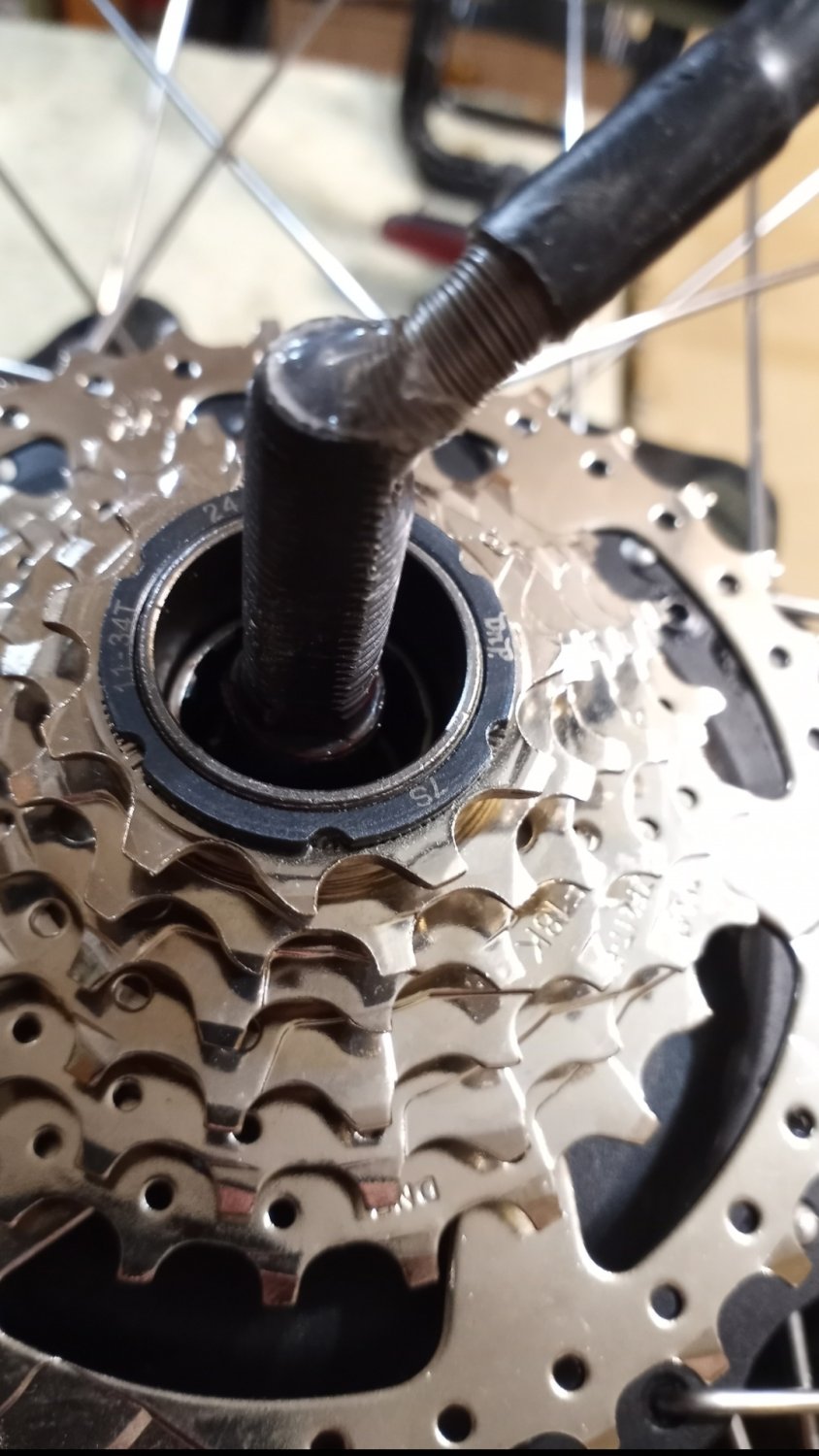

I just removed the wheel but don't have the special tools needed to disassemble the hub/cassette.
ok they are cheap on amazon.
if yo uwant cheap this will work. you need a big wrench like a cresent wrench still or big socket.
if you dont have a big wrench you can get this set.
