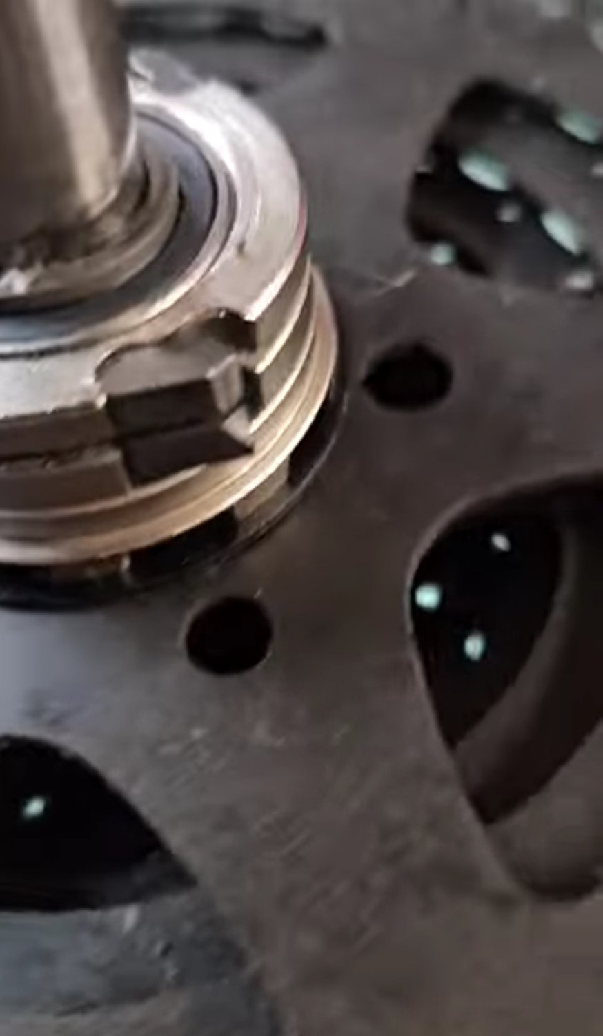

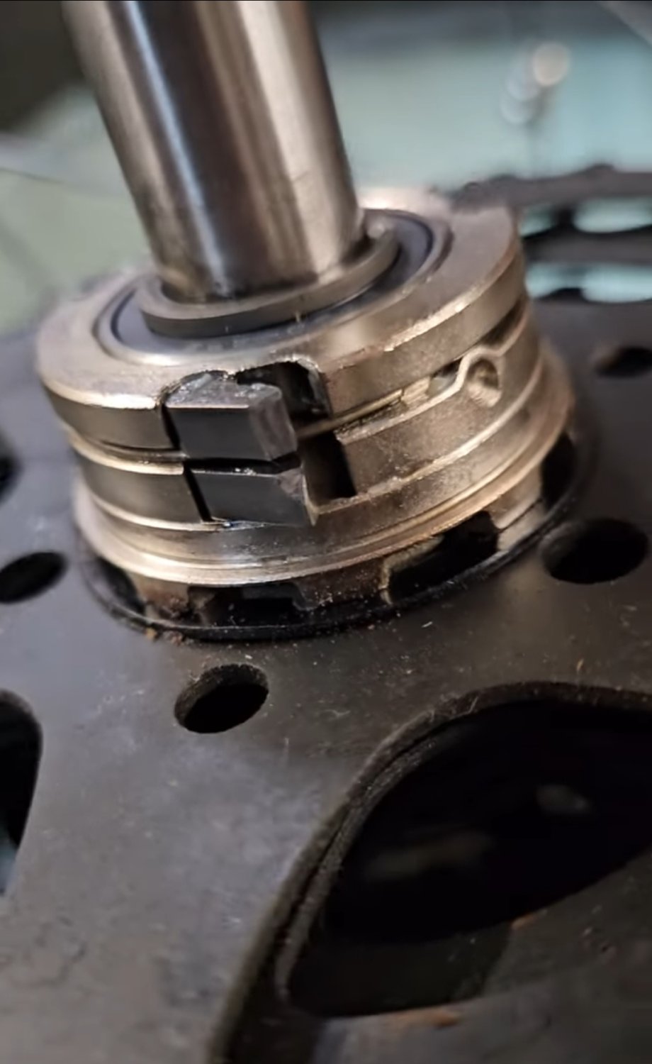

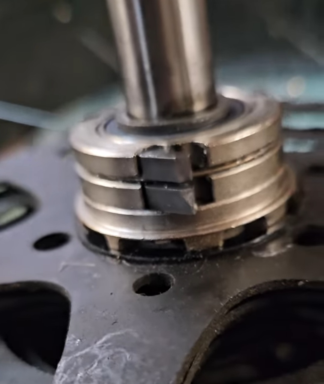

I took the rear hub apart and posted a video. Please let me know what needs replacing or upgraded. Thanks again for all of your support.
Pawls look damaged/chipped... How are the ratchet teeth they ride into on the hub?
If it's just the pawls, they are easily replaced.

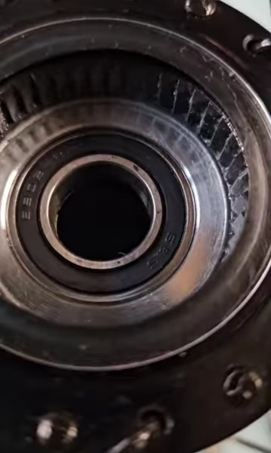

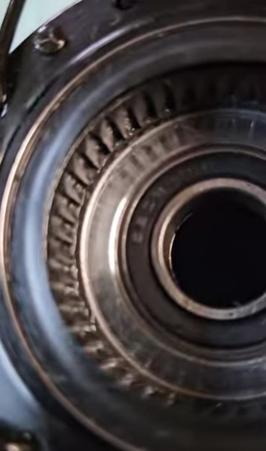

I took a couple snapshots of the video, and the ratchet teeth in the hub kinda look damaged??

Hard to tell if the teeth are damaged or if it's just the grease on them..
Wipe it down and inspect for deformities
The Pawls do look to be damaged as though they weren't fully seated in the notches of hub??
I'm not sure what that washer was supposed to do but perhaps it wasn't supposed to be there, or it was the wrong thickness (shim washer) preventing the pawls from fully seating in the hub notches?
My hub motor has a shim washer on the axle so the axle nuts can be tightened up without the bearings binding.
See if your cassette is binding or rubbing on the hub housing with that washer removed.
If it seems to have clearance, then maybe that washer wasn't supposed to be there or is on the wrong spot on the axle?

That chip on the ratchet teeth looks minimal to me and replacing the hub is much more work.
If it was my bike I would replace the pawls and give it a try.
