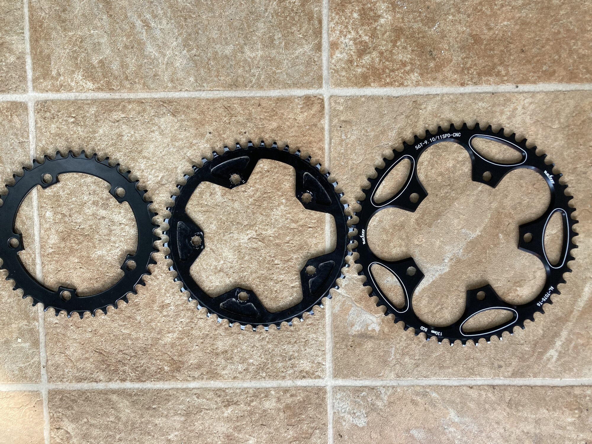

On most bikes a smaller chainring would be fine, but the chain cross in the smallest cogs (11 & 13) is horrendous, so I'm trying to get my cruising speed (20mph) with the chain sitting in the 4th or 5th rear cog.
To do this I have to move to a much larger front chainring.
My new 56t chainring arrived today and it's massive. Here's a size comparison (42t, 48t & 56t)

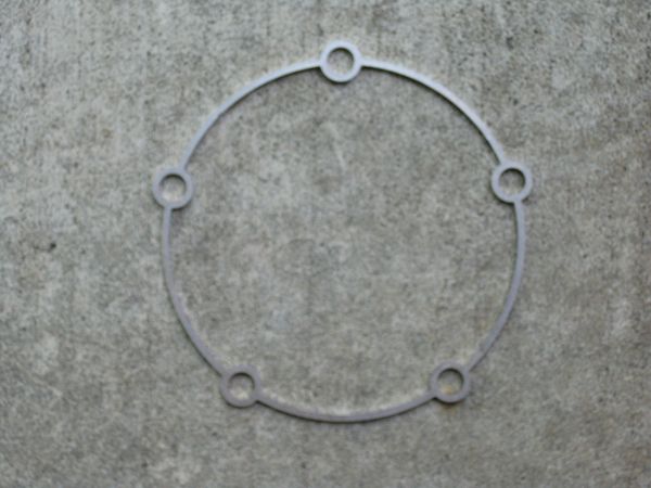

I also ordered a 3mm chainring spacer which should be arriving soon. As I mentioned in a previous post, my goal is to reduce the cross chaining as much as possible at my cruising speed, which is around 20mph.

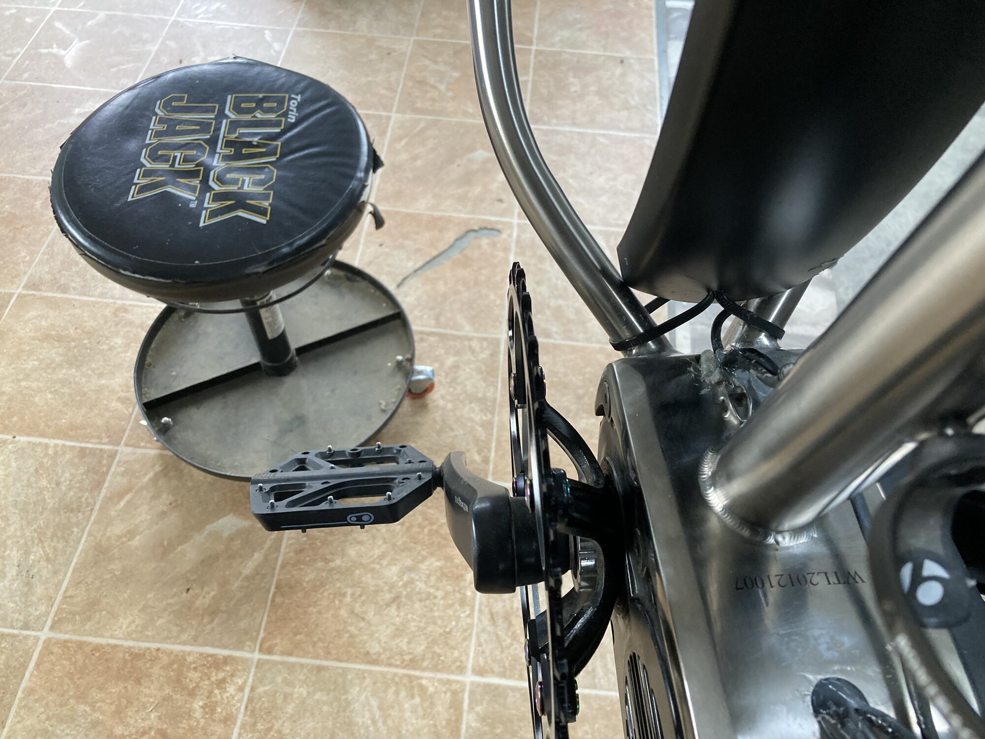

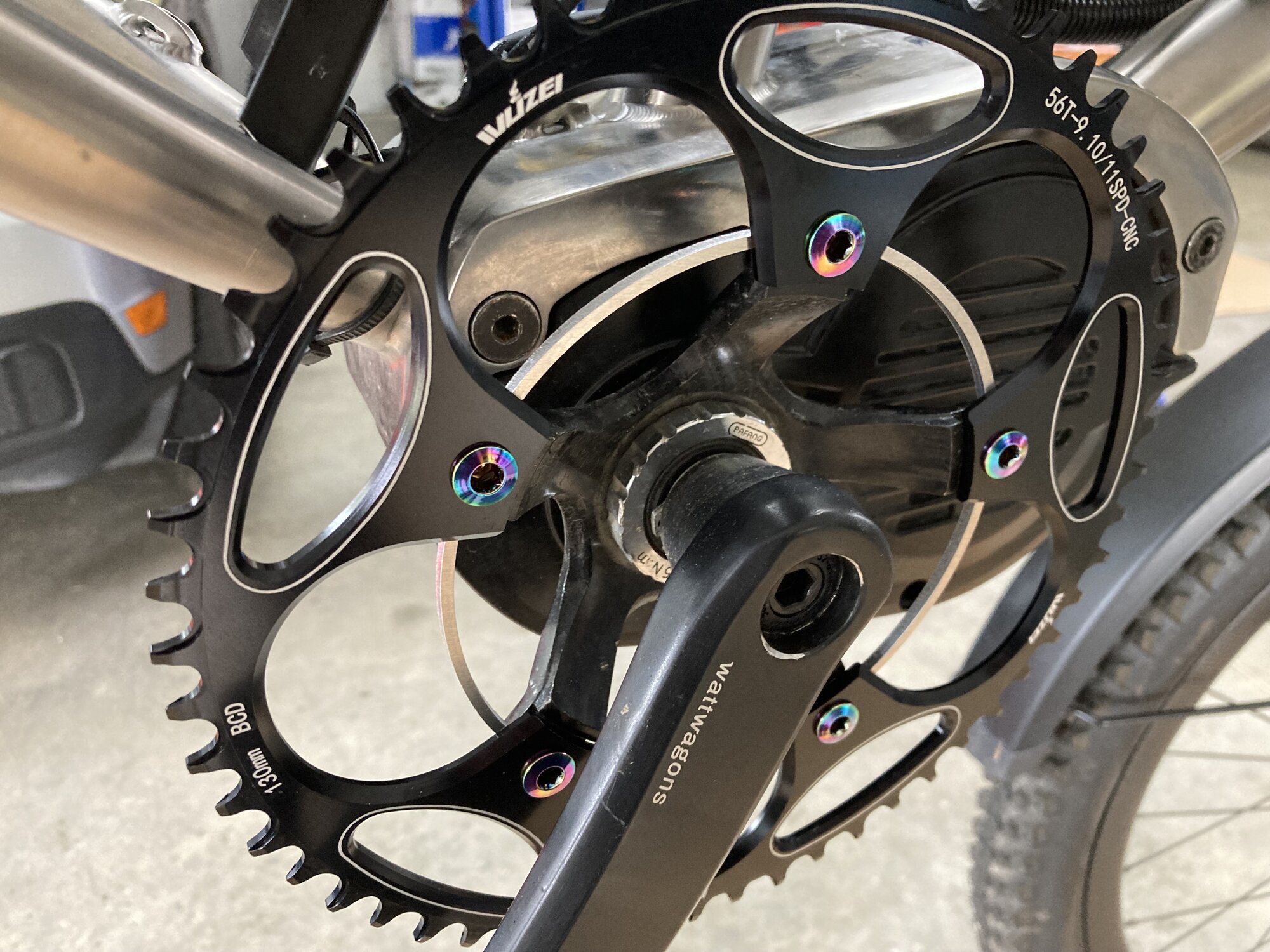

56t chainring is installed, along with a 3mm spacer. Now I'm waiting for my new chain to arrive. Interestingly enough, the best price I could find is from a German online bike company.
It takes considerably longer for the chain to arrive, compared to driving down to my local bike store and buying one (if they have one in stock), but the savings is substantial.
Here's a photo of the spacer/56t chainring/longer chainring bolts installed:
For anyone wondering (is anyone still coming to this WW forum?) I still have a ton of frame clearance with this 56t ring. Using a fat bike spider helps. :cool:

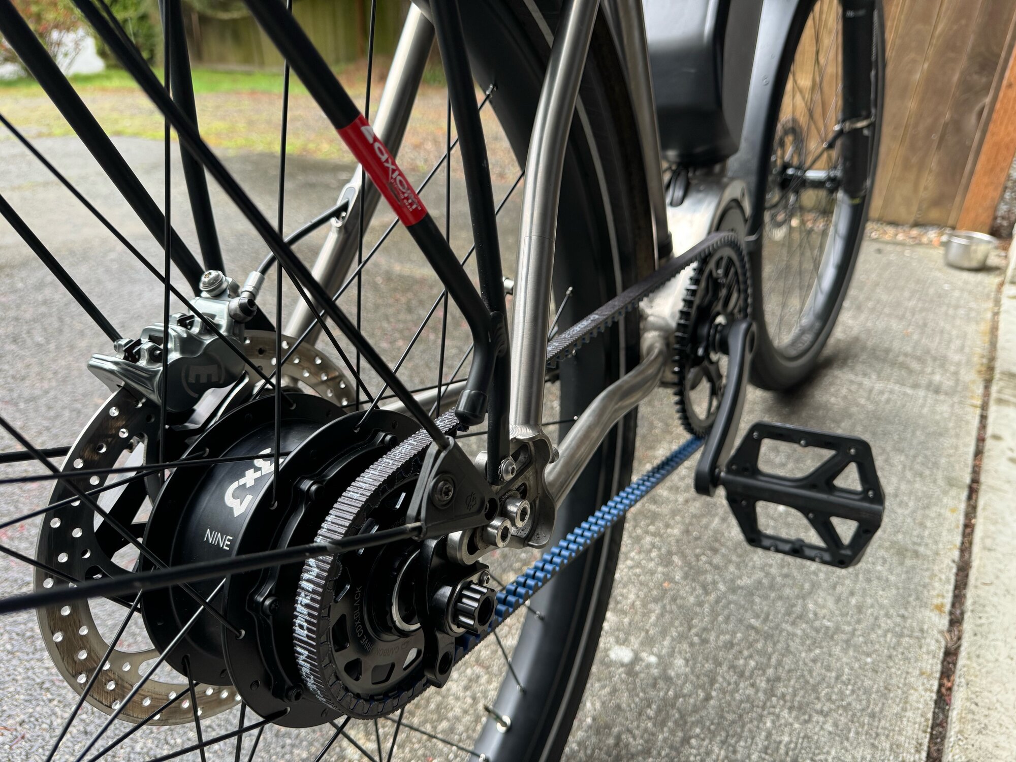

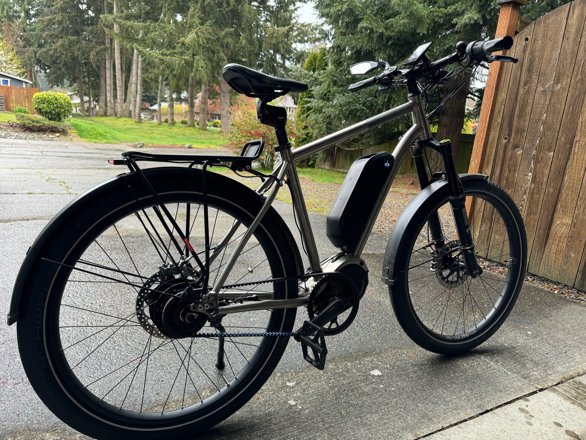

I posted this elsewhere, My UC Pro now has the new 3x3 Nine IGH with a belt drive, and it is performing extremely well! The first three gears are so low that in power level one and a quick downstroke of the pedal, the front comes off the ground, and with a 42T front sprocket, it easily goes over 28mph with a 60 cadence. It shifts at a stop or under power, but I find it shifts better with a pause in pedaling when down shifting. It handles 250 nm of torque, and requires no annual maintenance. My Kindernay failed, and the chain option is not really an option, which leaves this the only road to follow.

Did you have any problems lining up the front ring with the rear cog? I imagine if the 'chain line' isn't perfectly straight the belt will not stay centered.
No problems at all. I had a local bike shop do the wheel build. All parts were supplied by VPL.bike in Colorado. I did make the mistake of ordering the wrong brake adapater, but VPL sent the right one out right away. Everything lined up perfectly. It has a new 32T rear cog and a 42T front sprocket which came with the bike from WW. I originally had a Kindernay which failed shortly after purchase, so I had the sprocket already.

I have over 500 miles on the 3x3 Nine and no issues. The belt has never popped off, and operates as intended. I have found the first three very low gears useful for trails and riding around and with pedestrians. Gears 8 and 9 are so high geared that I seldom use them unless I want to go 30 mph plus (up to 38.) I suggest anyone with a UC Pro to go to the VPL.bike website and look at the 3x3 Nine.
