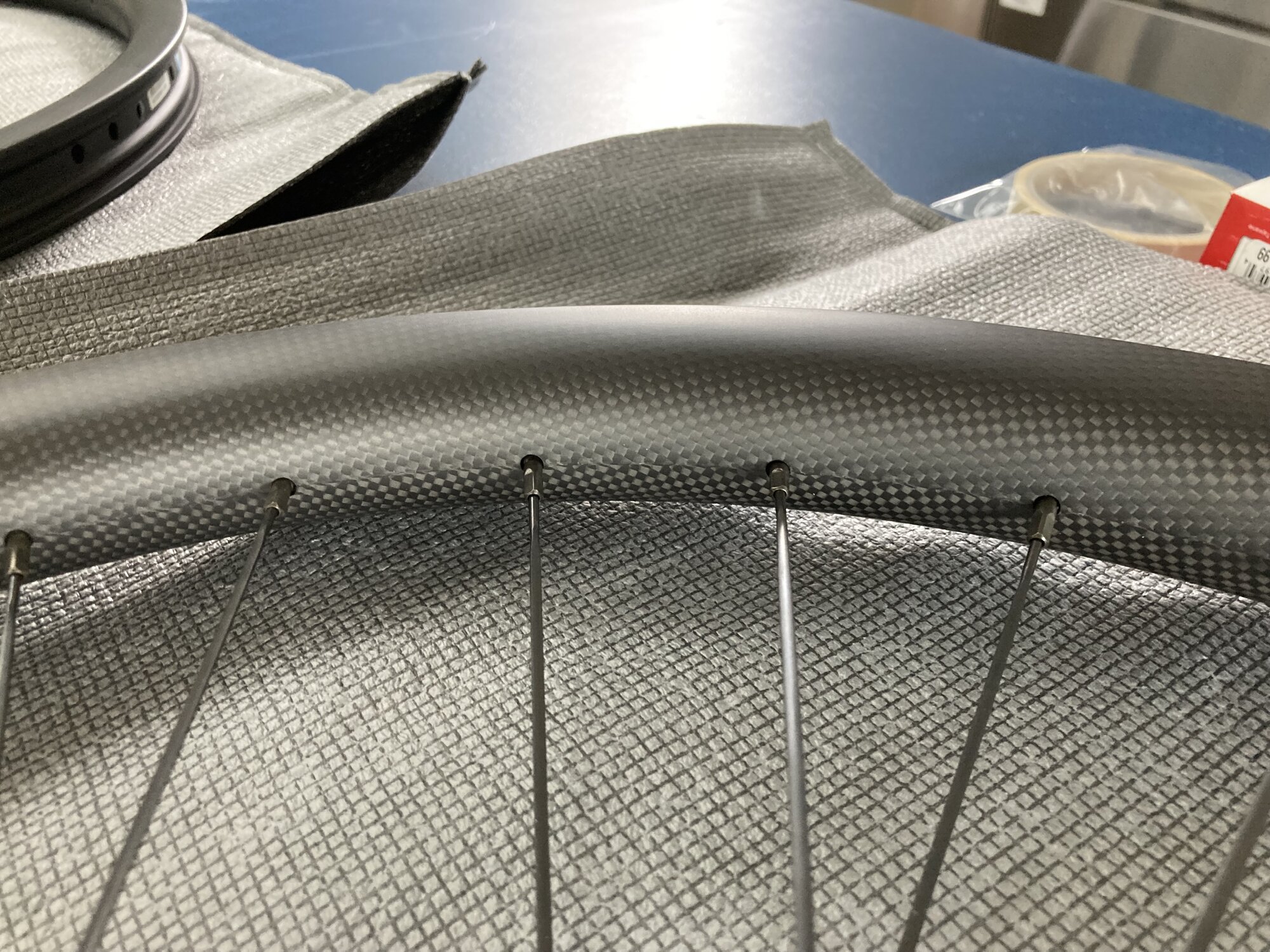

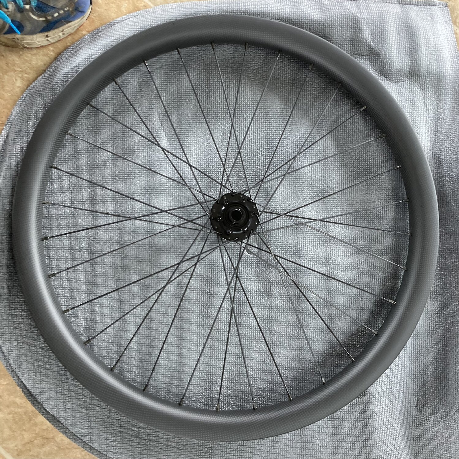

I just received my new Nextie carbon wheels for my UC Pro.
I love this bike, but it's a bit too big for me. Standover clearance is at a minimum, with NO room to spare, if you get my drift. ;)

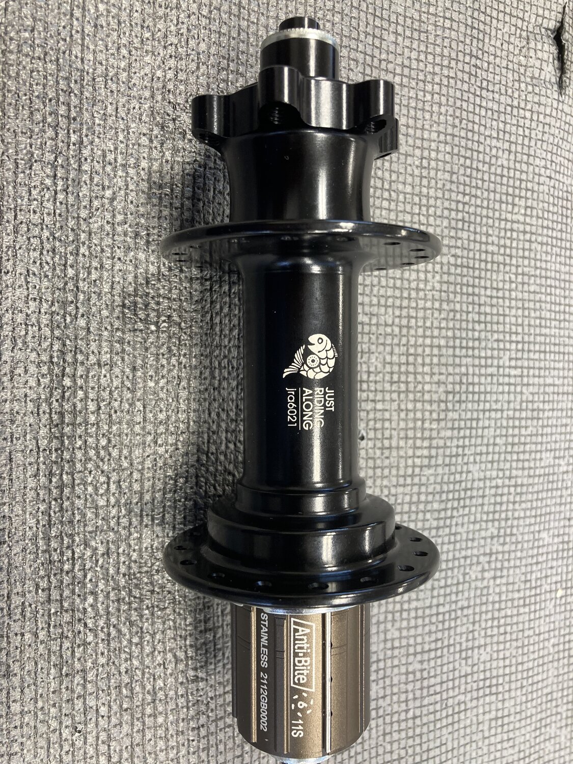

So, I ordered a set of 26 inch wheels from Nextie. The only problem with the order was they were not able to source the needed 170mm rear hub, so I had to order the complete front wheel and just the rear wheel rim.
I ordered a JRA 170mm fat hub from the UK and plan on having the wheel laced by a local wheel builder.
