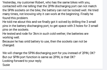

Hi AZ, realize my order says 2 pin. That's why I high lighted the requirement for 5 pin.
See snip below.
See snip below.
I have 2 ebikes that take the same reention dorado 10.4Ah battery. So I still would appreciate you taking a picture of your bike port and the battery port. Cause AFAIK all of them have a 2 pin port and 3 tiny recessed indentions that do absolutely nothing when attached to the bike frame.
Both mine have the 5 pins. See Rook below.

Thanks for the pictures. That's very helpful. Looks like they added guide pins. IMO they don't do anything else but help guide the port of the pack. So drilling them out with a small bit would accomplish the same thing if your ebike connector has those.
I was able to procure a 21ah Dorado battery for my rook but have run into some compatibility issues. The new battery and Reention mount that came with it have 2 wires (red and black) into the discharge port. However when I removed the Reention mount from my rook there are 3 additional smaller wires ( green, red, and yellow). See attached. Does anyone know what those wires support? - Thanks

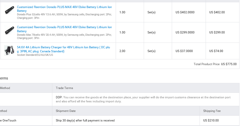

Hi Hoppy, here’s some pictures from my order. These were sent to me from Susie prior to shipping to make sure I was happy with my order. The communication back and forth was excellent. In terms of length and width etc. To my knowledge from Susie, there’s only one style casing that’s fits the Rook and one style casing that fits the Shred which is the stock one. You then have the choices on what AH cells you want in there...I asked for the best and Maximum AH available that would fit...and that is for the Rook or Colt 20.4AH and the Shred 13.6AH. You can cut costs by quite a bit going with less AH but why if your going through all this. Susie claimed for the best performance use the Samsung cells, they have others that are less expensive but I chose these.
On my order for the Rook battery is as follows:
Customized Reention Dorado Max 48V 20.4AH, 500W by Samsung Cells, Discharging Port 2 Pin, Charging Port 3 Pin.
On my order for the Shred battery is as follows:
Customized Reention Dorado Plus Max 52 Cells 48V 13.6AH, 500W, by Samsung cells, Discharging Port 2 Pin, Charging Port 3 Pin.
Note: I ordered there upgraded fan cooled battery chargers which have double the output and a different electrical end. If your going to use the stock plastic battery charger you will need to specify that in your order for that end, just send Susie the picture. Some of the questions on my order was what wall electrical end did I want, I sent the picture which is the same in North America...this company builds battery’s for all country’s and that’s important that you get that 115/120 3 prong. Susie and I through many e-mails got this down. Regards Robert ??
