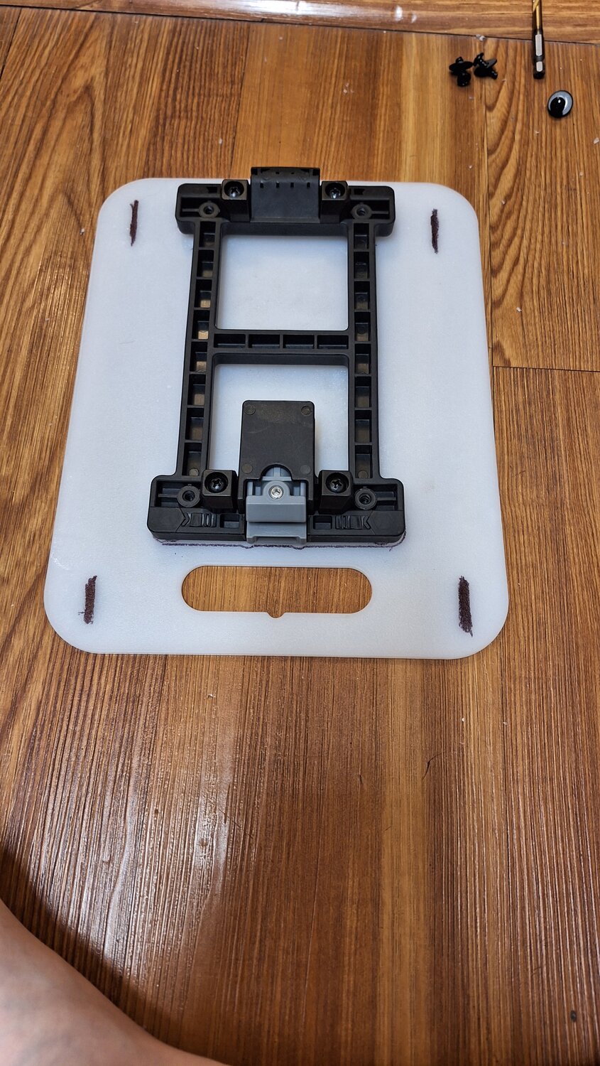

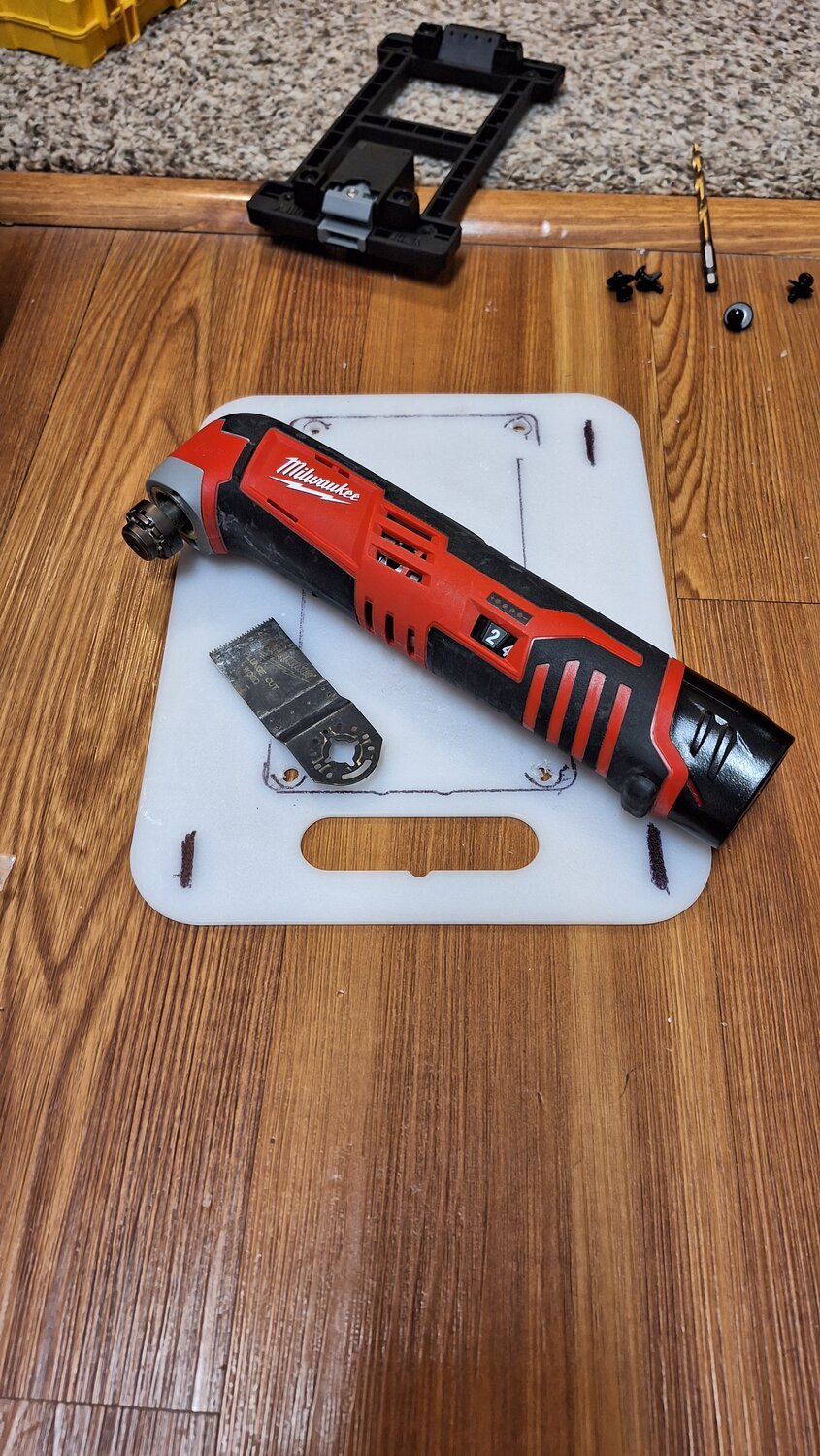

So, after a bit of brainstorming, I ordered up a MIK plate and pulled a cutting board out of the cupboard. I've done this in the past with cutting boards. I also have a car audio habit and they're great for making speaker adapters as they're strong and don't mind moisture.
This is a working prototype. I think the board is a little too thin, but I'm going to spend some time with it and see if I want to make one out of a thicker board.

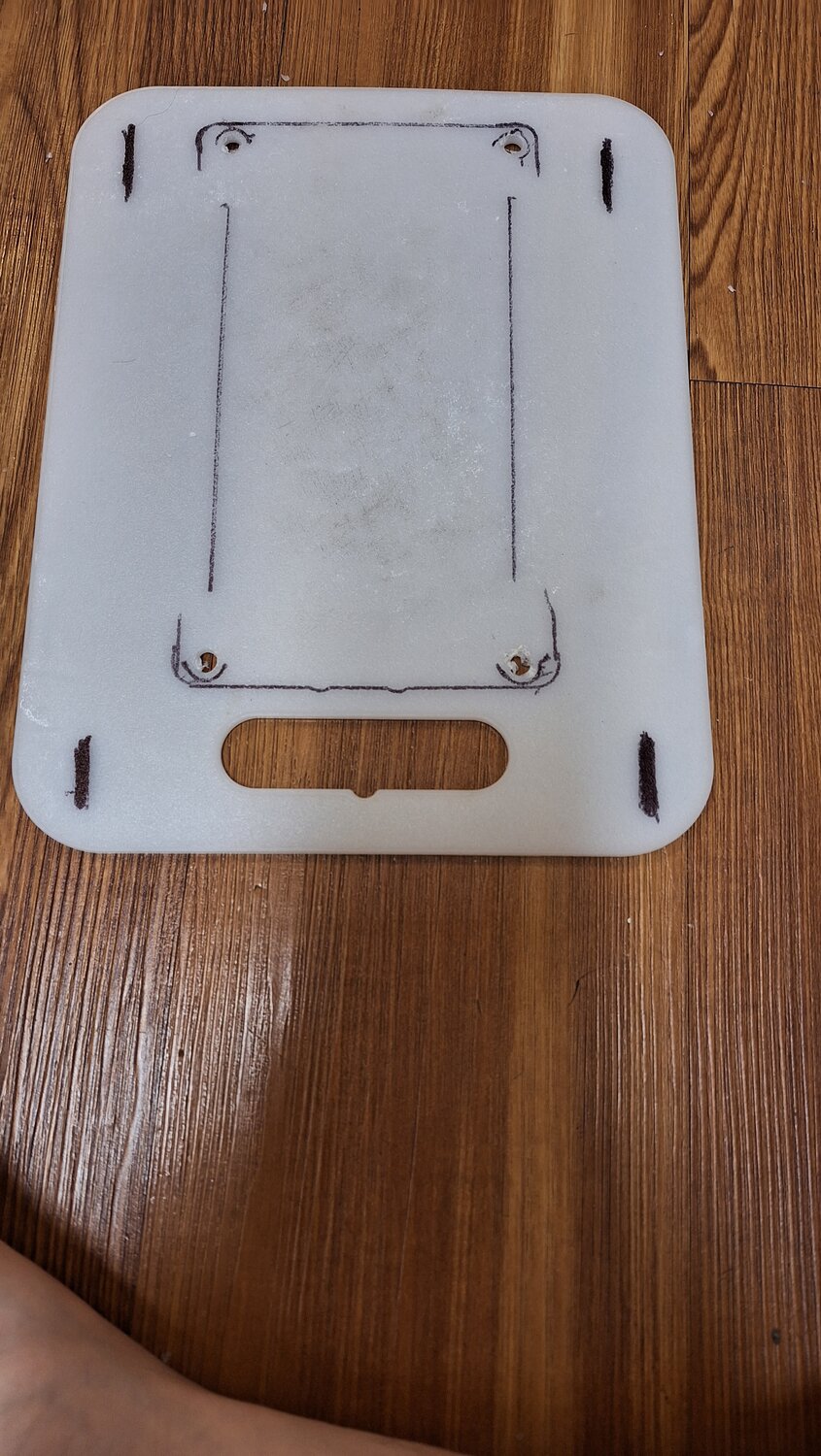

Tracing out the rough shape on the board. Drilled holes for the plate and marked the locations of the straps (they're not symmetrical)
The basic idea
I thought I'd do this with the multi tool, but the only bit I could round up is too big. Found moar tools I need :)

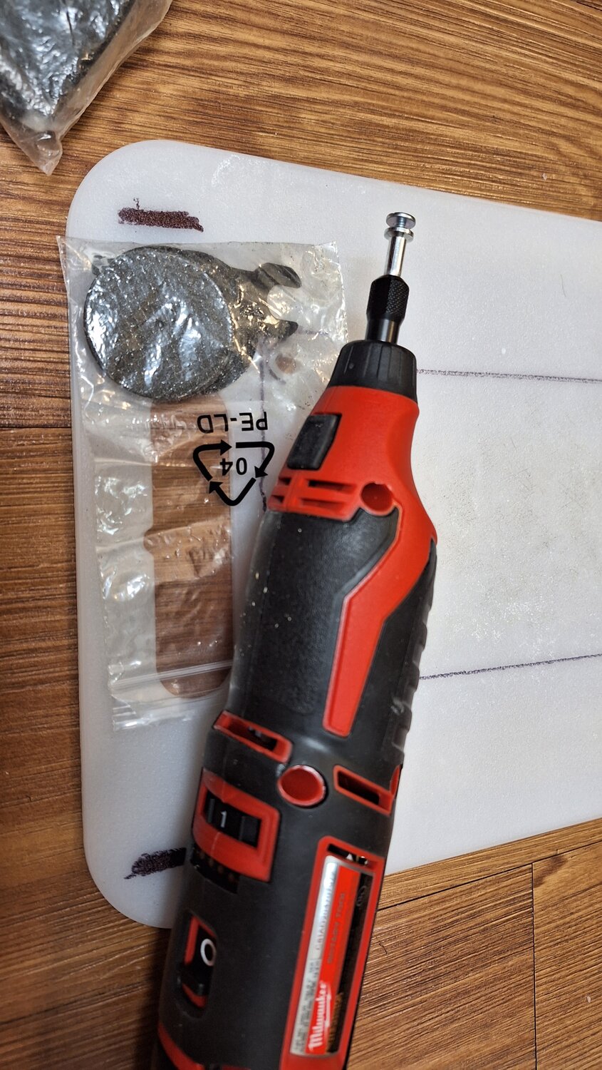

Figured maybe the rotary tool would be a good fit, but the discs are also too big. Moar tools :)
These fit though :)
Had to pre-drill holes, but it turned out to be the right tool. And for more than one reason. The other 2 tools are going to melt the plastic, but using a slower speed on the jigsaw and a nice new blade, I didn't have to deal with melting plastic.

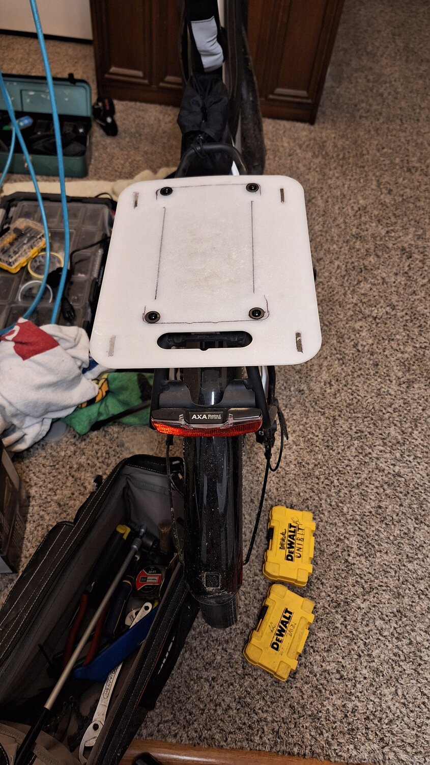

When I'm not carrying the JandD, I can put other stuff on here - lots more flat surface. I probably won't, but it's nice to have that utility available.

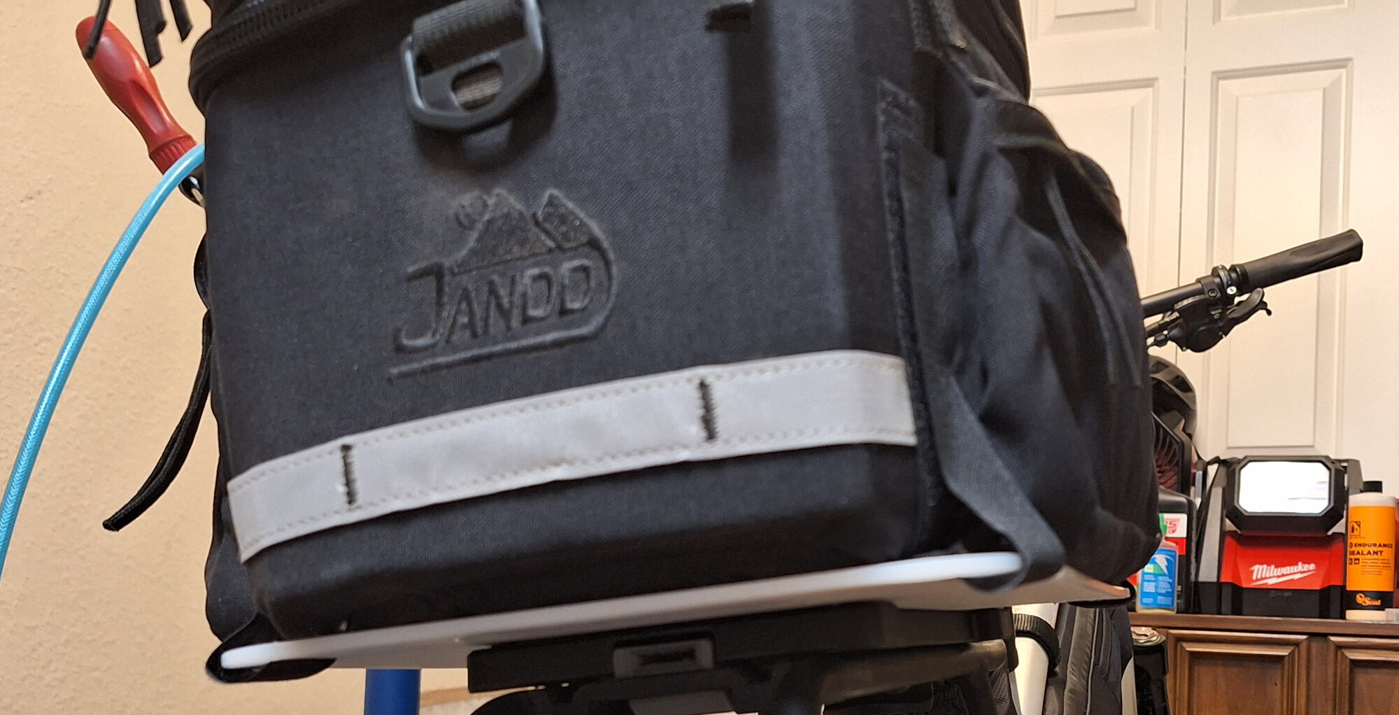

With the bag. It moves around WAY less like this..far more stable than directly on the rack

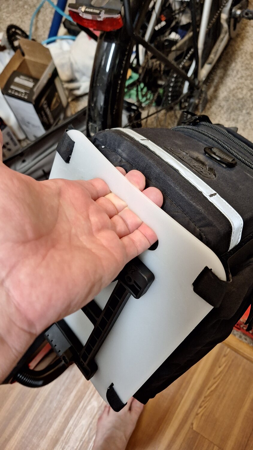

Flipped over. This is super nice 'cause I can reach under and flick the lock and take the bag with me easily. No need to mess with the straps on and off - that's a bit clumsy.
The existing handle on the board is convenient for carrying. There's another strap on the front I can use as well
