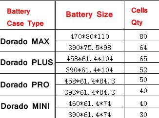

Thanks for the info Robert. However I'm a bit confused. Looking at the alibaba site https://www.alibaba.com/product-detail/Reention-Dorado-Mini-Pro-Plus-36V_60736873926.html
I see this image with dimensions:
So given that I measured the Rook battery and it has the same dimensions as the Reention Dorado Plus of 458mm x 61.4mm x 104mm (length x width x height). But instead in your post above you have the Dorado Max listed for the Rook battery which has dimensions of 390mm x 75.5mm x 98mm which I doubt the short length of 390mm would fit the Rook. So am I reading this right or do you have the batteries for the Rook and Shred in your post labeled incorrectly? I also see that you have the Shred battery listed as Dorado Plus Max. You probably meant just Plus or just Max (and if the 2 batteries are reversed I would think it's Plus) as I don't think there is a Dorado Plus Max, right? Thanks.
To clarify battery's. I own two Surface 604 bikes and had ordered two new battery's as extra back-ups more than anything. The stock Rook battery is a longer battery then a stock Shred and the description on my packing slip for the Rook says it is a Reention Dorado Max 48V 20.4AH 500W. Again going from my packing slip my Shred has the Reention Dorado Plus 48V 13.6AH 500W. Hope this helps you out.
When giving Susie at the factory the measurements she wants to know the length of the battery mounting hardware on your frame, from the outside of the plastic on both ends.
