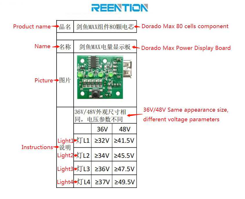

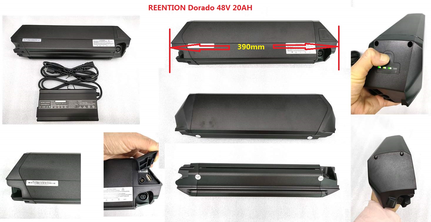

Hello friend, I think you need this following sheet:Well, based on the manual, there is no input into the display for the ah of the battery. After a few rides it appears that the display is out of sinc with what is actually going on with the battery. After 37km the display was down to 6 (of 10) bars. At 70km it was down to 4. However, the voltage read 48.7v, which is 61% remaining capacity. After 104km, I was down to one bar and one light of four on the battery indicator. At that point my multimeter read 46.4v or 40% remaining capacity. I rode the entire time on PAS2, on rolling hilly roads. So based on that, I probably could have gone another 30km before reaching 20% of the capacity. In summary, my potential range at this time is 130km, and I rode in 6-8C temps.
