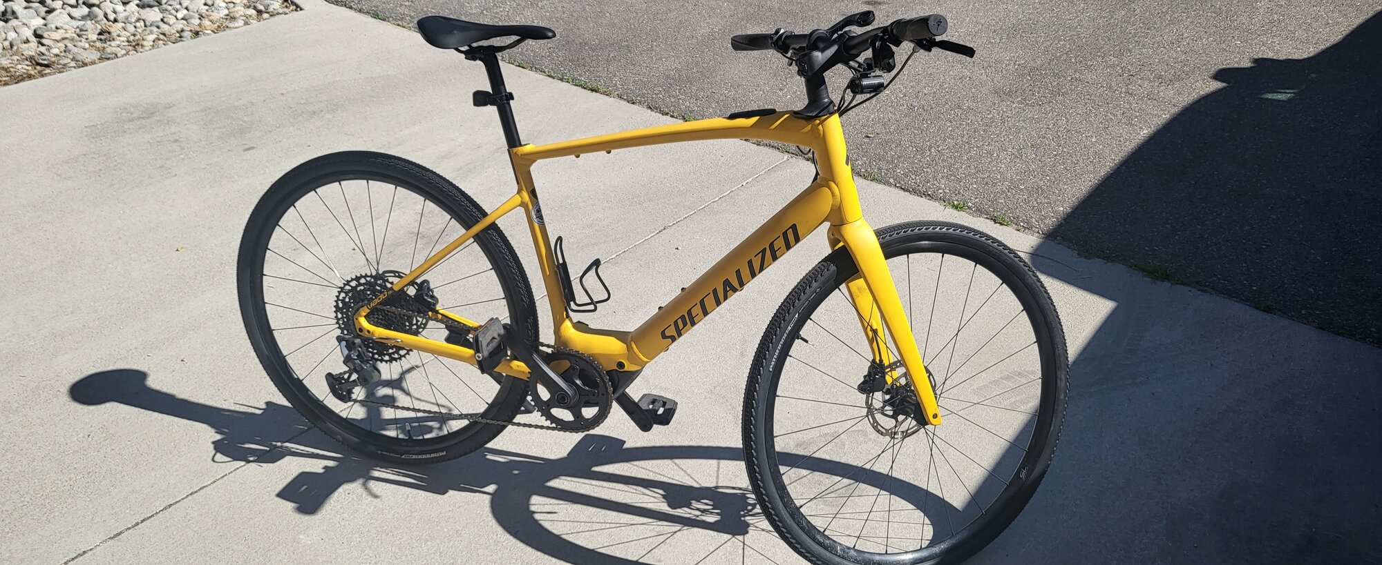

I already made the decision and purchased a screaming yellow new-stock SL 5.0 EQ. The wider ratio SRAM is really worth it. I have upgraded mine by installing the XD driver, 10-52 GX cassette, and a GX chain, and a 46T front sprocket. The ratios are now just right so that I have a "grinder" low low that allows me to climb just about anything, I can reach 28 mph in 11th gear and still have 12th gear left for downhill descents. The carbon fork and future shock make the bike much more comfortable.
I live in north central Massachusetts and get a fair amount of hilly riding. I am 72, 5'11", and 217lbs and this is my second eBike. With 2 x range extender batteries, my effective range is around 65+ miles at a average pace of 15 mph.

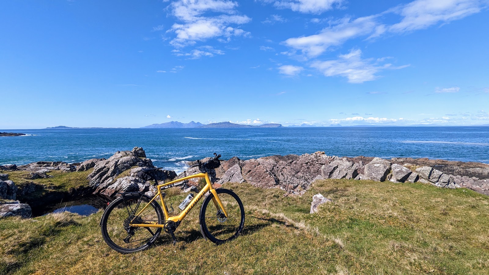

I've got the SL 5.0 EQ in cruising (not screaming) yellow and love it. I'm also about the OP's height and 3-4 kg's heavier. I got the XL and it's definitely the right size for me. I bought mine online (I live >150 miles from the nearest dealer) and spent some time discussing the sizing with the Specialized guy. I thought long and hard about the mudguards but am pleased I got them. The bike stays cleaner and I'm more tempted to go out in poor weather. The gearing was a little high for me - I routinely do 600-900 metres of climbing on a 40 km ride - so I changed the chainring. The roads here are very poor and the FutureShock certainly helps. Other than the chainring, grips and pedals it's stock and I'd buy exactly the same thing again.
