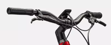

Since Tero and Vado have the same frame, do I just swap the handlebars on the Tero for the Vado handlebars? I think the handlebars being farther out was where I felt the difference. My arms are a bit shorter than average for my height. Then pay a bit more to get the fender and rack and I have the Vado that I wanted in the first place. Does that make sense?
You can actually replace the Tero handlebars with any standard flat handlebars of the diameter at stem of 31.8 mm. Some people just trim their bars to the preferred length. Only enough of real estate needs to be left at the bars to accommodate the grips, brake levers, the shifter (at the right hand side), the remote (at the left hand side). Nice if you could find some space for a bell, too.
The issue with the real estate on the bars is you have to mount all the parts in the grip area of 22.2 mm diameter, which is limited in length.
(You would install a Wahoo mount near to the stem -- at the 31.8 mm part -- so that doesn't matter).

Next up in thoughts is to explore alternative handlebars options. Thanks for the info @Stefan Mikes

Not. The Specialized stem is highly specialized 🤣 Why should he replace a standard size stem in the first place? The handlebars replacement will do.
First thing my bike fitter replaced to adjust reach. But, yeah, it can be challenging on some specialized models. I still use that replacement stem on the FLX as it reduces reach significantly (in addition to different handle bars).
The Specialized stem has the display and the headlight integrated into the steam. IMHO, the OP might try a smaller frame, and replace the bars.
Specialized always integrates the display (if present) into the stem.
Vado 5.0 IGH.
Moreover -- depending on the model -- the stem can be fairly weird :) Still, Specialized stems are A-Head standard and any 31.8 mm flat handlebars fit there.
Vado 5.0 IGH.
Not on my vado. The clamps just went around the stem but attached to the handlebar. It was a non-issue. Very easy.
