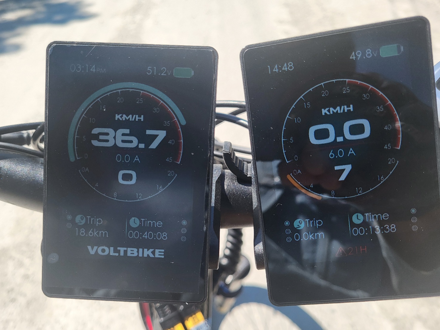

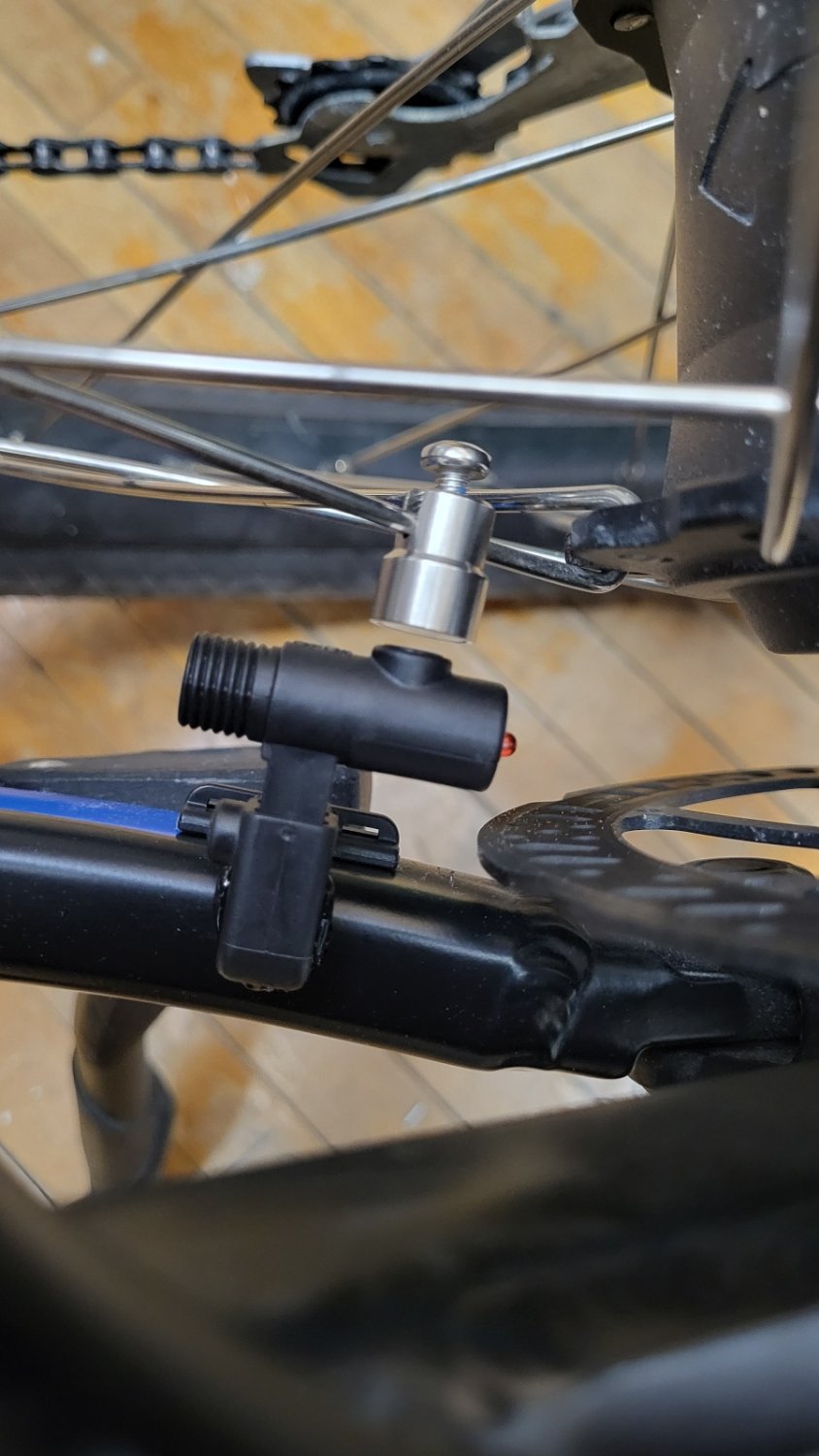

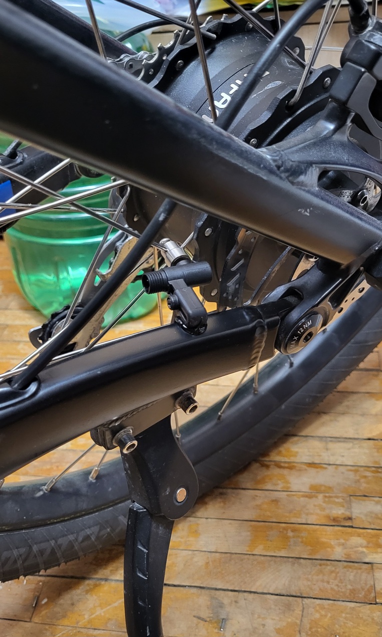

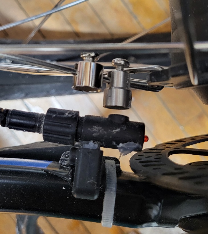

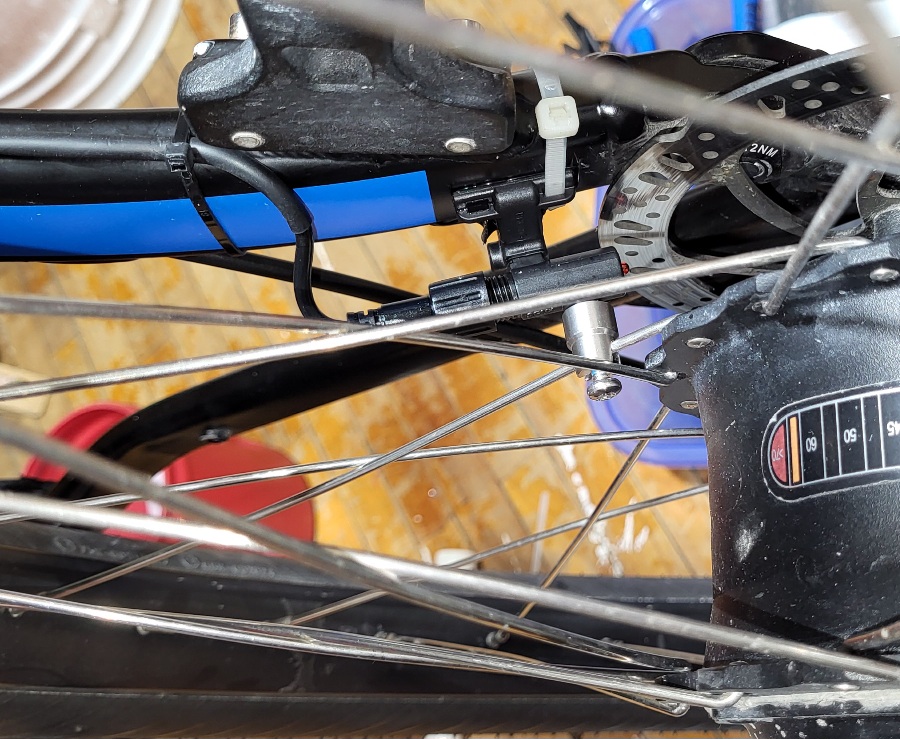

I got into the Vado and came up with this 6 magnet Speed Sensor.
6 magnets stuck to the brake rotor,..
(The rotor alloy has some iron in it, so the magnets stick.)

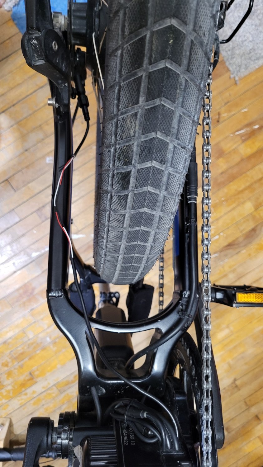

I used my glue gun to tack the sensor to the underside of the frame at the dropout.
It worked !! But,..
It only worked at slow speed and didn't work at 32 kph.
At slow speed, the speedometer was reading correctly, but at 32 kph it was reading half the speed and kept trying to go faster ??
(Luckily I could use my Voltbike speedometer to verify the speed)
Weird??
So I turned my Maximum speed down to 28, and it worked properly, but it went to a half speed reading starting at 29 kph ??
The sensor light was pulsing showing that it was working, but it was too hard to see the flashes, when it was spun up to 42 kph.
The hard part was getting the magnets evenly spaced, because the rotor has six bolts, but has eight rotor arms (or whatever they're called?)
I had a few more mm of room to move the magnets further outbound on the rotor before they hit the brake caliper mount, so I put a magnet on every second rotor arm to give me 4 evenly spaced magnets.
(I only had 6 magnets, so I couldn't try 8)
It Worked !!!
But, that's only one magnet more than the 3 that I had intended to put on my spokes.

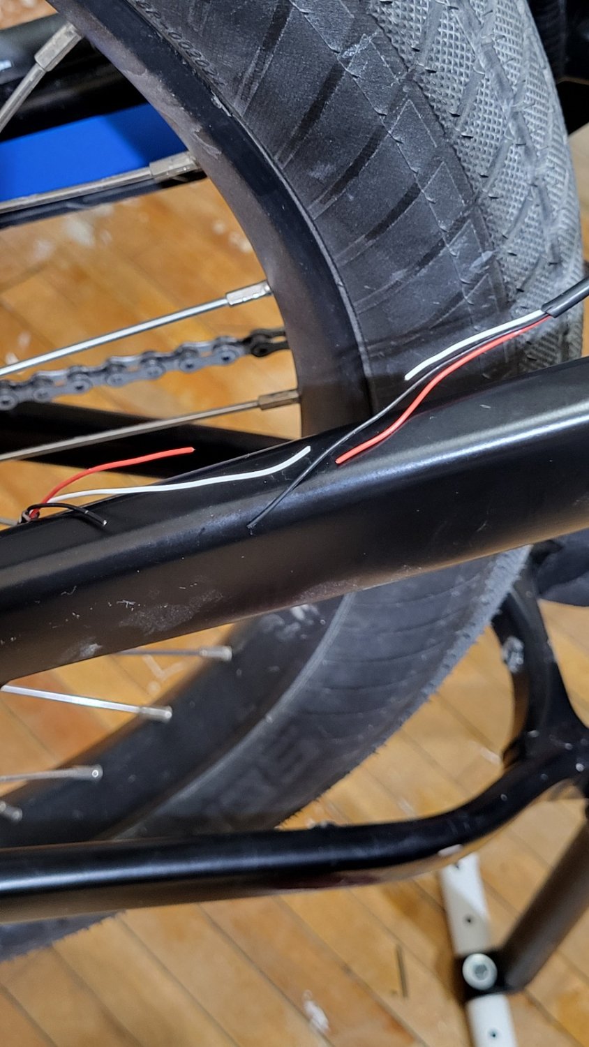

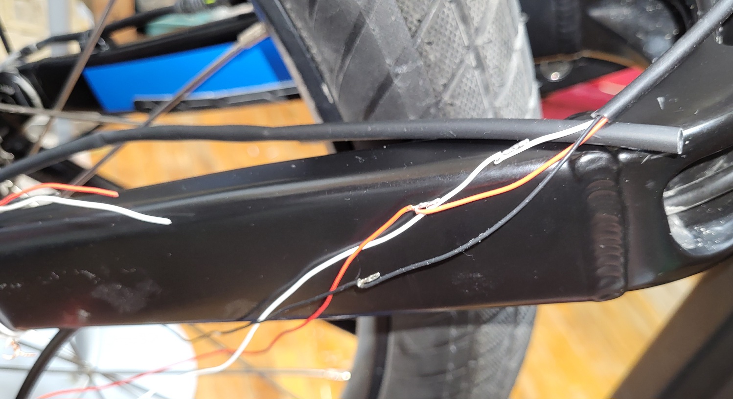

And I'd have to extend my sensor wires again to get the sensor down under to the axle dropout.
So,..

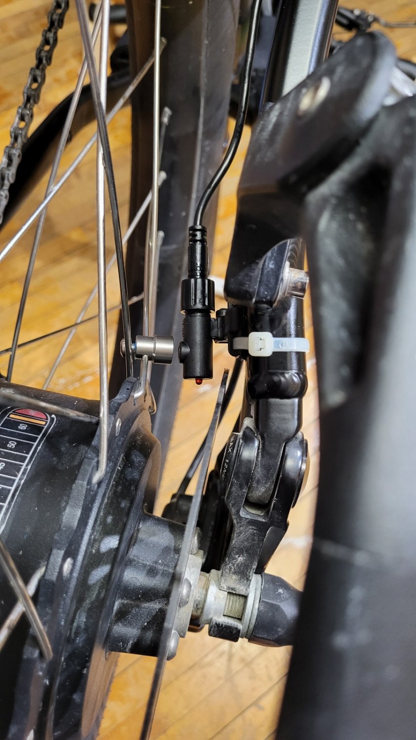

I reconnected the speed sensor to its original position with the single spoke 🧲 & ordered a bunch of 4 X 2mm and 5 X 3mm round magnets that I should be able to 🤪 glue to the rotor arms, to get my magnet count up to 8 with plenty of spacing.
My rotor arms are ~4.5mm wide at their narrowest,..
So,..
I can put a single 4X2 magnet on the rotor facing the sensor, and one or maybe two 5X3 magnets on the backside of the rotor to strengthen the magnetic field.
(I've got a Mile of space on the backside of the rotor because of all that Fatbike spacing crap.)
Three stacked magnets should give a stronger, shorter pulse to keep my controller happy and not have it Flip Out and conjoin half the 🧲's
(or so my Vado enhanced thinking tells me. 🤔)
I figure that the six magnets were too wide, and too close together, so the controller got confused and started to count in pairs?

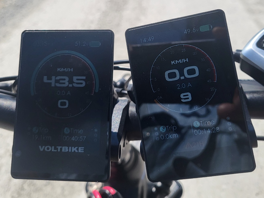

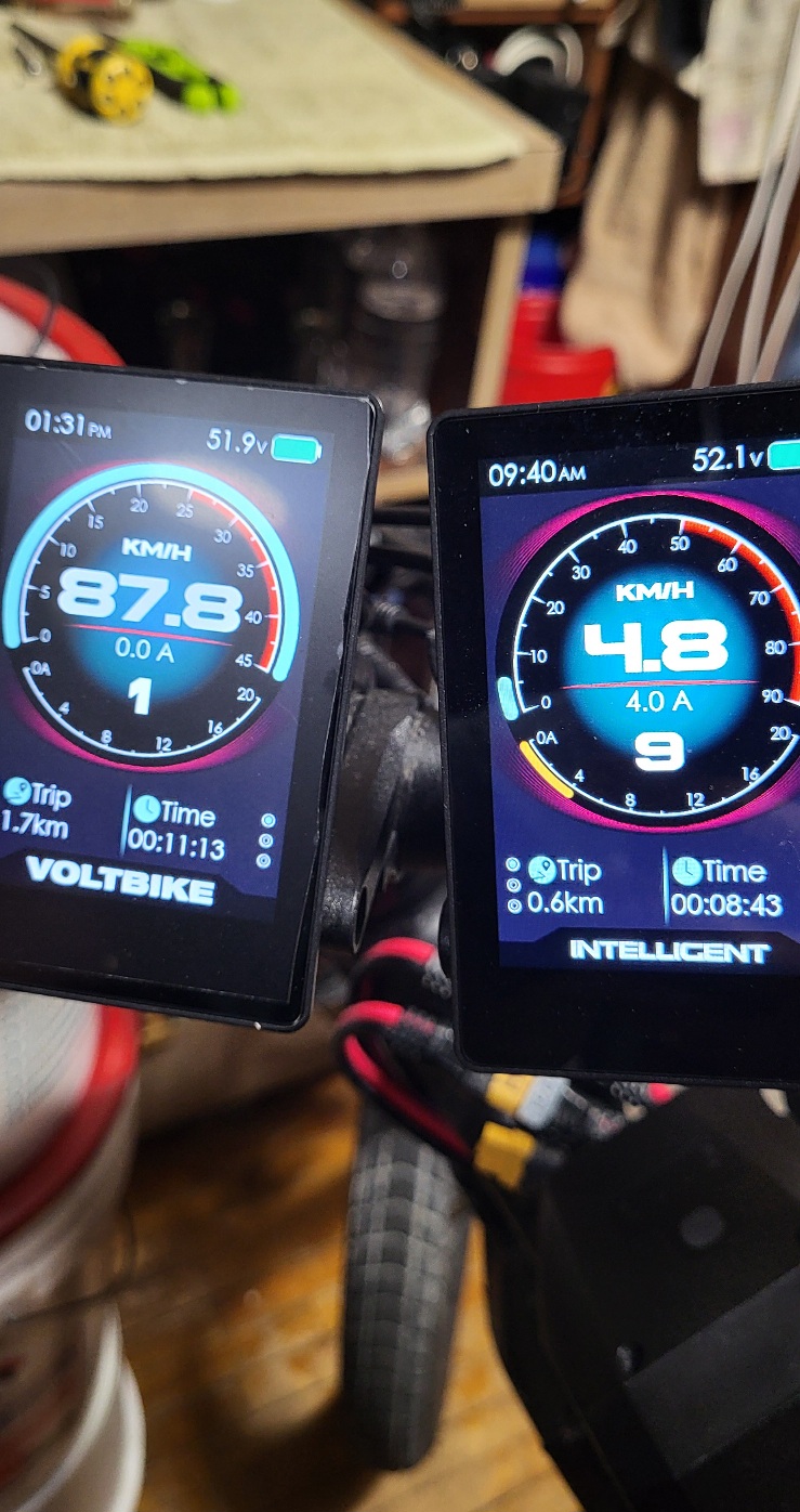

My speedometers are working good enough for me.
I verified my speed on straight flat level ground with no sky obstructions at a steady speed of 32 kph, and my GPS app agreed with the speedometer reading from my Voltbike.
This is with four magnets on the rotor.
It was still kinda bouncy, but it wasn't under load,..

Here's a homework assignment if you haven't seen this yet...
I didn't do no homework, but I played with the settings.
It turns out that 100% speed is 100% of the 32 kph that I chose as my maximum speed, and the speed control was always hovering around 25-26 kph??
I've got my power turned down to 18 amps from 25.
That happens to be ¾ and it appears that that translates into ¾ speed as well ??
So I needed to set my maximum speed to 40 kph so that 80% speed would be 32 kph to keep my controller happy.
I dunno.??
It's the only way that I could get my set speed limit to stay at 32 kph?
It's a good thing that I had the Voltbike speedometer to use as reference.

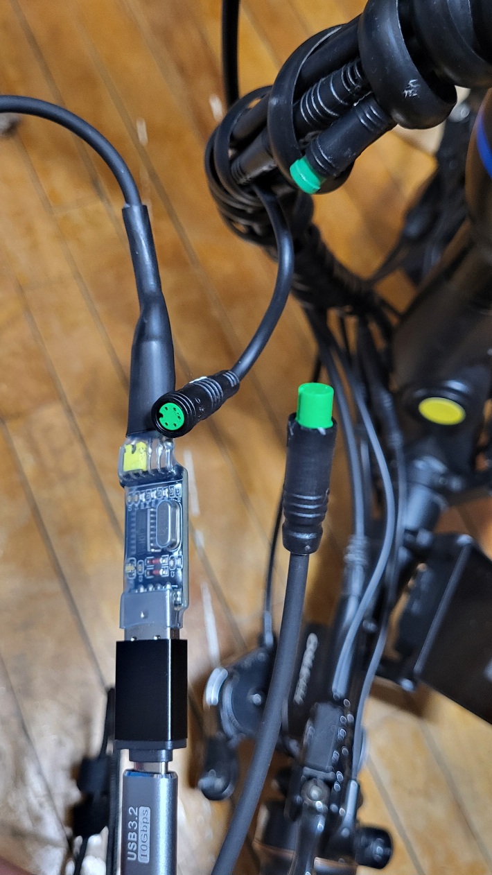

Just shut off the display.
Don't think anything bad would happen... But while I'm connected to the Y cable, I always leave the display OFF just in case.
I would have thought that unplugging my display would kill my ebike, but it didn't.
I had the display disconnected with the programming cable plugged in without my smartphone connected, and the motor fired up when I spun the crank.
I didn't expect that, but I just need to keep that in mind, just like I have to remember Not To try and go into first gear with my 52 tooth chainring.
I'll keep that in mind.
I could even use my old phone plugged in to the cable and sorta kinda use it as a display on the handlebars, or a long usb cable and the phone in my pocket?

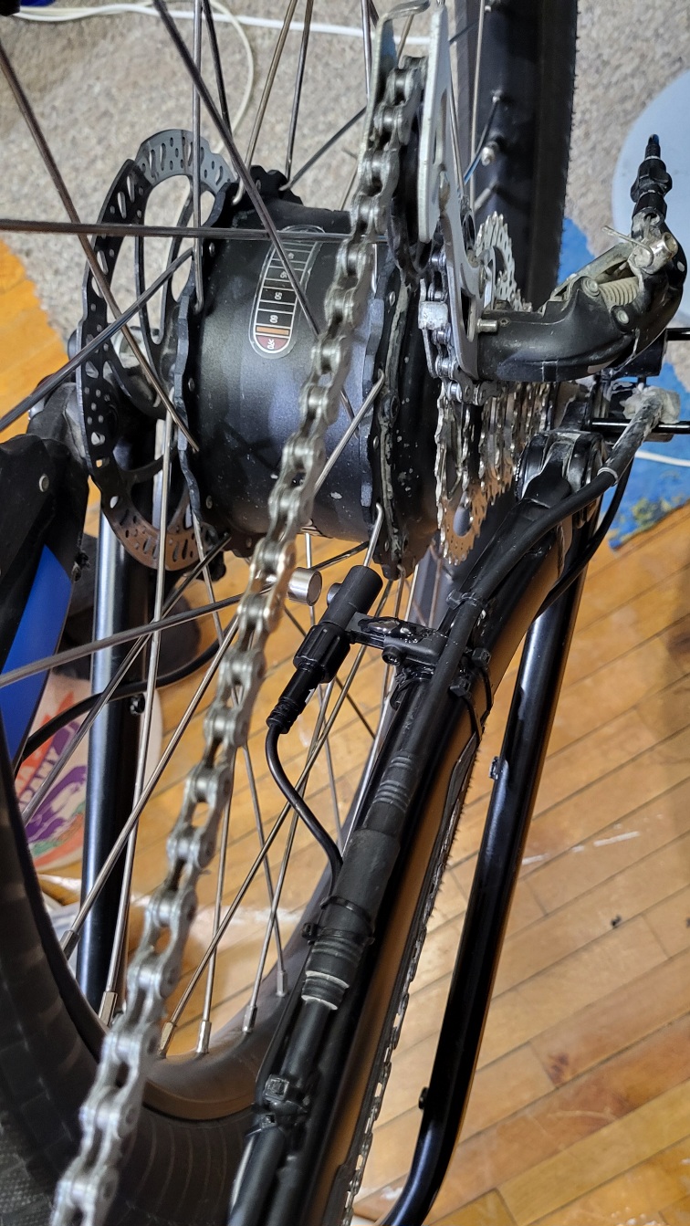

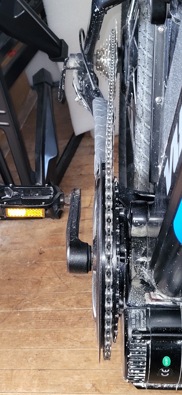

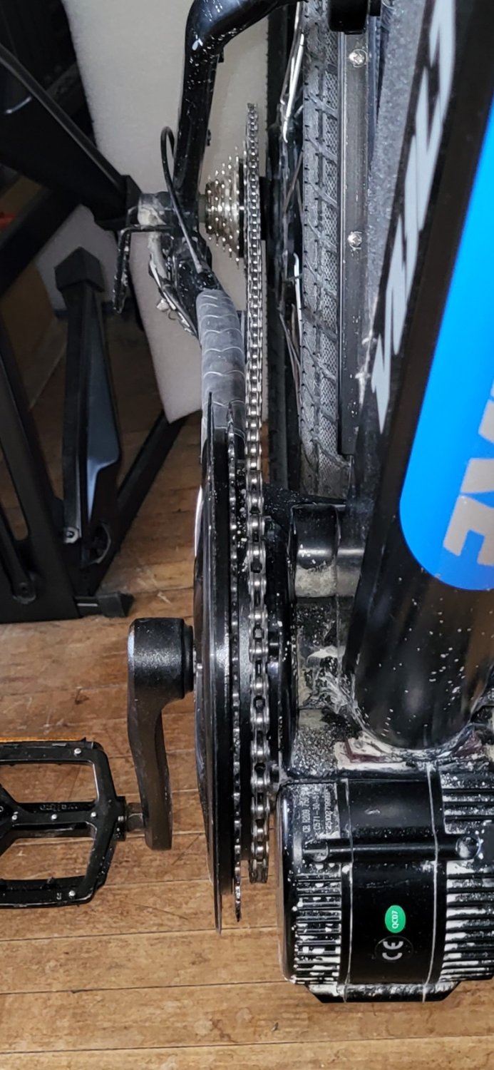

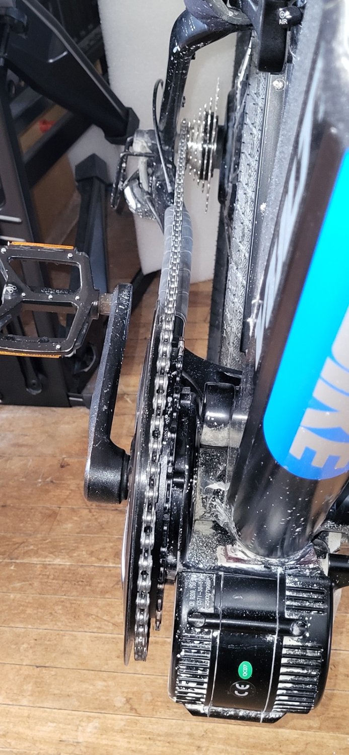

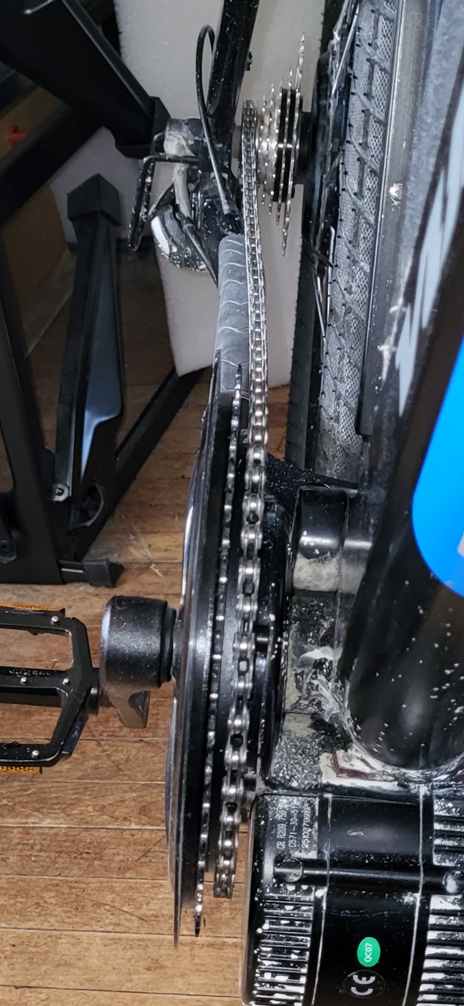

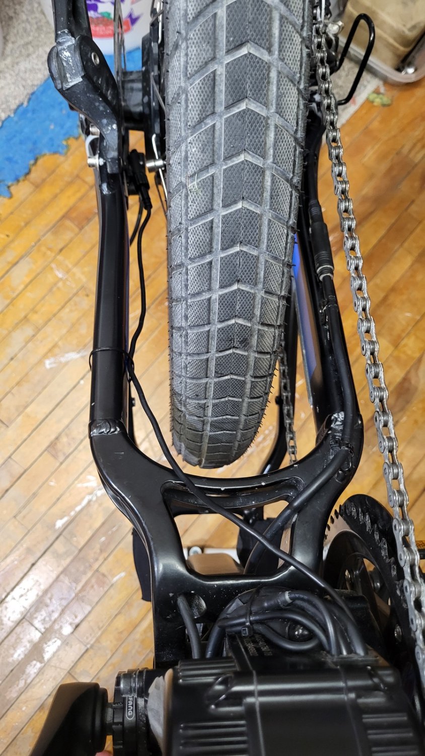

My longer crank bolts, washers, and lock washers arrived, so I got my 42t chainring installed,..
I didn't like how I had to remove the crank arm, and the chain guard to check my crank bolts, so I drilled holes through the guard so I can check them easily,..
It looks good and It's working fine.
I can even use top gear (7th gear on my freewheel) without the derailleur losing aĺl it's tension.
So,.. all my gears are working except 1st gear on my 52t chainring,..
These pictures sorta show my chain line, but my derailleur might be all bent outta shape? 😁
I'll see if I can get some topside pictures showing the chain line more accurately.
From those pictures, it looks fine to me, but the best way to check rear derailleur and hanger alignment is with the bike upright, with the rear derailleur in the center cog. Look at the derailleur and cassette from behind. These long cage rear derailleurs can have a bit of play in them. Don't be too concerned about the bottom pulley. It's mostly there to take up slack. The top pulley does all the shifting work. If the derailleur hanger is bent, and the top pulley is cocked vertically or twisted side to side, shifting will suffer.
If it looks good in the center cog, check again in the top and bottom cogs.

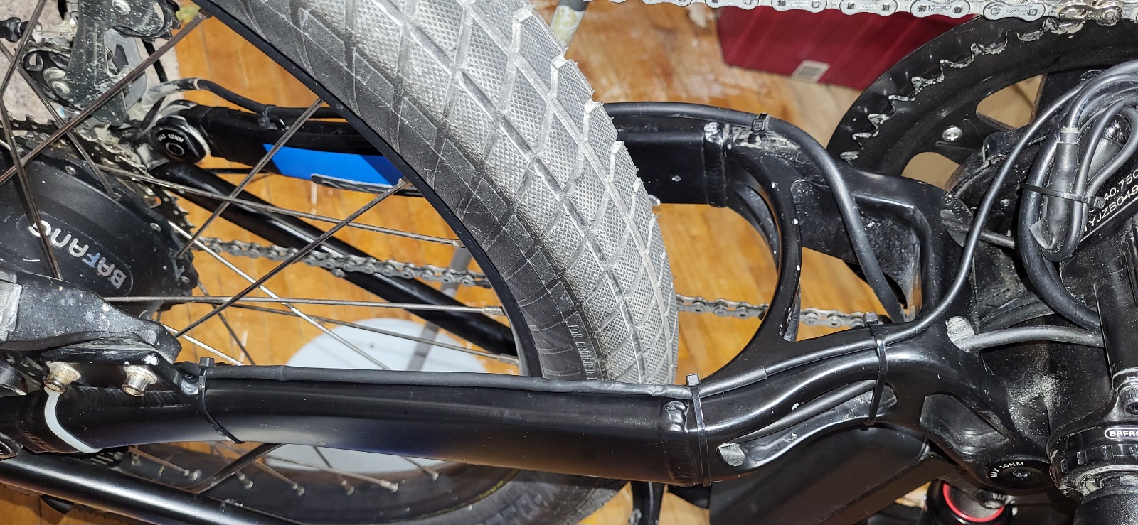

I took more pictures of the chain line, and it looks pretty good,..
The worse looking chain line was 7th gear on the 44t chainring.
It was also where the derailleur had the most chain slack to deal with, but I don't need to use high gear on my 44t chainring. (I'll just use my 52t chainring for higher speed)
I could get into all the gears (except 1st gear on my 52t chainring) without any derailleur clacking issues.
I did notice that if I pushed the shifter lever too hard (trying to climb out of 7th gear) I would stretch the shifter cable enough to throw my gear shifter off by one gear.
I just had to go through the gears again to get it back to normal.
I was shifting the gears one at a time while leaning the ebike over on the kickstand, and turning the crank by hand, so the derailleur couldn't move until I could rotate the pedal.
I suppose I could replace my shifter cable with something better, but I just need to keep it in mind, and not push the shifter lever too hard, and make sure that the chain is moving while I'm shifting.
I'll need to do a real world test and ride on some washboard gravel roads to see if I have any derailleur/chain issues.
I've been on all kinds of bumpy, washboard roads but my chain line has never been moving.
So I need to see how my derailleur and chain behave with them actually doing something 🤔 🙃

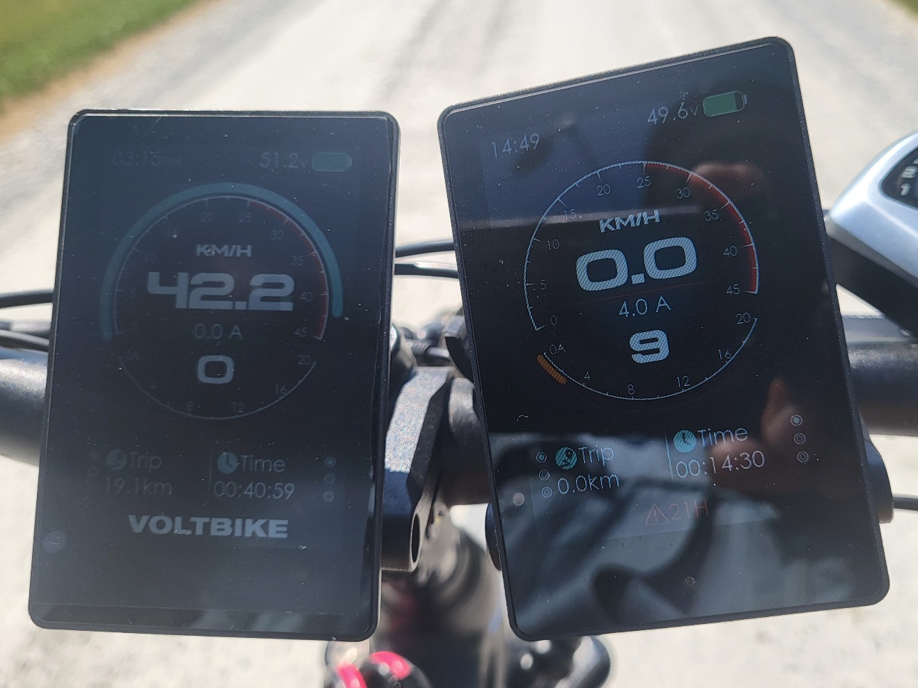

,.. So I needed to set my maximum speed to 40 kph so that 80% speed would be 32 kph to keep my controller happy.

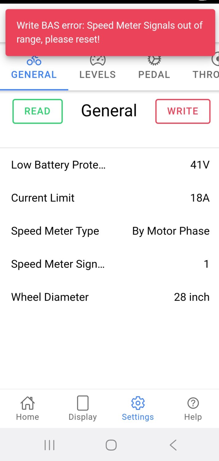

Well,.. I pissed off my display, and have been locked down to 25 kph.
(which is coincidentally the maximum speed limit in Europe)
I did a factory reset, and No Settings with the Speeed App will get my cruise control to go 32 kph.
Changing the wheel size changed the speedometer reading, but not the actual speed.
My Y-connector arrived and I got it connected.
It was off, but I thought I'd just fire it up and see what happens? 😁
I think something bad happened ?? 😁
A warning on the display popped up saying, "Short Circuit Detected !!", but then it carried on and powered up.
After that my ebike was completely locked down to 25 kph.
That no longer works.
I set my maximum amps up to 25, and set Everything back to normal, then did a factory reset and nothing changed !!??
I'm stuck at 25 kph??

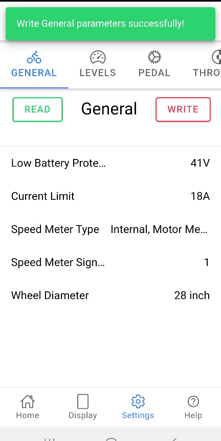

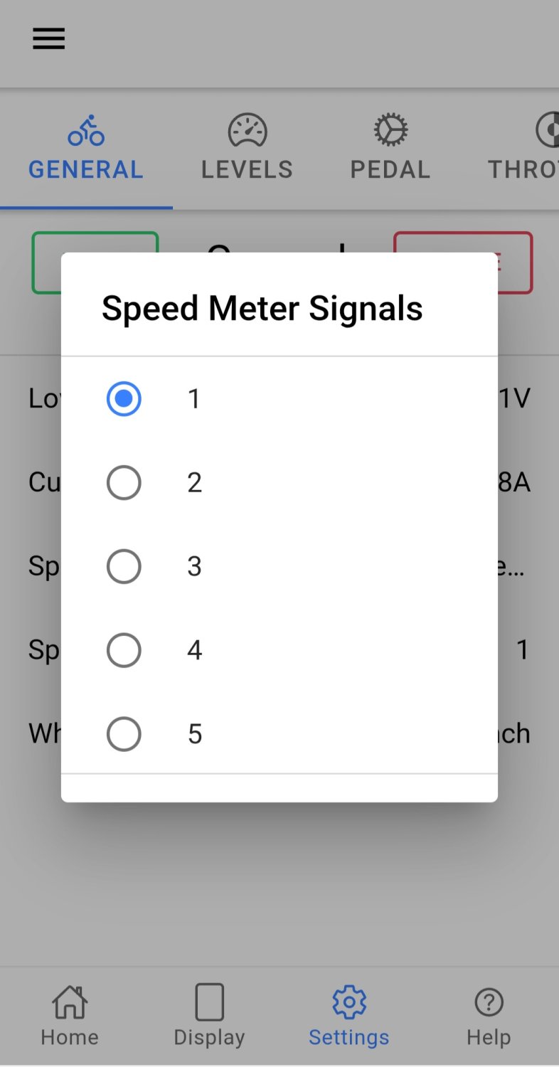

I thought I'd set the number of speed magnets to zero again to see what happens, but zero is no longer and option ??
Then I managed to set my speed meter type to "Internal, Motor Meter" which I wasn't allowed to do before,..
I'm still not allowed to choose "By Motor Phase".
That's the same as before.
That Got Er' Fixed.
Holy s*it !!@ 😅

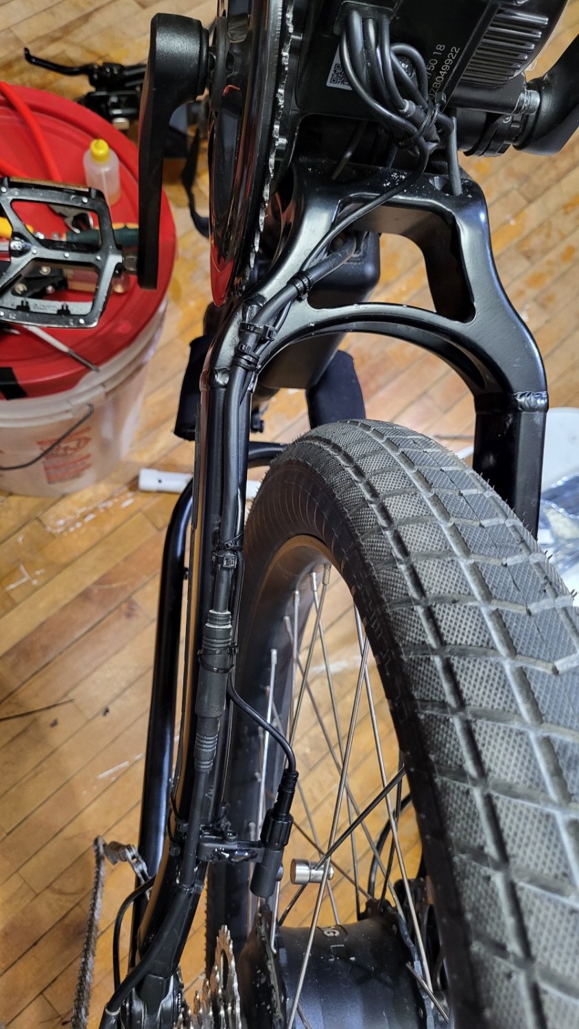

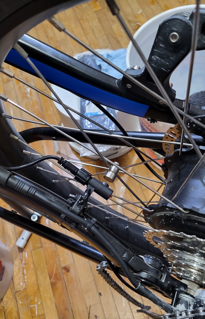

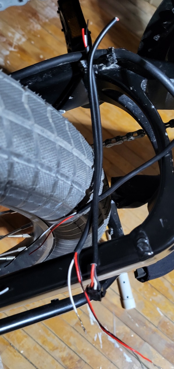

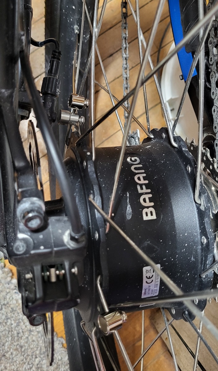

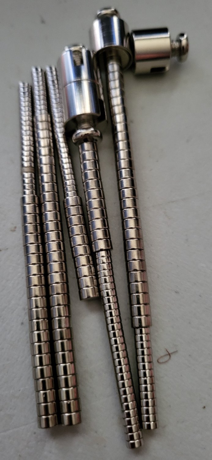

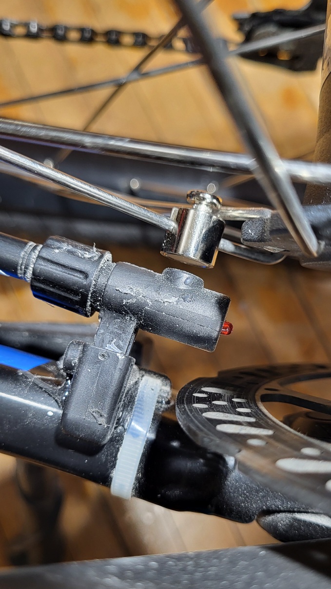

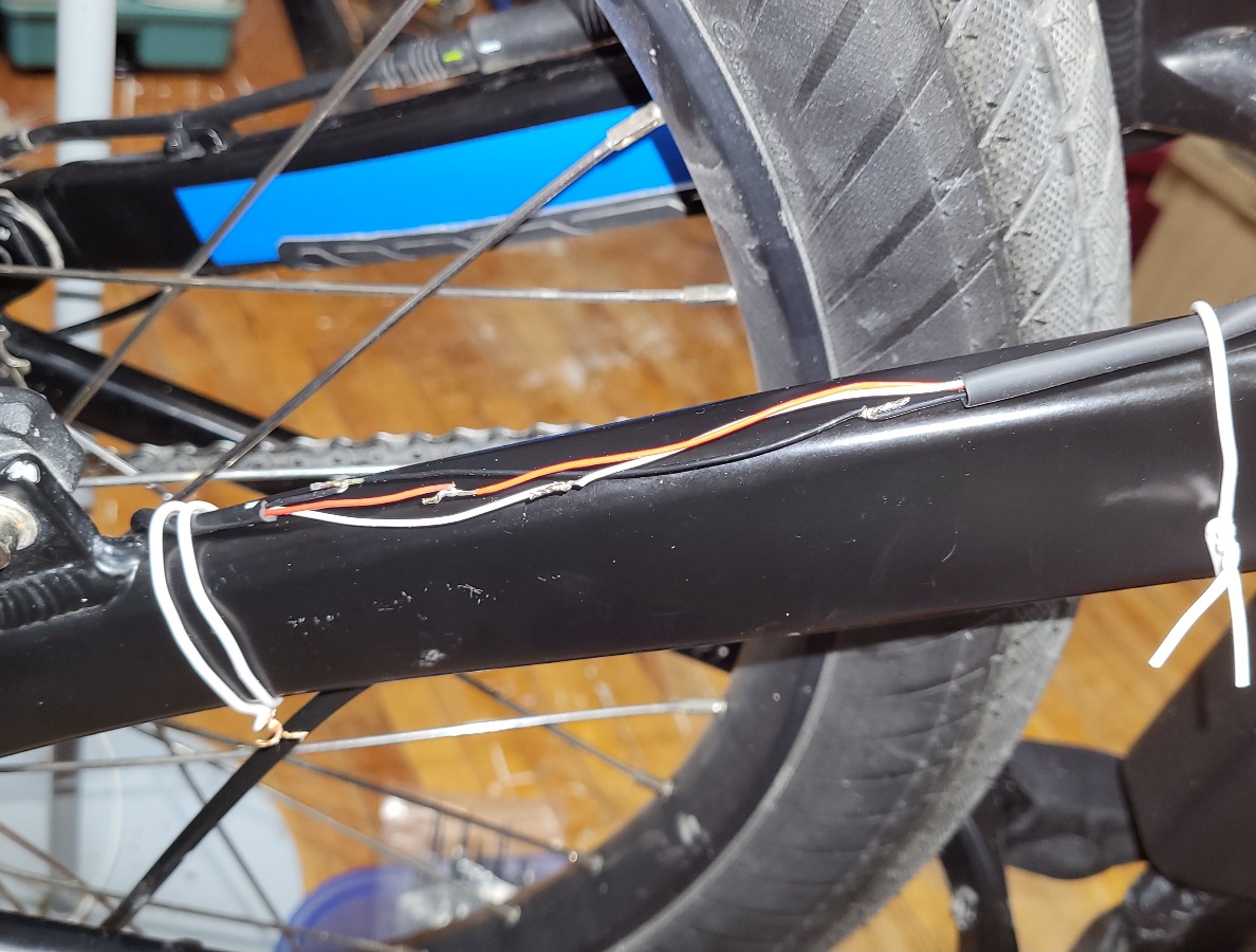

My speed 🧲's arrived today,..
Now to see if I can trick my ebike into knowing how fast it's going.
It seems to think it's going ~20 times slower than it is?🤔

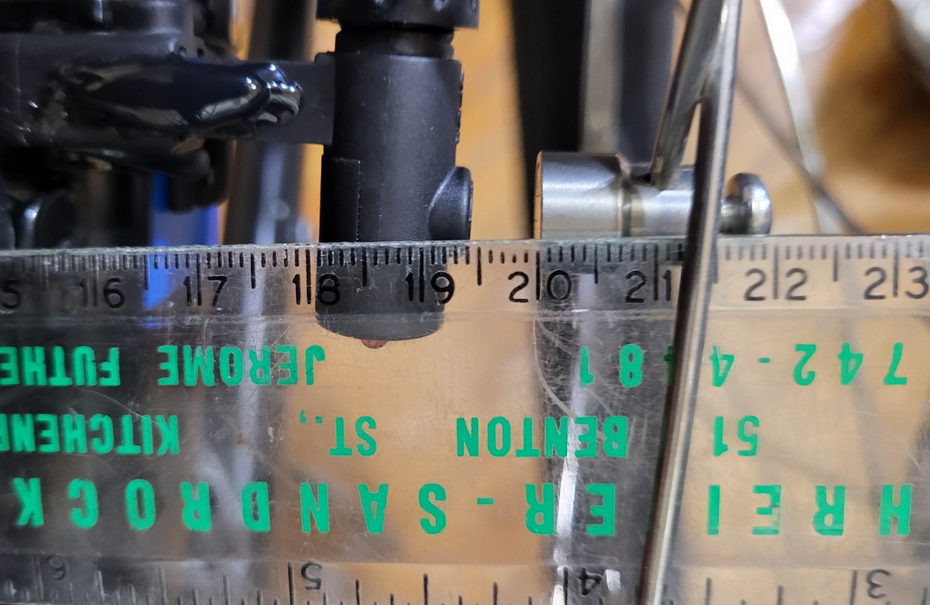

My new spoke 🧲's aren't as tall as the Bafang speed 🧲, so I had to install three new 🧲's,..

My speedometer is messed up Real Good. 😁
I don't know what's goin on ??
I got it to read close to the proper speed but it still kept wanting to go faster than 32 kph, and changing gears changed the maximum speed even with it set to "speed magnet"
Makes no damn sense.
I'm gunna have to take it for another test ride to see what happens under load.
If I can just use my PAS mode setting to turn the power up and down, then I'll just do that.
I don't need the speedometer anyway because I can use the speedometer from my hub drive, but it would be nice to not have to worry about going over 32.
